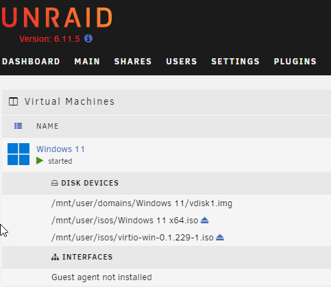

February 9, 20233 yr Having the same issue on 6.11.5, Dockers are all getting access to br0 no problem, but VMs can't get on the network and it just says guest agent not installed. This is a fresh install of unraid I am using to test out the software before deciding totally on going forward with it. Edited February 9, 20233 yr by Deadpool1985
February 9, 20233 yr 4 hours ago, Deadpool1985 said: Having the same issue on 6.11.5, Dockers are all getting access to br0 no problem, but VMs can't get on the network and it just says guest agent not installed. This is a fresh install of unraid I am using to test out the software before deciding totally on going forward with it. You have the virtio iso mounted, but did you install the package in the VM from it?

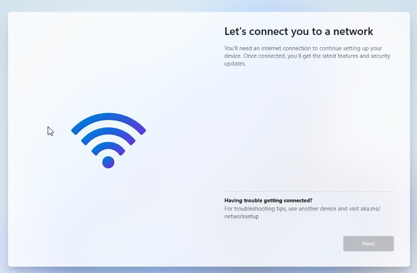

February 9, 20233 yr 7 hours ago, Kilrah said: You have the virtio iso mounted, but did you install the package in the VM from it? Looks like I should have tested with Win 10(I got that going), with Win 11 you can't get passed the initial install without a network connection.
February 9, 20233 yr 2 hours ago, Deadpool1985 said: Looks like I should have tested with Win 10(I got that going), with Win 11 you can't get passed the initial install without a network connection. Shift-F10, type OOBE\BYPASSNRO It'll reboot and allow bypassing the network/online account req.

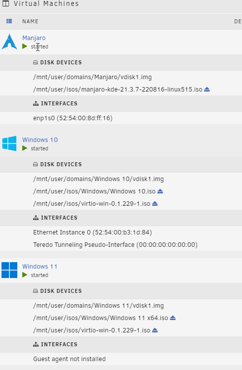

February 9, 20233 yr For some reason it only shows the interfaces for my Manjaro VM and not Windows...granted all 3 are working networking included but that looks to be a bug.
February 9, 20233 yr 41 minutes ago, Deadpool1985 said: For some reason it only shows the interfaces for my Manjaro VM and not Windows...granted all 3 are working networking included but that looks to be a bug. Have you installed the qemu guest agent on windows machine?

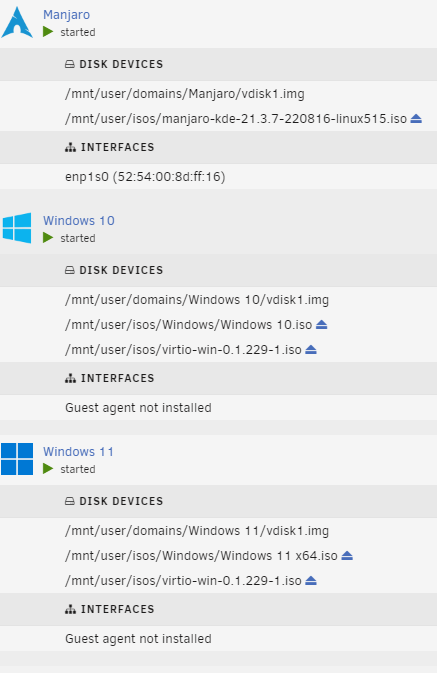

February 10, 20233 yr I did not have it installed, I do now. Looks good on Win 10 but not working on Win 11...but I really doubt I will be using those on this anyway these are just tests. But I did install it on Win10/11 and works on 10:
March 2, 20233 yr On 2/10/2023 at 11:53 AM, Deadpool1985 said: Looks good on Win 10 but not working on Win 11 Hi, I am having the same problem, it works on Windows 10, but not on Windows 11. Did you ever find a solution to get it working on Windows 11 as well? Thank you!

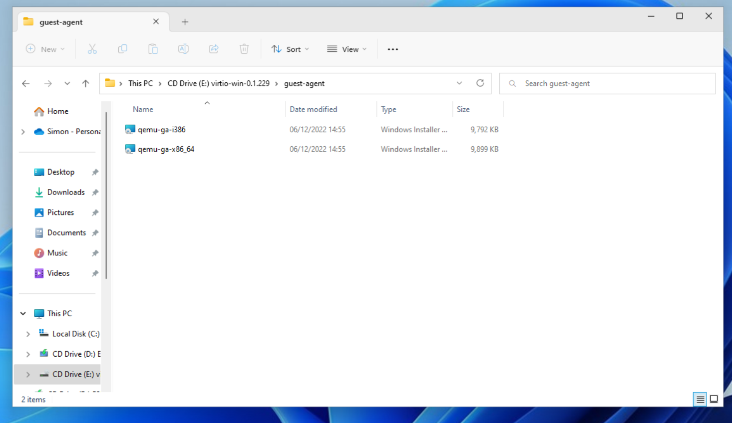

March 2, 20233 yr 5 hours ago, rousseau said: Hi, I am having the same problem, it works on Windows 10, but not on Windows 11. Did you ever find a solution to get it working on Windows 11 as well? Thank you! Have you loaded the qemu guest agent from the virtio CD?
March 2, 20233 yr 7 hours ago, SimonF said: Have you loaded the qemu guest agent from the virtio CD? Yes, I even did it a few times to make sure I hadn't mis-clicked. Also rebooted the VM to see if that would help, but still doesn't work.
September 2, 20242 yr I had the same issue. A fix for me was to copy the MSI to C:\Temp and install it from there.

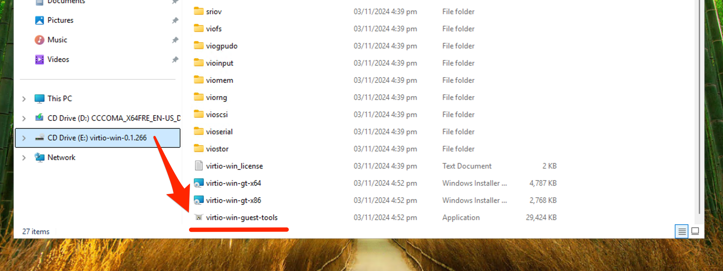

May 1, 20251 yr On 3/21/2025 at 10:20 AM, Kevin M said: Anyone in the future, this is what worked for me. Install the quest tools this worked for me too with a Windows 11 vm on Unraid 7
July 17, 20251 yr On 3/21/2025 at 6:20 PM, Kevin M said:Anyone in the future, this is what worked for me.Install the quest tools Thanks man! This is what fixed it for me in Windows 11 :)
