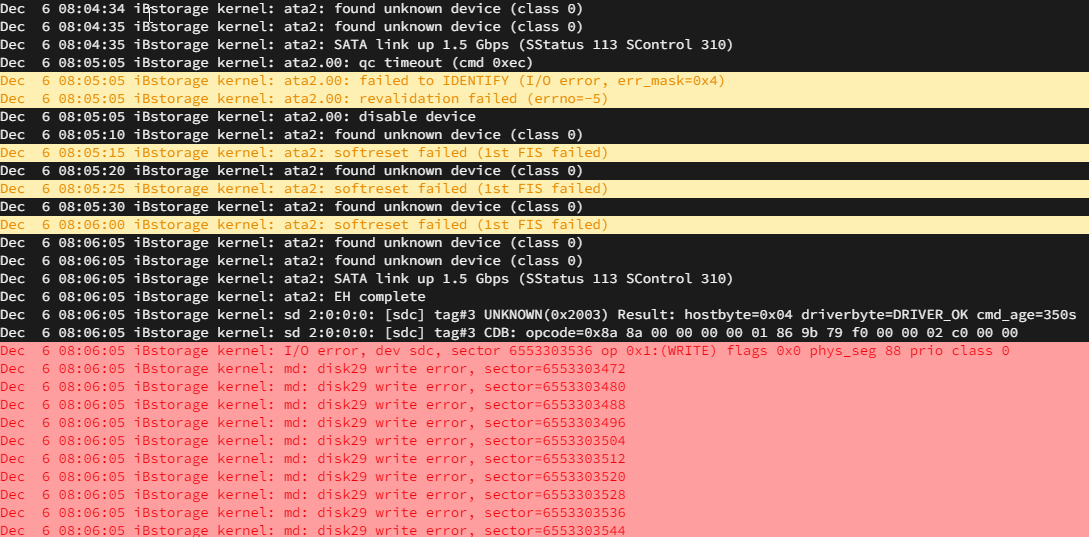

This morning one of my 2 parity drives was disabled after several errors in the syslog as you can see below:

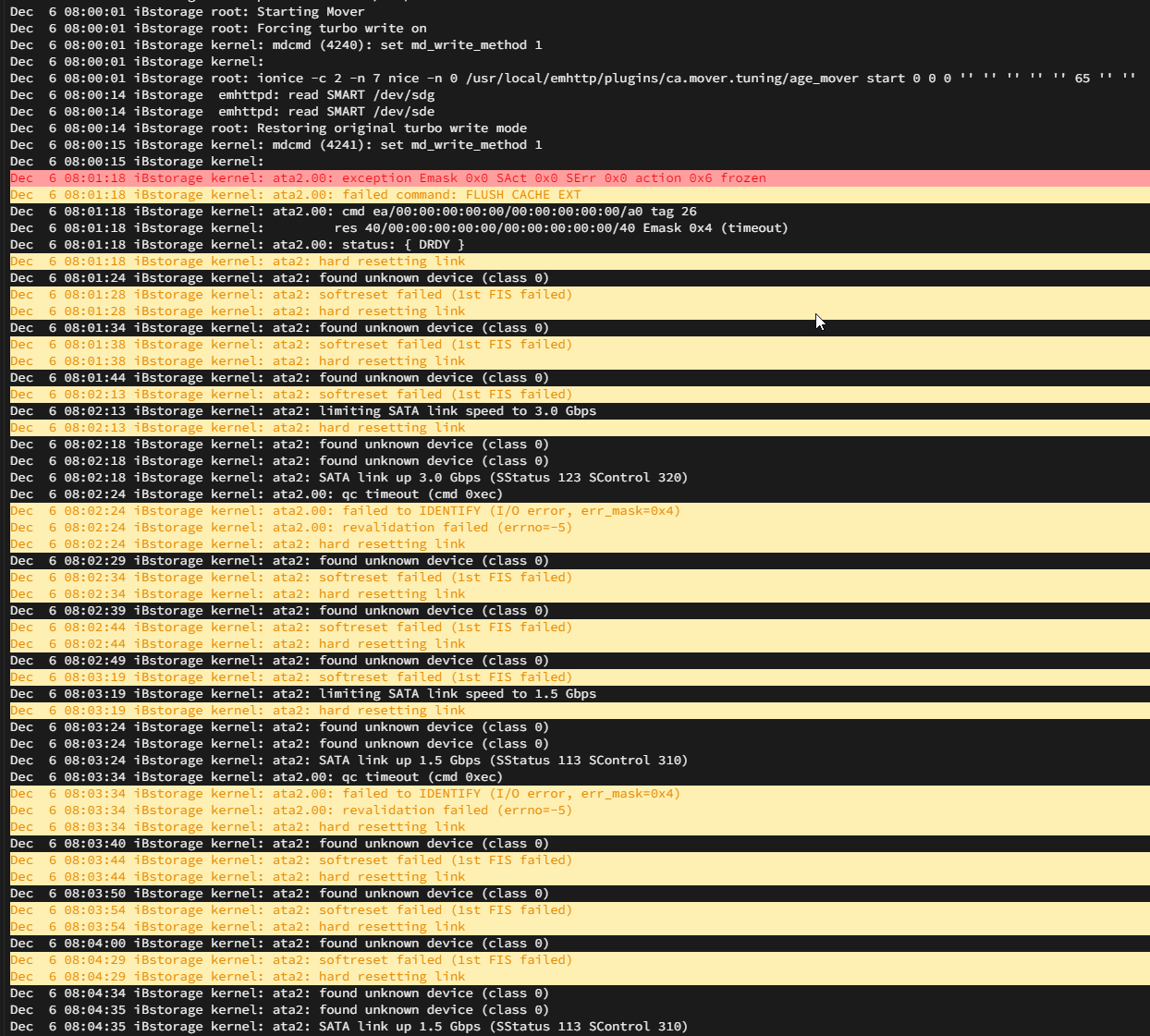

It appears this happened shortly after the mover was triggered:
Ultimately after warning for a bit it goes into full on write errors (1024 or so total before it disables the disk):
Syslog is also being spammed with this, even after the drive was disabled:

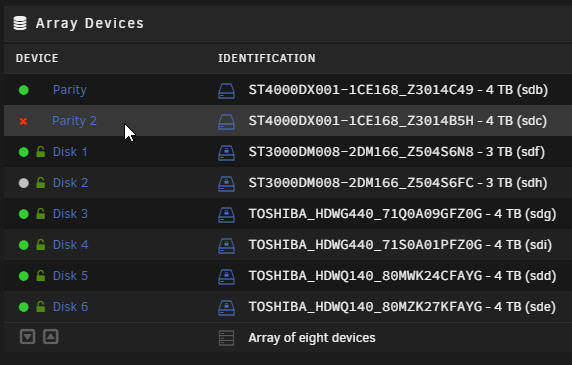

parity2 not connected. Check connections, SATA and power, both ends, including splitters. Then post new diagnostics

Parity2 has disconnected. Check connections, SATA and power, both ends, including splitters, to see if you can get Parity2 connected again. Can you see it in BIOS?
On 12/6/2022 at 1:03 PM, DaveDoesStuff said:
no possible way anything can be disturbed
Try another SATA cable. Try to avoid more than 4 disks on a power supply cable. If you must use splitters don't split SATA power connections, split Molex, crimped Molex not molded. Don't bundle data cables. Make sure all cables have plenty of slack so plug can sit squarely on the connector with no tension.
After you get parity2 connected again post new diagnostics.

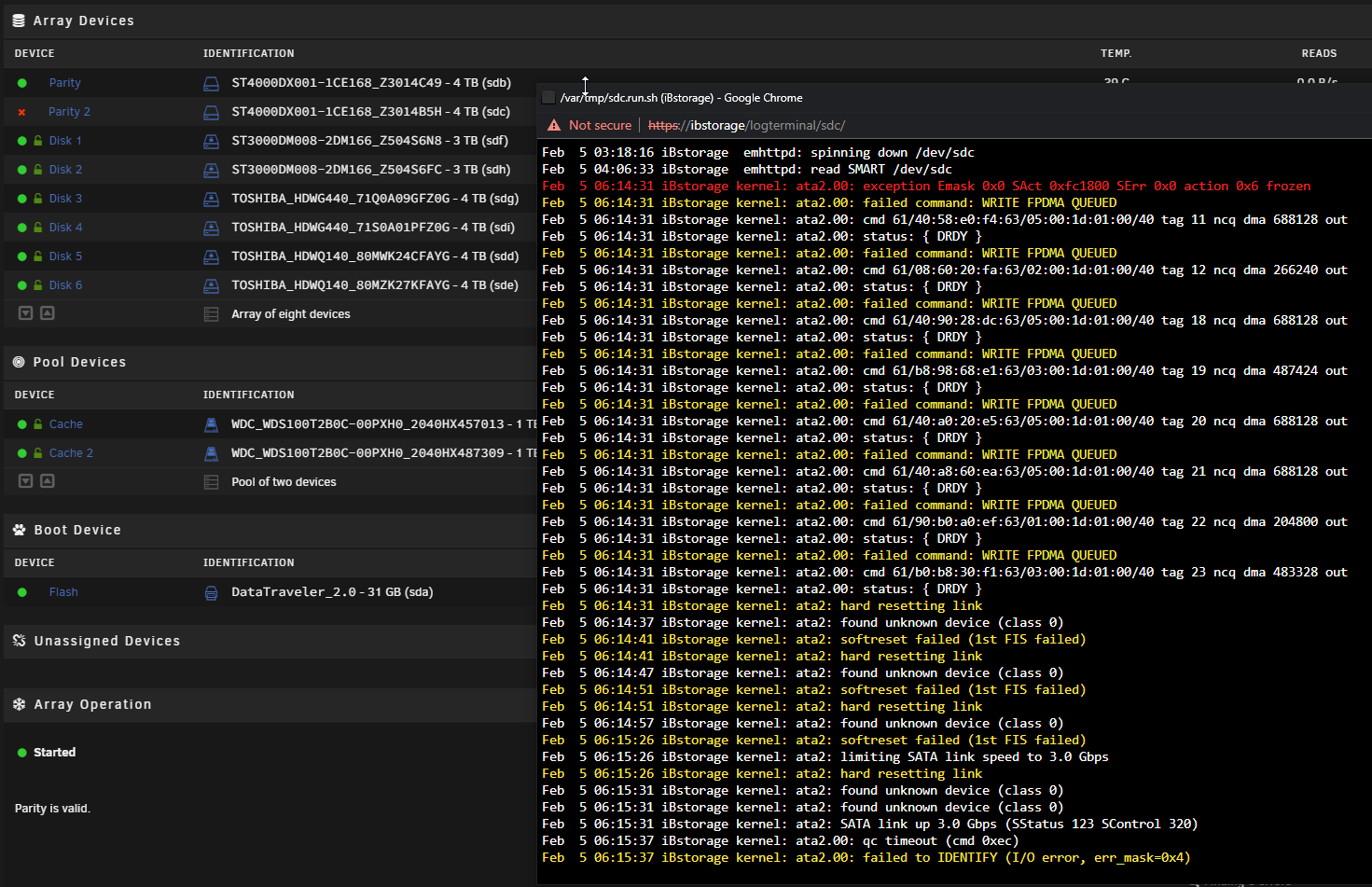

@trurlhappened again unfortunately:
1505391941_2023-02-0511_32_29-iBstorage_Main.thumb.png.37213d8144542f4af19b0fd376de1658.png
I'll try switching the SATA power cables around to see if a different drive goes offline. In the meantime I'll try and find some affordable drives to replace that one (at least as a test).

No SMART report for parity2 because it has disconnected.
