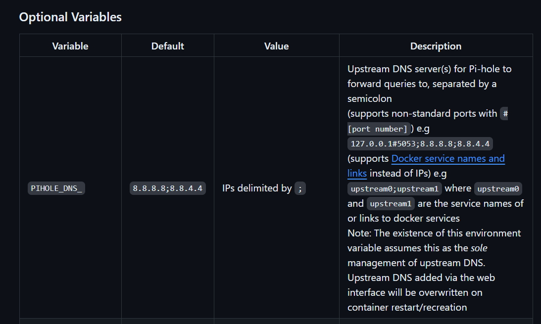

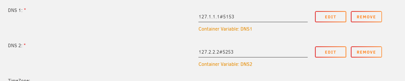

45 minutes ago, ZappyZap said:
Pihole container do not use  DNS1 and DNS2 anymore  but
PIHOLE_DNS_
https://github.com/pi-hole/docker-pi-hole
? I saw that in the logs of the docker and follow the offical pihole project. its added to the dns records "host file in the docker":
the dns 1 and 2 temple fills the webui custom ip option:
I'm not using pihole as a dhcp server.
Edited by bmartino1
spelling

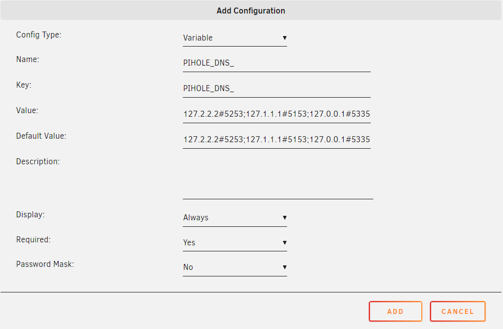

a fresh download of your unraid template still has that option.
So I should edit the template and add environment variable
PIHOLE_DNS_ with options 127.2.2.2#5253;127.1.1.1#5153;127.0.0.1#5335
Edited by bmartino1
confrim tempate add
Doh....
i was sure i update it ....
damn , will be done tomorrow
Thanks to found out
18 hours ago, ZappyZap said:
Doh....
Thanks to found out
 per the log with the dns 1 and dns 2 templates. It appears that pihole is making that record and using that variable:
 [i] Converting DNS1 to PIHOLE_DNS_
  [i] Converting DNS2 to PIHOLE_DNS_
  [i] Setting DNS servers based on PIHOLE_DNS_ variable
I'm not very concerned about it. It up and working as it should.

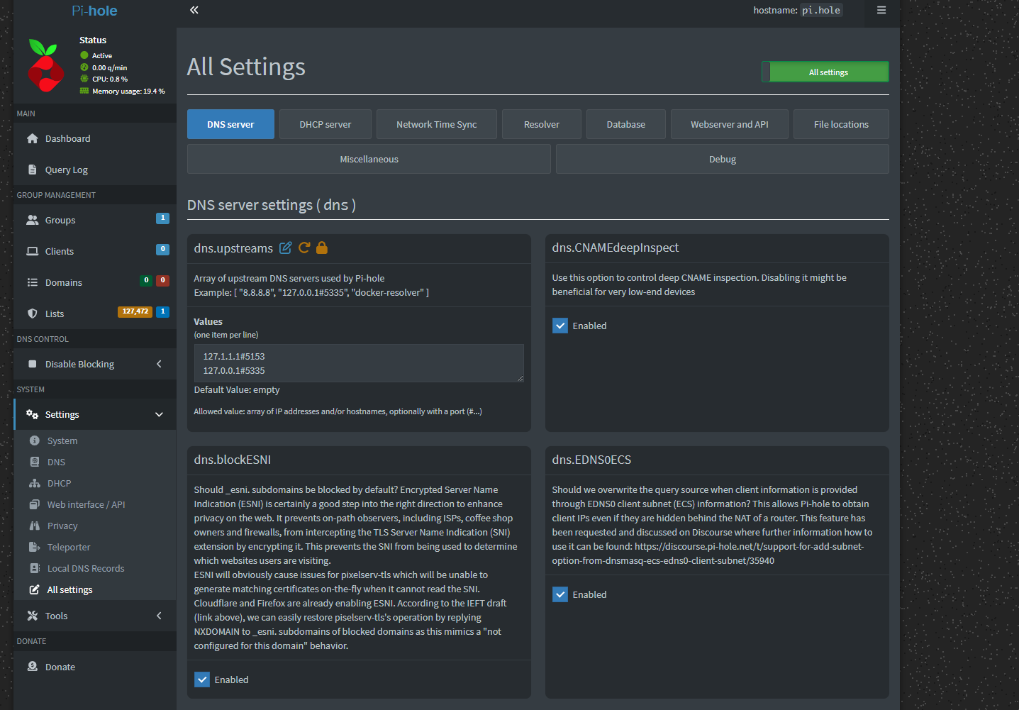

@bmartino1
here is a dev container with v6 / unbound and cloudflared
devzwf/pihole-dot-doh:2025.02.4-v6dev
of course you need to adjust some env du to V6
here is a testing compose....
i will create  a new template :
services:
  pihole:
    container_name: pihole_v6
    image: devzwf/pihole-dot-doh:2025.02.4-v6dev
    ports:
      # DNS Ports
      - "53:53/tcp"
      - "53:53/udp"
      # Default HTTP Port
      - "80:80/tcp"
      # Default HTTPs Port. FTL will generate a self-signed certificate
      - "443:443/tcp"
      # Uncomment the below if using Pi-hole as your DHCP Server
      #- "67:67/udp"
    environment:
      # Set the appropriate timezone for your location (https://en.wikipedia.org/wiki/List_of_tz_database_time_zones), e.g:
      TZ: 'America/Toronto'
      # Set a password to access the web interface. Not setting one will result in a random password being assigned
      FTLCONF_webserver_api_password: '<WEB_PASSWORD>'
      # DoT : unbound (127.0.0.1#5335) DoH: cloudflared (127.1.1.1#5153)
      FTLCONF_dns_upstreams: '127.1.1.1#5153;127.0.0.1#5335'
      FTLCONF_dns_listeningMode: 'all'
    # Volumes store your data between container upgrades
    volumes:
      # For persisting Pi-hole's databases and common configuration file
      - './etc-pihole:/etc/pihole'
      # Uncomment the below if you have custom dnsmasq config files that you want to persist. Not needed for most.
      - './etc-dnsmasq.d:/etc/dnsmasq.d'
      - './config/:/config'
    #cap_add:
      # See https://github.com/pi-hole/docker-pi-hole#note-on-capabilities
      # Required if you are using Pi-hole as your DHCP server, else not needed
      #- NET_ADMIN
    restart: unless-stopped
let me know

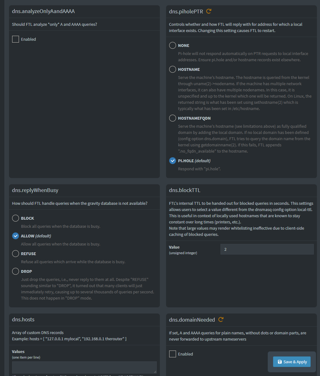

From what i'm seeing. some small tweaks to the compse template
added hostname pi.hole
added custom docker network using unraids defualt br0
full mapped default location for unraid default appdata path to continer for volumes.
--add unraids docker compse specails to fix ui stack icon and web ui link pulled form previous docker
The hostname unless changed, should be pi.hole using default pihole configuration per ptr:
other then that, this seems stable and is working.

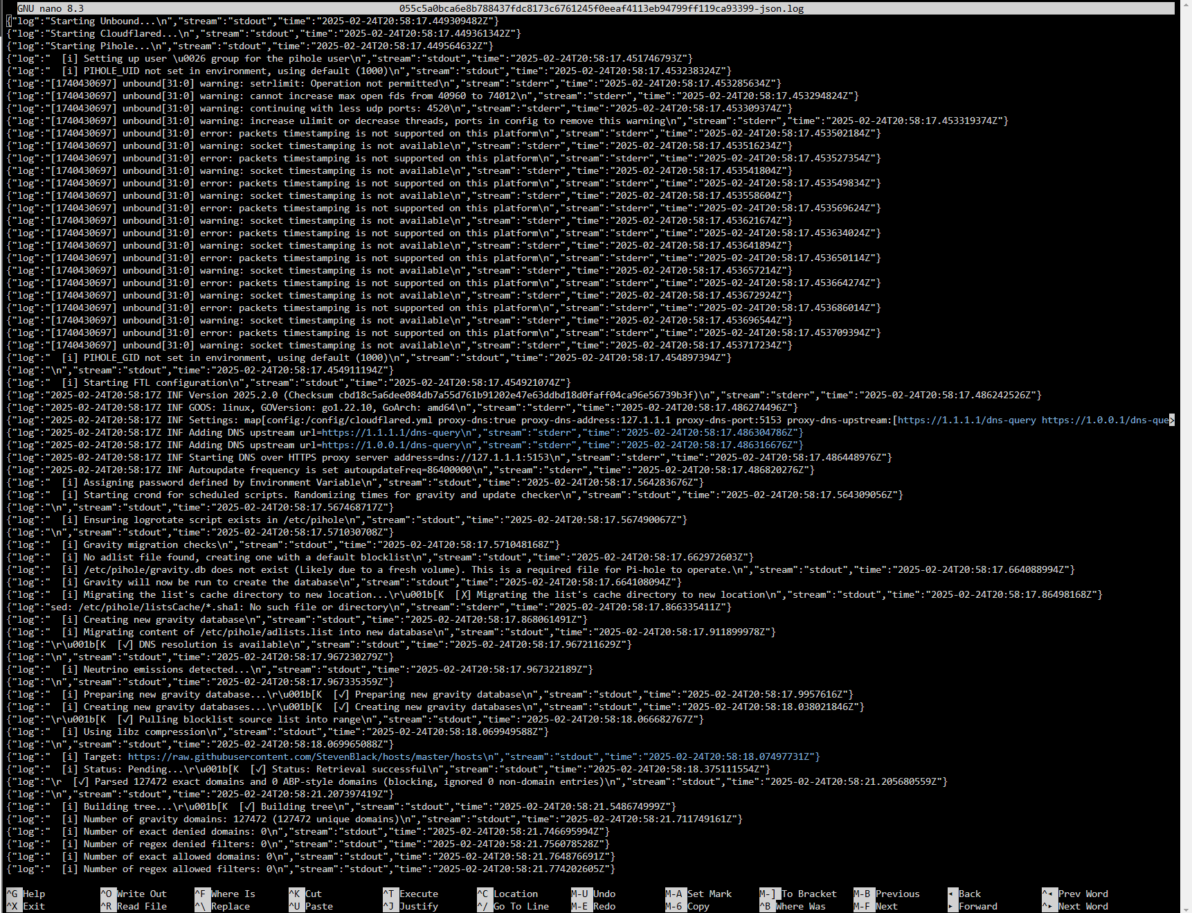

log.txt

Hey everyone!
I just updated from devzwfpihole logs.txt/pihole-dot-doh:latest to devzwf/pihole-dot-doh:2025.02.6-v6dev  and so far I have not had any issues!! Thank you so much
Ive attached the logs during the upgrade since I did notice this and wanted to point it out
WARNING: Insufficient permissions to set process priority to -10 (CAP_SYS_NICE required), process priority remains at 0

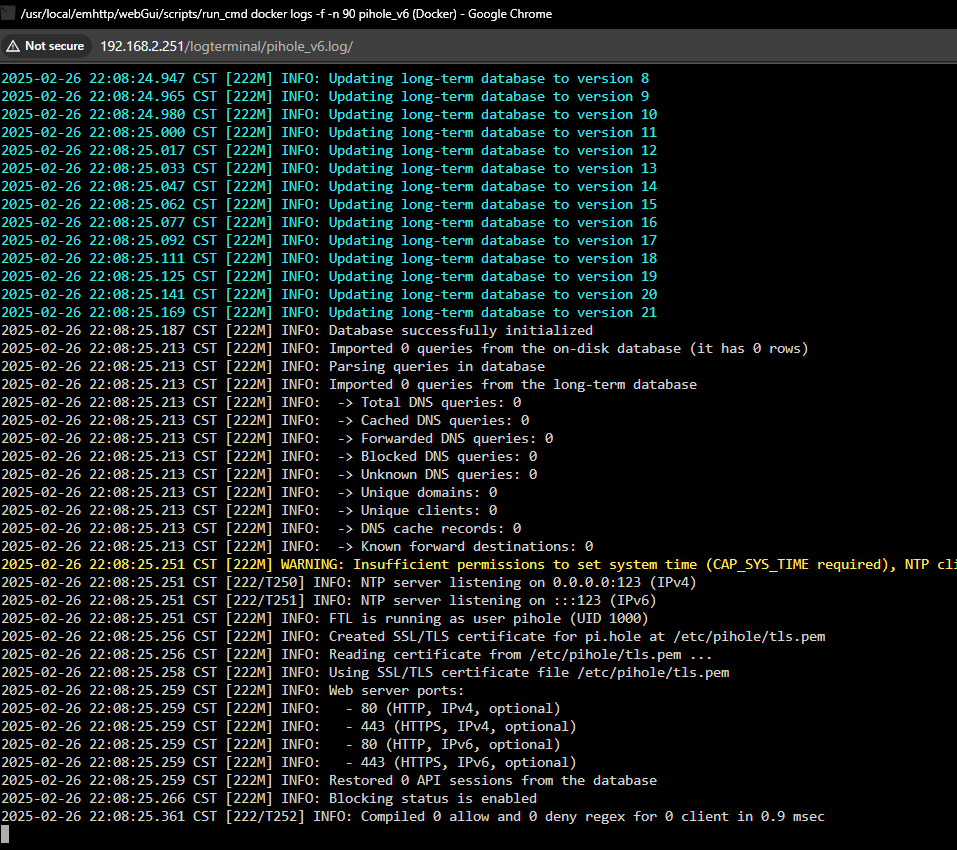

27 minutes ago, Nivek099 said:
Hey everyone!
that's correct
you can add this
--cap-add=CAP_SYS_NICE
in  Extra Parameters field
if you want

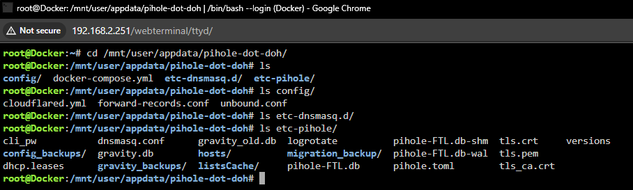

so I hit my first bug with the compose. as the dnsmasq.d folder is empty, usually there is a pihole.conf and a rfc###.conf, i usual also add the unbound edns.conf per piehole config form memory cache values.
Apparently,
When I stopped the docker and rebooted the host machine, unraid. The docker refused to start, its runs/composes up, but no web ui and nothing in the logs. I will attempt to recreate and reproduce the bug on another system.
Before the reboot, I had no issues with the dns and pihole instance. The act of making the dnsmasq.d volume may have deleted the files it started and ran with and never created the defaults when mapped.
*(Made empty folder adn volume mounted full paths all epty when first ran log above...)
I usually have 2-3 custom dnsmasq files for other dns assistance (more for this domain go to this dns server), I run with when I run pihole.... More to fix work realted dns queries. But it seems like losing the files in the volume mapping to dnsmasq.d is not a deal breaker, for me... As I can file 1 by 1 replace and add to the containers to workaround and fix that.
Meanwhile, I did test the dhcp server side as well, small hicups(more unfi rouge dhcp detection), but form what i could tell, I was able to use pihole dhcp without issues. I ran with both --cap-adds I used sys_nice and net admin that was commented out...
other then that, from what I can tell, this has been stable and is working.

Deleted the appdata folder contents so everything empty, delete the docker image. and used the above compose file commenting out the dnsmasq volume as it may be problematic.
Pihole appears to be working once more. Couldn't login to web ui. Will test latter tomorrow.
Edited by bmartino1
Data
here what doc saiid about the dnsmasq dir :
# Uncomment the below if you have custom dnsmasq config files that you want to persist. Not needed for most starting fresh with Pi-hole v6. If you're upgrading from v5 you and have used this directory before, you should keep it enabled for the first v6 container start to allow for a complete migration. It can be removed afterwards. Needs environment variable FTLCONF_misc_etc_dnsmasq_d: 'true'
FTL will attempt to bind to port 80 for plain HTTP. If it cannot bind to this port, it will fallback to port 8080 (So you might need to access the web interface at http://pi.hole:8080/admin)
sorry. I ahve n't had a change to retest do to other life obligation. I will be MIA tomorrow and the 9 - 15th. I will test what I can today with theses cahgens AS I was tryign to telport and move some ftl options.
had a issue with configs on reboot:
compose would show a red error for issues. webui useless for logs at compose / docker windows opens then breaks...
root@Docker:/mnt/user/appdata/containers/e5a56d4929cd7e36c8adb129e17bf732436fe84d8cadec9fb9c67a15516ee36a# cat e5a56d4929cd7e36c8adb129e17bf732436fe84d8cadec9fb9c67a15516ee36a-json.log
{"log":"cp: not replacing '/config/cloudflared.yml'\n","stream":"stderr","time":"2025-03-01T20:03:37.488032304Z"}
{"log":"cp: not replacing '/config/cloudflared.yml'\n","stream":"stderr","time":"2025-03-01T20:03:37.887031844Z"}
{"log":"cp: not replacing '/config/cloudflared.yml'\n","stream":"stderr","time":"2025-03-01T20:03:38.360369605Z"}
{"log":"cp: not replacing '/config/cloudflared.yml'\n","stream":"stderr","time":"2025-03-01T20:03:39.055174877Z"}
{"log":"cp: not replacing '/config/cloudflared.yml'\n","stream":"stderr","time":"2025-03-01T20:03:40.132958005Z"}
{"log":"cp: not replacing '/config/cloudflared.yml'\n","stream":"stderr","time":"2025-03-01T20:03:42.017236875Z"}
{"log":"cp: not replacing '/config/cloudflared.yml'\n","stream":"stderr","time":"2025-03-01T20:03:45.502544317Z"}
{"log":"cp: not replacing '/config/cloudflared.yml'\n","stream":"stderr","time":"2025-03-01T20:03:52.209568027Z"}
{"log":"cp: not replacing '/config/cloudflared.yml'\n","stream":"stderr","time":"2025-03-01T20:04:05.302360041Z"}
{"log":"cp: not replacing '/config/cloudflared.yml'\n","stream":"stderr","time":"2025-03-01T20:04:31.187338507Z"}
If I restart the docker, I will need to delete the config files in the config folder toe get it back up...
Deleted the config contents and then the docker started...
You may need a similar script and pull from your github for theses files:
example:
https://github.com/bmartino1/clamav-alpine/blob/master/build/check_files.sh
Since its a cop command to form the temp staging area into compose, this is easily solvable for a work around using user scripts... Bring to your attention. the pihole v6 has a issue with the copy files into the config folder...
Edited by bmartino1
typo - Data
updated fix for the enty script to check if exisit then copy:
#!/bin/sh
set -e  # Exit on error
# Ensure script has execution permission
chmod 755 /temp/unbound.sh
# Execute unbound.sh
/temp/unbound.sh
# Ensure config directory exists
mkdir -p /config/
# Check and copy config files if they do not exist in /config
[ ! -f /config/cloudflared.yml ] && cp /temp/cloudflared.yml /config/
[ ! -f /config/unbound.conf ] && cp /temp/unbound.conf /config/
[ ! -f /config/forward-records.conf ] && cp /temp/forward-records.conf /config/
# Start Unbound in the foreground
echo "Starting Unbound..."
/usr/local/sbin/unbound -d -p -c /config/unbound.conf &
# Start Cloudflared
echo "Starting Cloudflared..."
/usr/local/bin/cloudflared --config /config/cloudflared.yml &
# Start Pi-hole
echo "Starting Pihole..."
/usr/bin/start.sh
current compose file:

    environment:
    #pihole gid defualting set to 1000 was there a varble for this?
      TZ: "America/Chicago"
      FTLCONF_webserver_api_password: "test"
      # DoT: unbound (127.0.0.1#5335), DoH: cloudflared (127.1.1.1#5153)
      FTLCONF_dns_upstreams: "127.1.1.1#5153;127.0.0.1#5335"
      FTLCONF_dns_listeningMode: "all"
      FTLCONF_misc_etc_dnsmasq_d: 'true' #needed if maping
