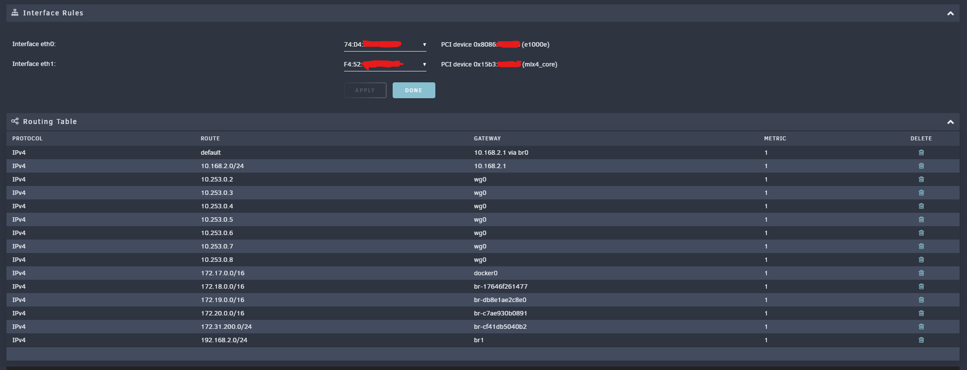

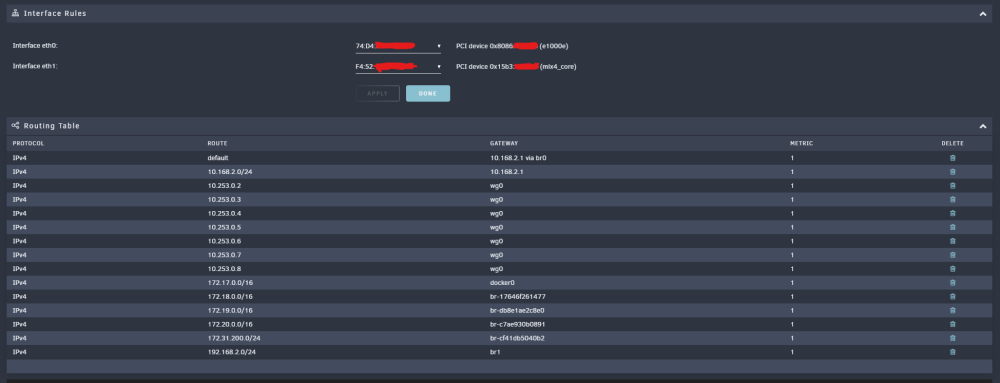

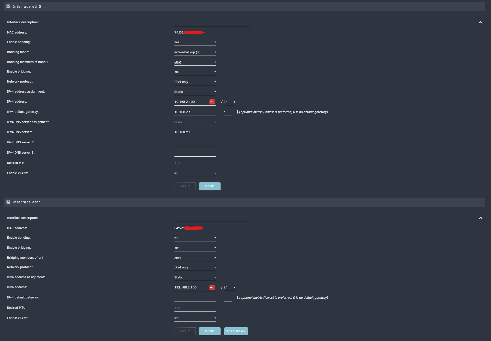

This is how I have configured my network:

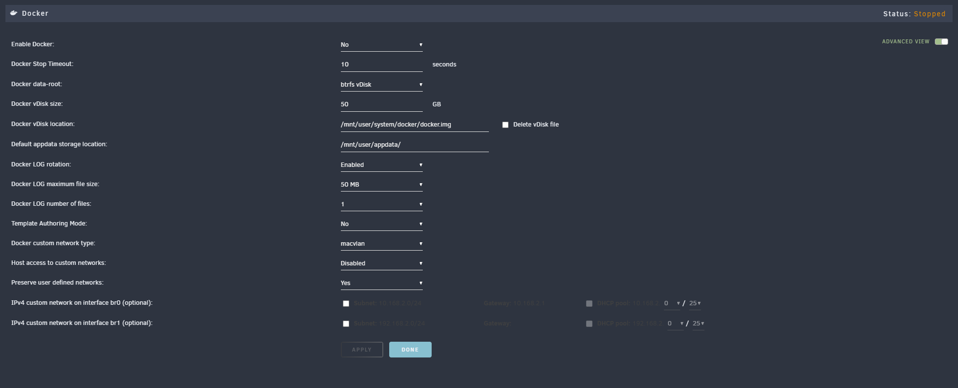

And this is the docker settings:

Try disabling the bridge for eth1, if it doesn't help try deleting/renaming /boot/config/network.cfg and then reconfigure the settings.

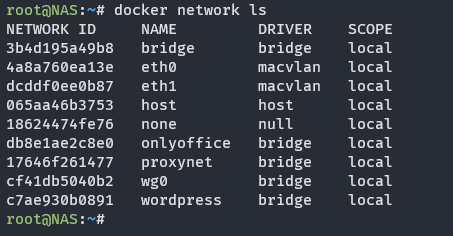

Are you using any custom docker networks?
Yes I have several custom networks
Should I remove all of them and reset them?

That's were I would start.
P.S. when recreating them use ipvlan instead, for other possible issues.

I has worked!, I tried removing all the unused custom networks and it was still failing, but once I removed the one in use (in my case proxynet) it has started working again.
It's a bit weird since I have not touch this custom network in a while. I'll try to reconfigure it again and if it fails at least I know where to look at.
I've also set the ipvlan, I've seen that it's the default since 6.11.5
