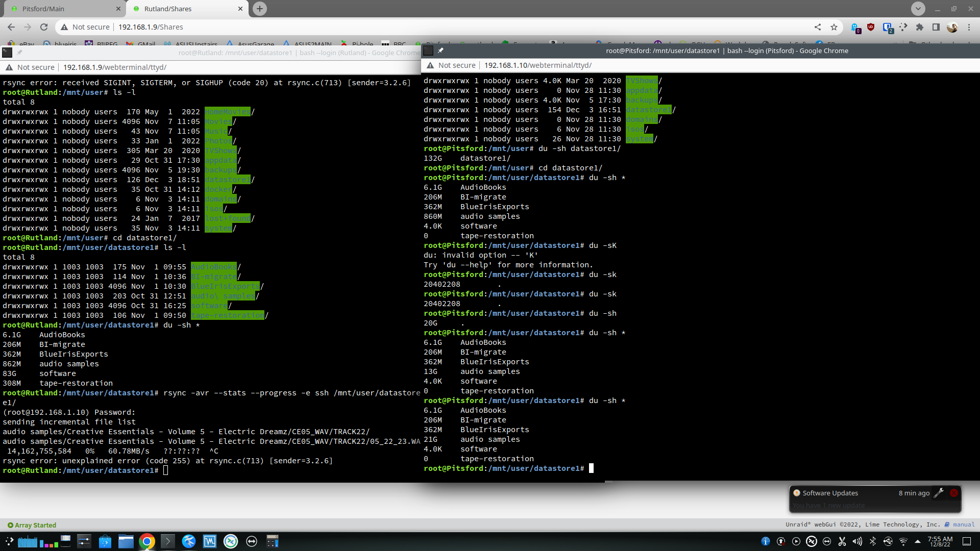

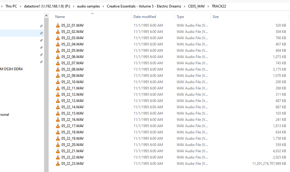

I'm using rsync to sync data from one unraid server to another, all was going well, but then I noticed (by chance) that one of the small .wav it was trying to copy was now "seen" as 11GB in size when in fact it's 1.59MB.

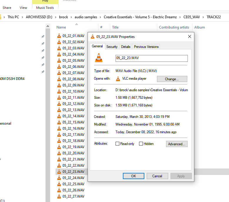

I have 3 copies for this wav file, on my local PC it's 1.59MB, browsing the share from this PC to the first unraid  server it reports the same file as 11,201,274,707,969KB.
The wav file is named 05_22_23.wav - see screenshots.

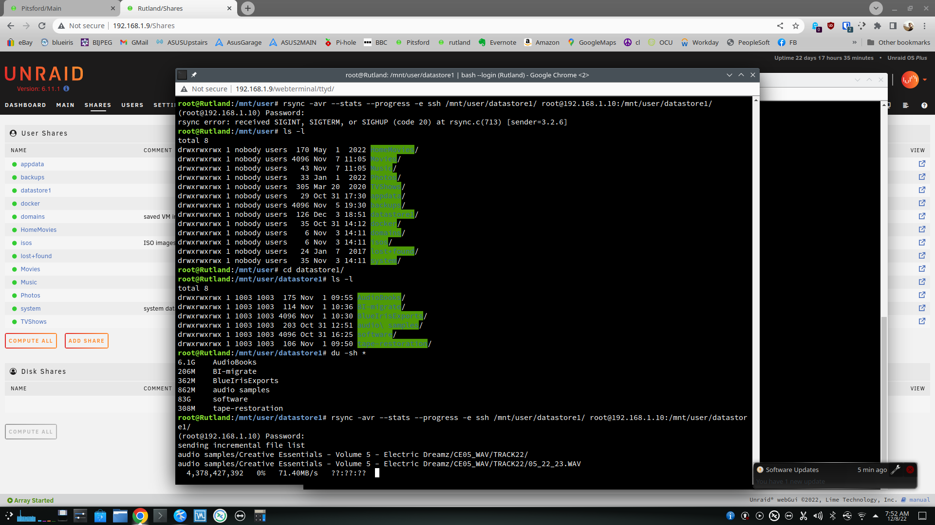

In the dual console screenshot you can see the directory in which this file is in changed, the directory named "audio samples" is 868MB in total, I confirmed this by looking at the local PC copy. But doing another du later gives a different result, it's 21GB in size, so I assume it trying to copy a file that is 11,201,274,707,969KB - TBH, I'm very confused at this.
Also, when rsync got to this file you can see that it outputs "??:??:??".
