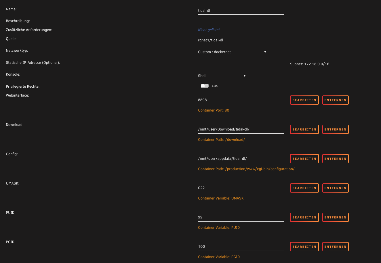

May 12, 20233 yr Okay, I have now created a Docker template that runs Tidal-dl. However, I can only set the quality, login and download via the console of the Docker container using the tidal-dl command. A nice graphical gui would be much better, of course. Here is my Docker template. The setting for config is not needed Edited May 12, 20233 yr by Rockikone

May 18, 20233 yr On 5/12/2023 at 1:16 PM, Rockikone said: Okay, I have now created a Docker template that runs Tidal-dl. However, I can only set the quality, login and download via the console of the Docker container using the tidal-dl command. A nice graphical gui would be much better, of course. Here is my Docker template. The setting for config is not needed Thanks for making this up. It actually works. `Gui` is just perfect. Simple one button. done. Needed to restart couple of time cause it just refused to create .json files. Possibly tidal was active somewhere else. The only downside is that the files downloaded are created with some very weird permissions: -rw-r--r-- 1 sshd sshd 23M May 18 01:24 vs typical one for unraid -rw-rw-rw- 1 nobody users 2.5K May 18 01:26 ../ Any suggestions how to change this? Edited May 18, 20233 yr by BeersTeddy

May 21, 20233 yr Author In my case webUI download is not working. I am loading the links to the left window but once I hit submit button, nothing happens. Download via console command "tidal-dl -l https://listen.tidal.com/album/some_album" works as expected. What I have also found is the container is not saving the settings upon restart so everytime I restart I need to go through all the settings again, Api keys, quality, etc. There is nothing in config folder in my apps data. All container settings are as per the instructions.
