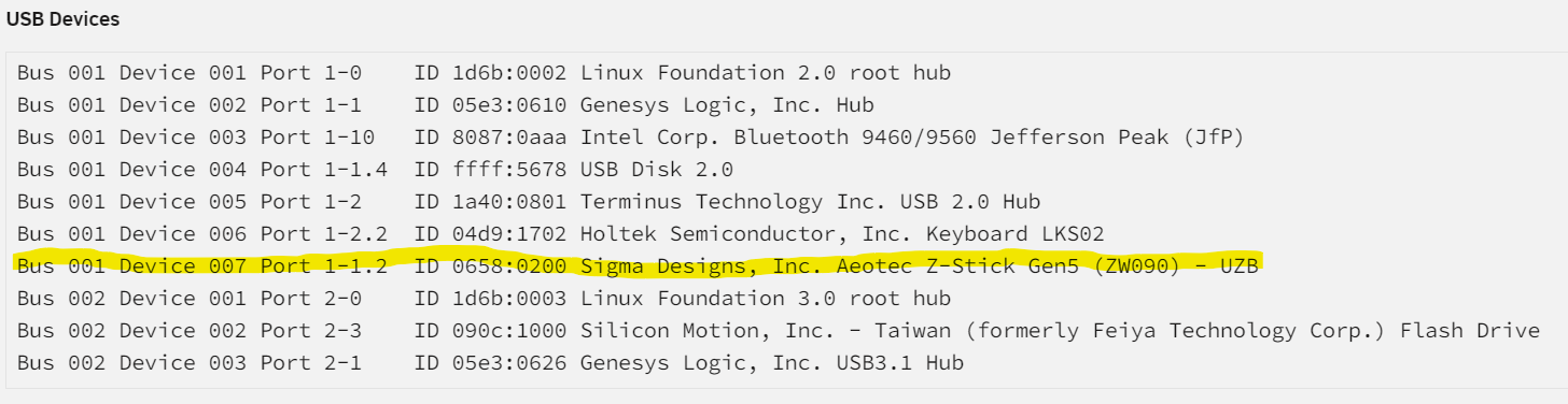

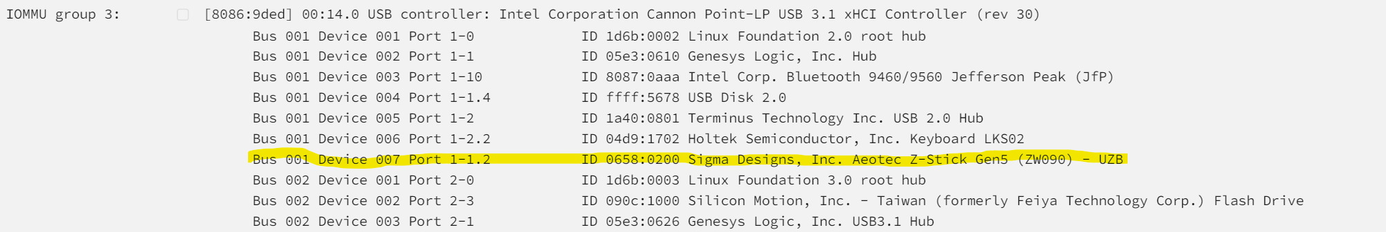

After adding the stick to unraid and rebooting I see it in devices.
aeotec1.thumb.png.3b26bcf1e31d87f5bfa2098f4a75410d.pngaeotec2.thumb.png.235bdc8dfca83747ab4bcbf4a10e60ca.png

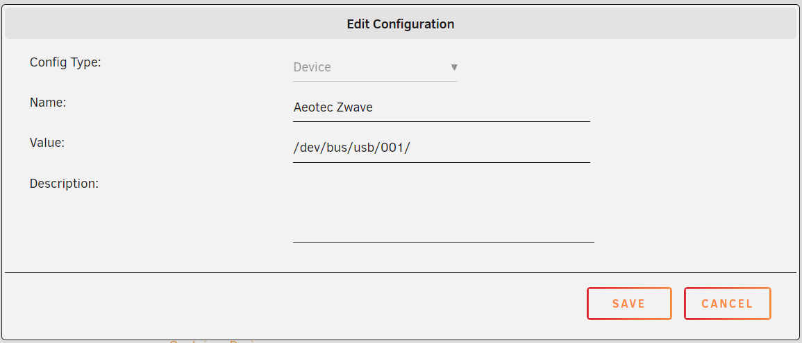

Now within docker I can add a device, the interface takes me this far, but that looks like I am passing thru the whole usb port, is this correct?

I think I'm missing something.. all the threads seem to use /dev/ttyyll type command yet when I try that by adding a device it doesn't load as if the path is wrong.
I can however do /bus/usb/001/009 but the number of a device seems to change with every server restart...
My Intel Corp. AX210 Bluetooth was 008 then 010 & now its 009
