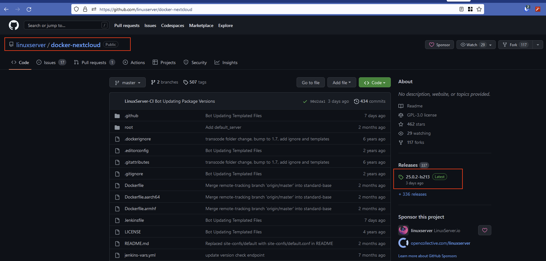

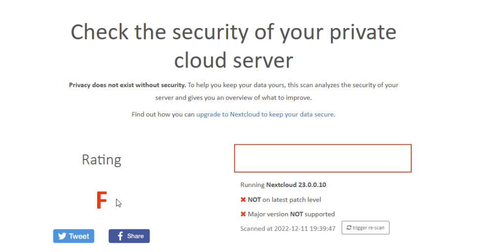

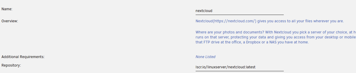

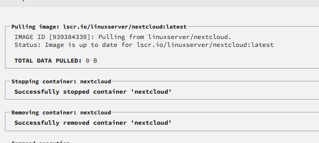

Doublemyst Posted December 11, 2022 Share Posted December 11, 2022 (edited) Hi there My nextcloud docker is on version 23.0.0 and I can't update it to the newest 25.X.X. I have checked the repository and pressed "force update" but it doesn't download anything new and is standing on the version 23.0.0. How can I update this docker? Here some screenshots from my setup: Edit: Here also nextcloud security check: On the support page, it says, that the latest version ist 25.X.X I have tried all I know, but didn't got it updated... I have also removed the ":latest", but it didn't help .. Thanks for any help! Cheers! Edited December 11, 2022 by Doublemyst added security check Quote Link to comment

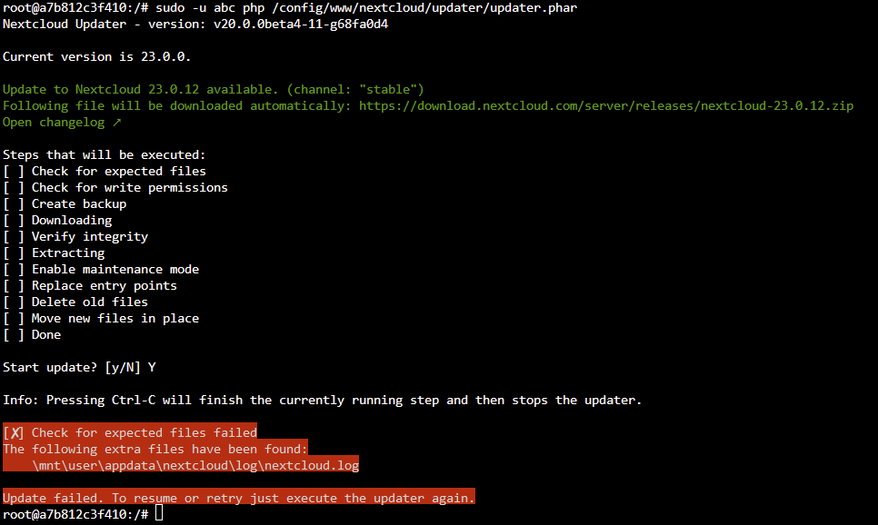

deadnote Posted December 11, 2022 Share Posted December 11, 2022 (edited) My nextcloud's repository is "linuxserver/nextcloud". Why do you have "lscr.io/" in yours ? To update nextcloud softwaire, in unraid docker page, right click on nextcloud and select "console" Then, execute this command to update nextcloud : sudo -u abc php /config/www/nextcloud/updater/updater.phar Edited December 11, 2022 by deadnote Quote Link to comment
Doublemyst Posted December 12, 2022 Author Share Posted December 12, 2022 Hi @deadnote Thanks for your reply. The lscr.io/ in the beginning is deault repository of nextcloud (when you install it over Apps). I have tried to launch your command, but got following response: In the log files - i have deleted all the files, but the issue persisted. Then I thought, maybe it's a permission issue, and run following commands according to this post ( chown -cR nobody:users mnt/user/appdata/nextcloud chmod -cR ug+rw,ug+X,o-rwx /mnt/user/appdata/nextcloud But this didn't help neither... Quote Link to comment
deadnote Posted December 12, 2022 Share Posted December 12, 2022 Have a look here : https://help.nextcloud.com/t/error-nextcloud-update-the-following-extra-files-have-been-found-nextcloud-log/109848 I have no "logfile" in my config.php, maybe you can delete the line if you have it Quote Link to comment

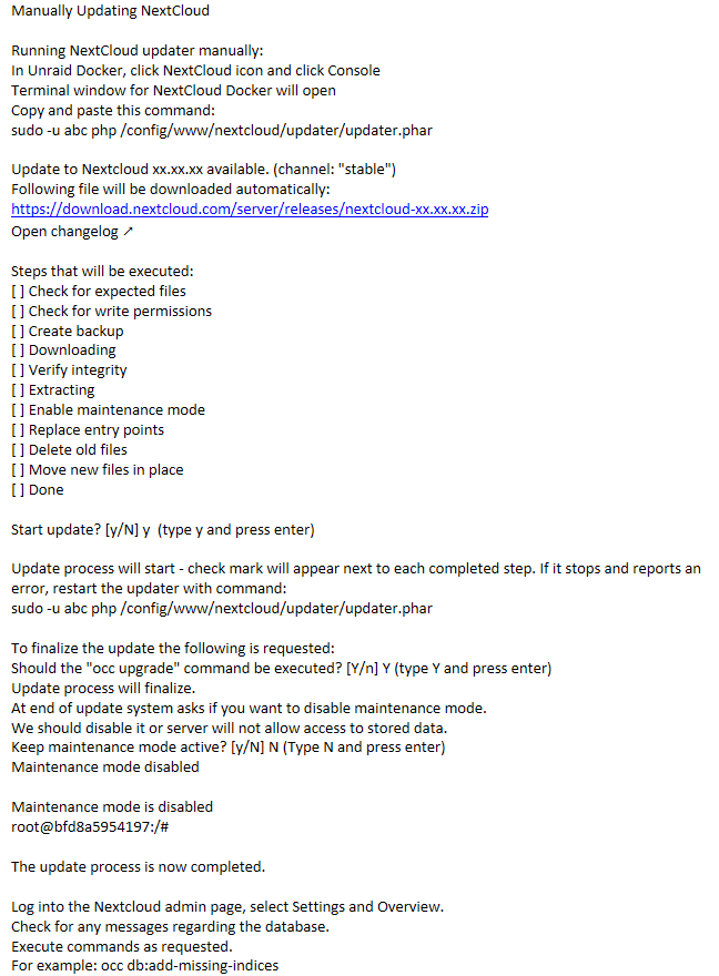

abonabca Posted December 23, 2022 Share Posted December 23, 2022 I gave up trying to use the web updater, just kept failing and clicking Retry over and over did nothing. This is what worked for me. I went from 22.2.3 all the way to 24.0.8 without a hitch using this method below. I just repeated it for each successive version. Quote Link to comment

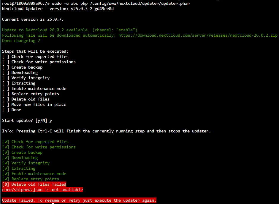

apolaco Posted June 13, 2023 Share Posted June 13, 2023 i keep getting [✘] Delete old files failed. after every try its a different file. can anybody help? Quote Link to comment
RubenDijk Posted June 16, 2023 Share Posted June 16, 2023 (edited) Same here, It update and then the error I download the missing files from this page: https://download.nextcloud.com/server/releases/ Copy them to the core folder and the update works! Edited June 16, 2023 by RubenDijk Solution Quote Link to comment
