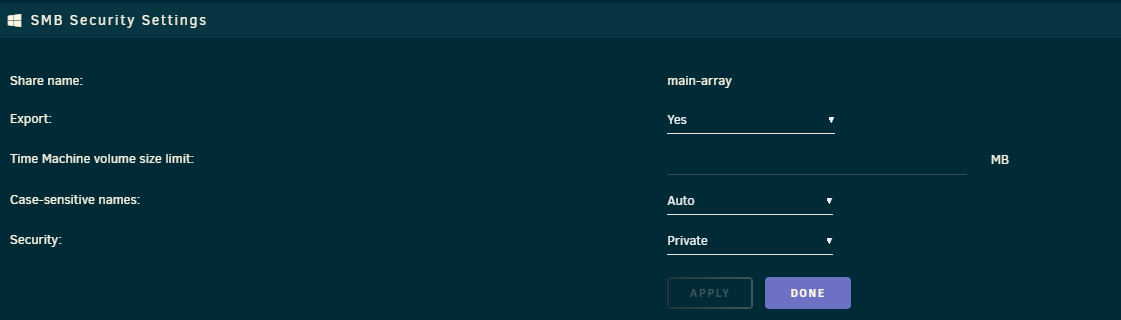

Share settings:

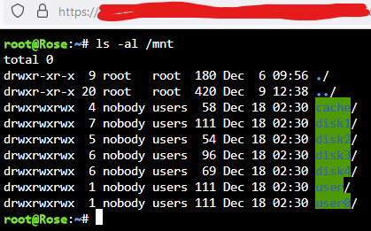

I am totally confused at this point.  /mnt/storage-server-01  is actually in RAM IF it is on the Unraid server!     Please use the GUI terminal and capture the screen shot of the output of the following command:
ls -al /mnt
It should something like this:
Also post up the diagnostics file of your server.
