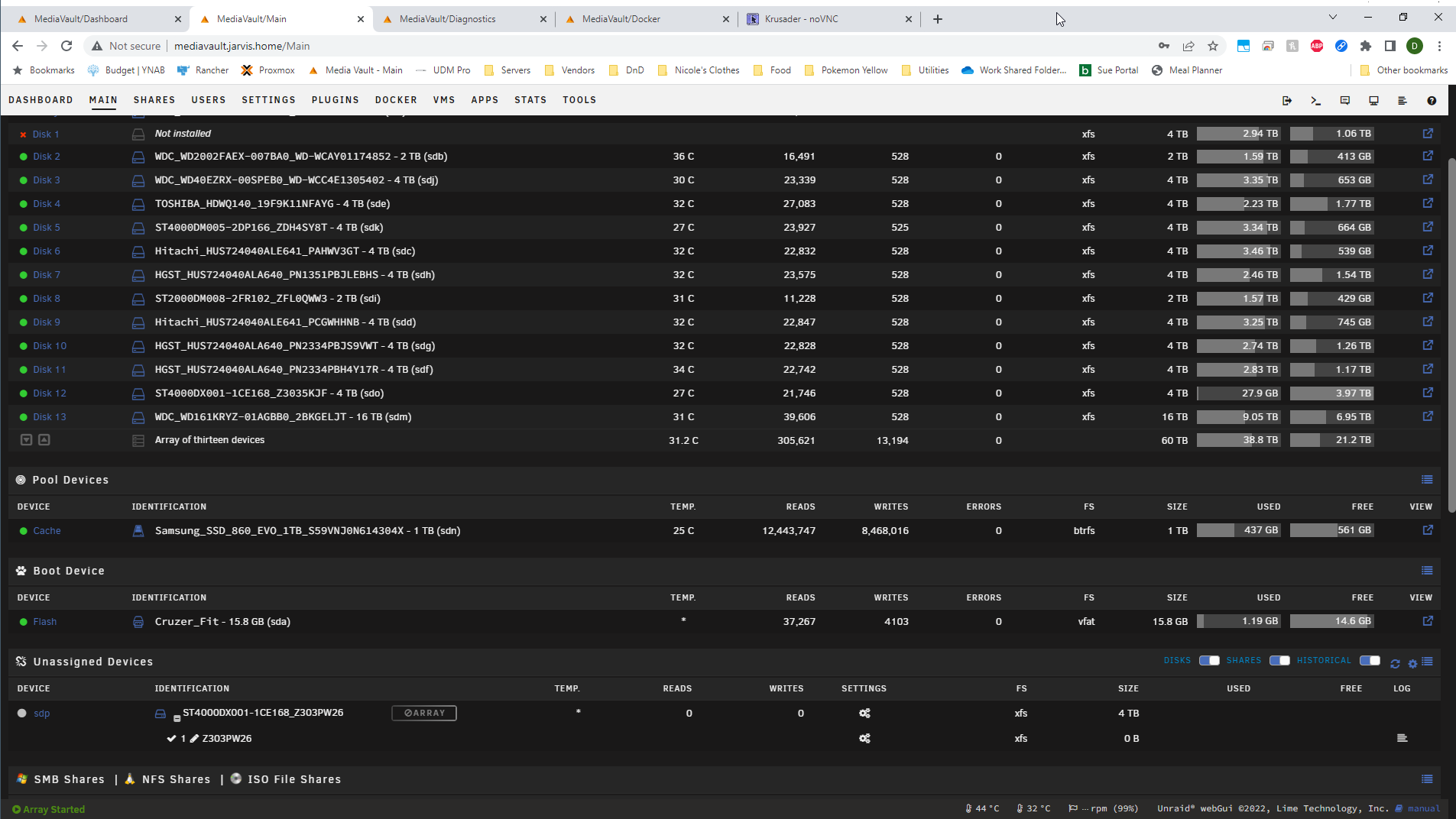

Woke up this morning to my disk1 showing as disabled. I've had no issues with it for the last few months and haven't touched any of the cables. My server is currently in a server rack in the basement so highly unlikely that it got bumped or anything. Checking the disk log information, I'm seeing a lot of bad sectors (log attached). I stopped the array and unassigned the disk, then when trying to re-assign it the disk was not in the drop down menu.
Looking through some previous posts on here, I think the disk may be dying. Attempting to run a smart report immediately fails (whether it was in the array or not) and iirc that is one of the older disks in the array. Diags attached below are from when the array was stopped.
I started the array with the disk removed, and the files from disk1 are emulated. Diags from running array are also attached. It looks like the disk (sdp) in UD is unmountable or otherwise can't be added to the array?image.thumb.png.baf3a1dc3f7955cf20b2f20b0c0fb0eb.png

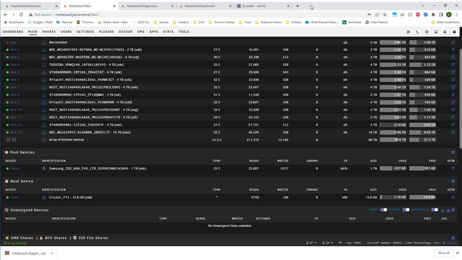

Ok server has been shut down completely, then rebooted. These are the diags from that. Disk still not showing in UD.
mediavault-diagnostics-20221212-1242.zip
51 minutes ago, JorgeB said:
but it's worth first swapping slots with a different one to confirm.
Yep, dead drive. switched connections and no dice. I'll order and install one, thanks for your help.
