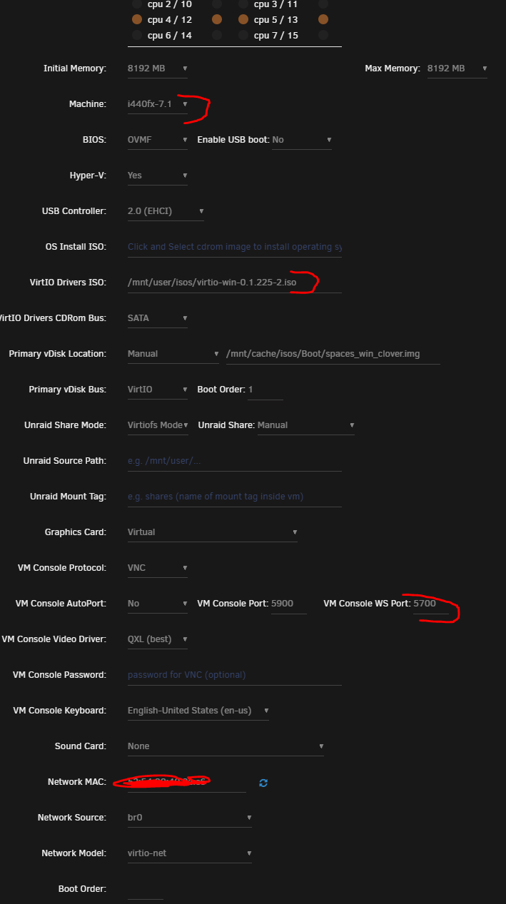

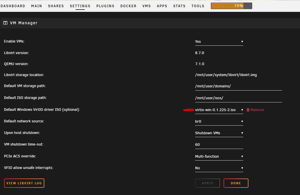

Guys seems like i got it working, not sure which setting helped in the end.
Was watching new video on Win11 install and he did upgrade the VirtIO there, so i tried :)
1. Download latest VirtIO driver
2. Then i did:
- Machine: on latest 7.1 (before 7.0)
- VirtIO Drivers ISO: latest you just downloaded
- VM Console WS Port: in here i had before "-1", maybe due to fact i did edit TXT as this menu in UI wasnt present.
On other VMs with Linux were values like 5701 and up+
Try it and let know if is working now ;)

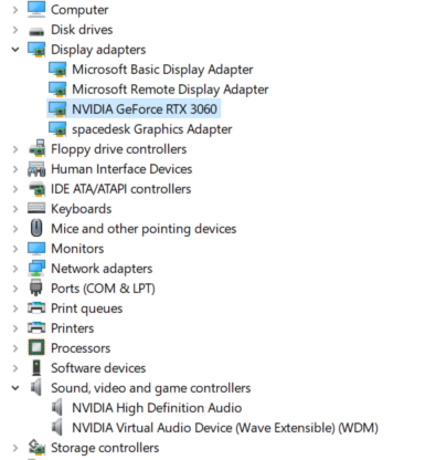

Have you tried with vnc primary and secondary 3060. Then look in device manager to see state of driver for 3060?
Also try pcie_aspm=off in syslinux config.
Edited by SimonF
@SimonF
So the VM is booting up with VNC as the primary and 3060 as the secondary.  Looking into the Device Manager under Display adapter, the video card is listed. Checked for updates for the driver via GeForce Experience and everything is updated.
Not sure why the VM doesn't boot up with the video card as the primary.
Tried pcie_aspm=off in syslinux config and the VM is still not booting with the video card as primary
Edited by mrtech213
19 minutes ago, mrtech213 said:
@SimonF

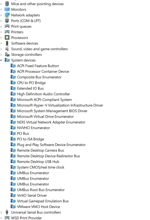

Can you show system devices from tools menu for 3060
did you reboot after this change?
Do you mean from the Device Manager?  And I rebooted the entire server after the change
Edited by mrtech213
no system devices from umraid tools.
Sorry about that lol
Have you tried binding them to vfio checkbox? also there maybe usb and serial parts.
Here's the USB
I binded them and rebooted but the VM is still not booting with the video card as primary
