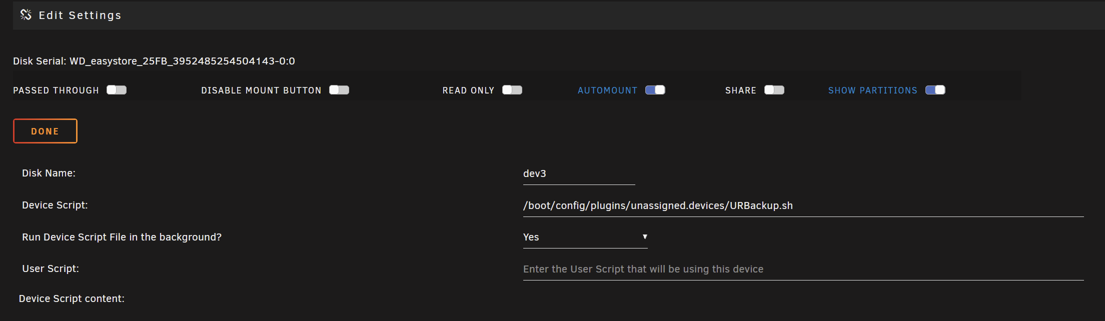

I just added these lines for each share I wanted to backup to the Unassigned Devices USB drive:
        logger {name of share} share -t$PROG_NAME
        rsync -a -v /mnt/user/{name of share} $MOUNTPOINT/ 2>&1 >> $LOGFILE
You just make the script the device script that is run when the USB drive is connected and mounted by Unassigned Devices.

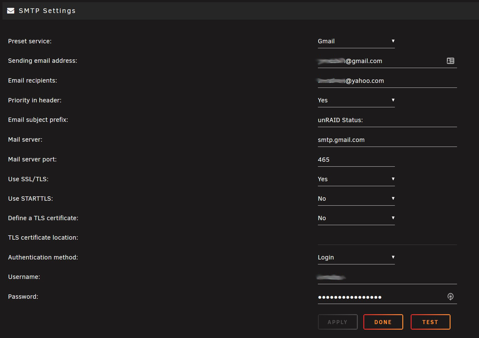

47 minutes ago, Tracker said:
where I can see how the mail notification works
Email notifications are not controlled by the script.  This is just part of the Settings-->Notification Settings configuration in the GUI.  Here are my email settings to get unRAID to email notifications to me for the events selected in the Notification Setting section:

The mail notifcation works via "alert"-state for the notification method -> 'ERROR_MOUNT'/'ERROR_UNMOUNT' -> In the system settings of the NAS, under the notification conriguration, I configuered that system notification with alert state will send as mail to.
