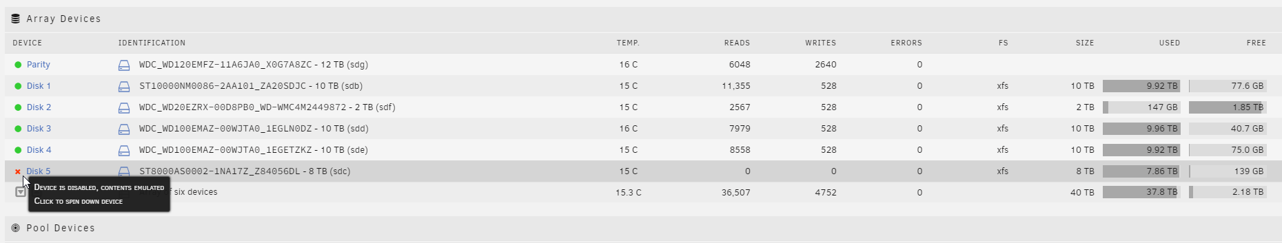

DEVICE IS DISABLED, CONTENTS EMULATED
I found a few Thread with this Problem, but I couldn't figgure out why this happend to me.
The Disk seem to be fine, also works ok in Windows, but I can't get it to work in Unraid again. I stopped the Array, the Disk is still there and I can pick it, but if I start the Array the Device is disabled again. Is there a Log somewhere why the Device got disabled in the first place?
Disk is still connected to the System, still can use the SMART. Logs attached below. Thanks

SMART for disabled disk3 looks good and it recently passed extended SMART test. Emulated disk3 is mounted only showing 75G of data with contents from 3 user shares.
Should be OK to rebuild to the same disk.
