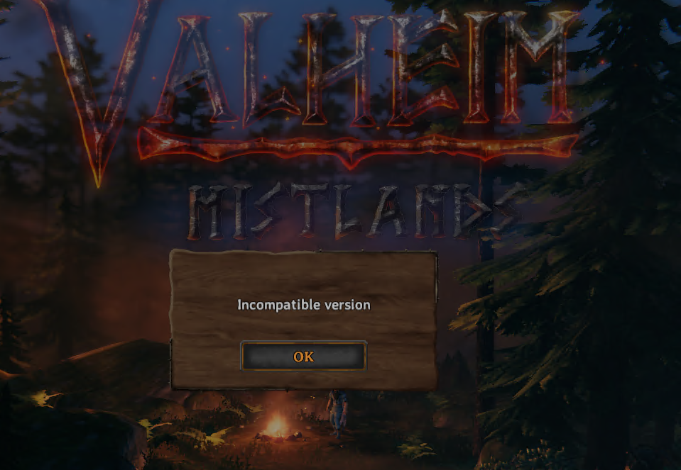

Hello everyone I am struggling after the new valheim update that happened to add the mistlands, I updated everything to my server to make it current but whenever i try to connect it still shows up as I am using an incompatible version here are some pictures of everything on my end.

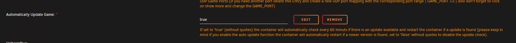

Please use the support thread from the container click on the container Icon on your Docker page and click Support.
Anyways, please go to the template and set Validate Installation to "true" (without double quotes) and click Apply.

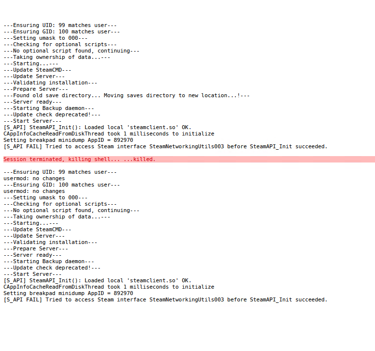

Open up the log and wait for the container to fully start (line "Server Start")
After that open up again the template and set Validate Installation to "false" (without double quotes) or simply let it empty and click Apply.
This should solve your issue, if not please post in the support thread.

Please also provide a bit more information what is not working and provide the logs?
