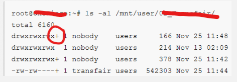

One more possibility is that someone made changes to the permissions on a share (and its contents) using Windows Explorer.  This has caused issues in the past.  What has been found in these cases is that a feature, has been enable on the Unraid side, called Access Control Lists (ACL for short). This will show up as an ‘+’ at the end of the Linux permissions. See the screen capture below:
Note that the ‘+’ is also on the file as well as the share/directory.   ACL changes the way that Linux is going to control access to these resources. After some research, I found out that Windows has used ACL for a long time.  The SAMBA group has added ACL into its version of SMB.  Unraid does not use ACL in its security scheme.
Now, I suspect that if one is using Active Directory (AD) to access an Unraid server, AD could also be setting ACL.  But I would think that in most cases, if AD was in use, there would be a IT person who would be setting things up to work properly in that AD environment.
