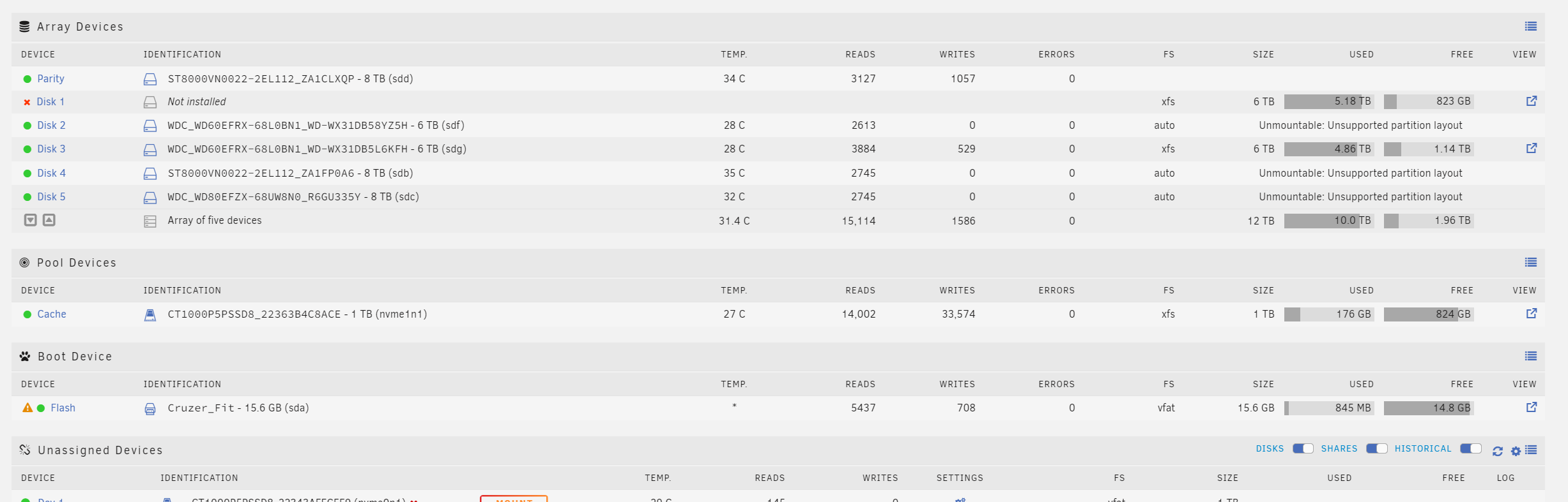

I got new hardware and was messing about with dual booting windows and unraid. But when I went back and booted unraid my parity and 4 out of my 5 disks are now showing as unmountable saying 'unsupported partition layout'.

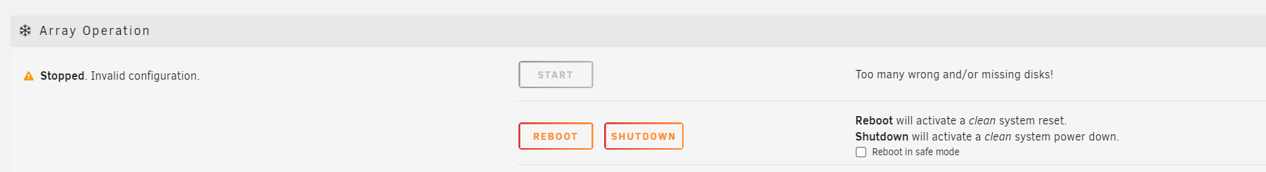

When I remove 1 disk it says
'Too many wrong and/or missing disks!'
That doesn't make sense, post a screenshot of main.

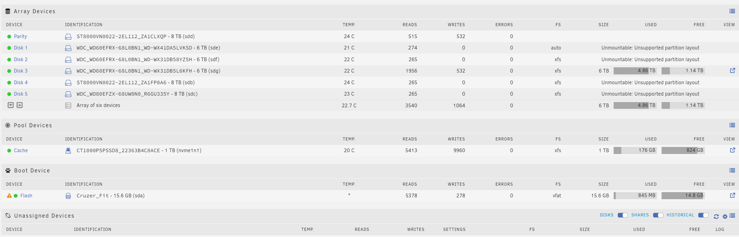

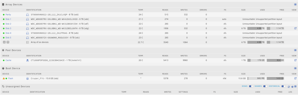

You must have or the array disks wound not be green, this might make recovery more difficult, but do another new config, keep all assignments, then check "parity is already valid" and "maintenance mode" then start the array, then stop array, unassign disk1 and start array, in normal mode now, then post new diags.
Emulated Disk1 mounted, if contents look correct you can rebuild on top, after that's done repeat for the remaining unmountable disks, one at a time.

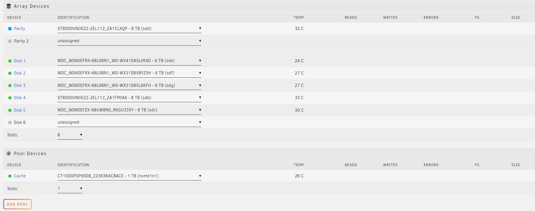

1. Start array with disk 1 unassigned
2 ???
It shows disk 1 in Unassigned Devices with the format option.  Do I format and add it back to array and rebuid parity?
Ok think i got it, I can add disk 1 back to array and it shows as blue.
Do I now start Parity-Sync and/or Data-Rebuild.
