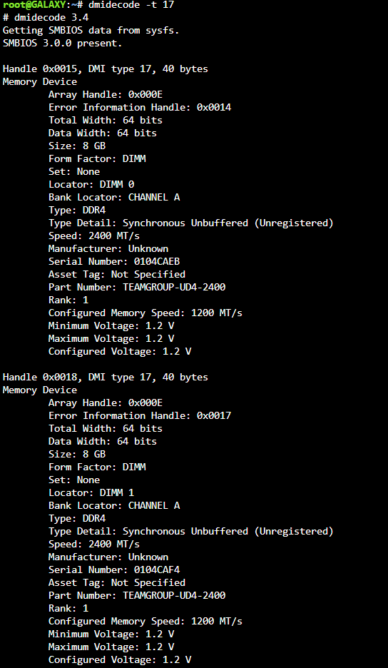

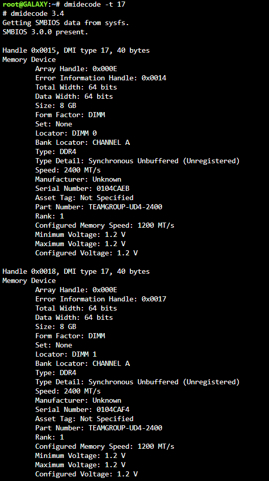

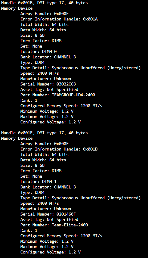

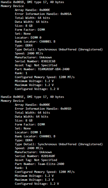

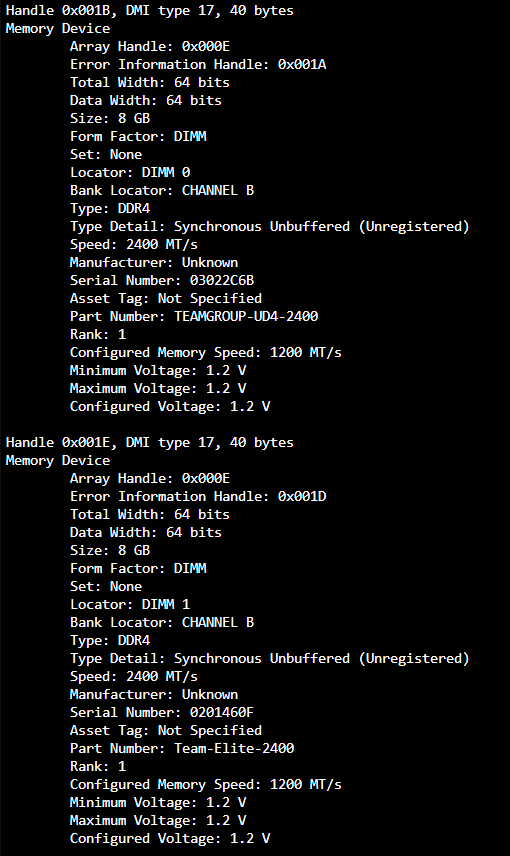

A dmidecode -t 17 report showing all 4 sticks of memory installed
