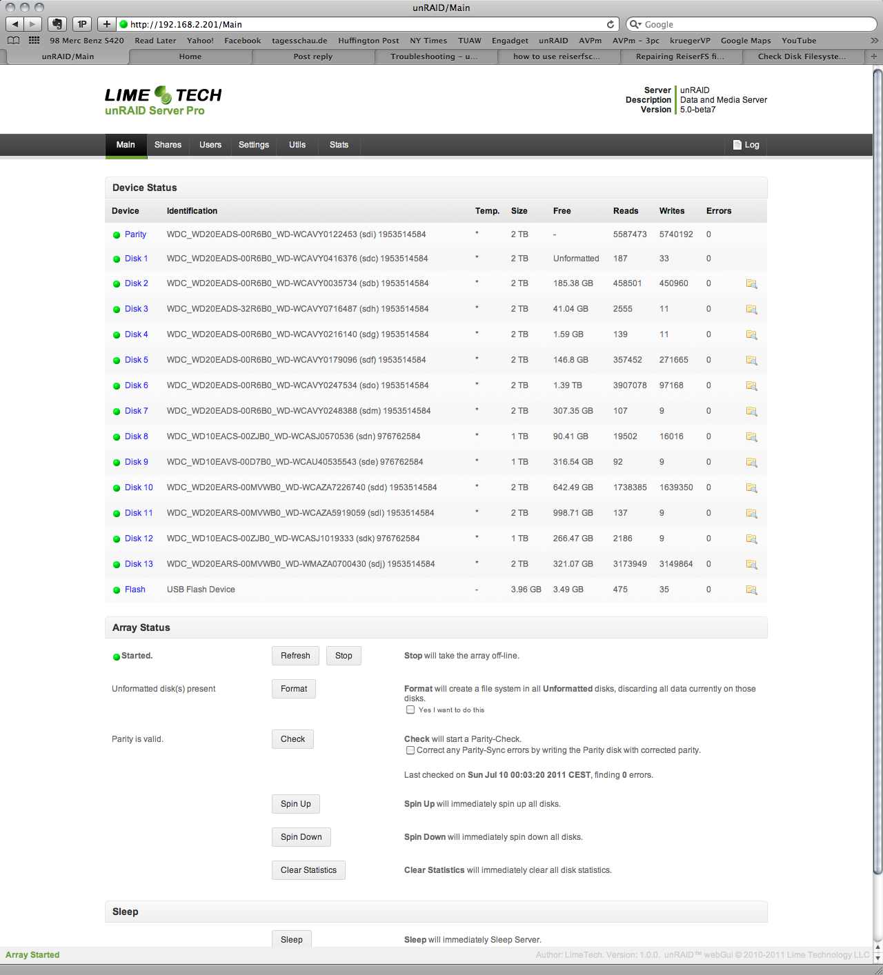

July 14, 201115 yr Author although disk6 appears to be kinda fixed after all that (at least i hope, if only through some pretty massive data-loss), restarting the unRAID server now shows disk1 as being "unformatted"...what gives?
July 14, 201115 yr Author an hour later, i did a refresh of the unRAID webGUI, and the array showed as having been stopped...when i started it, everything looked fine all of a sudden...hmmm. and i still can't do anything on disk6 due to permission problems...can't delete or move files, and even doing a simple ls command came up with this: root@unRAID:/mnt/disk6/unRAID# ls /bin/ls: cannot access Media: Permission denied Media Movies/ and "Media" isn't even a folder on that drive anymore (although there used to be an instance of it at some point in the past)...maybe the reiserfs check disk recreated it somehow? after some more scouring through online tutorials on removing folders via terminal, i tried the following...as you'll see without success, as the file-system still shows as "read-only": root@unRAID:/mnt/disk6# cd unRAID root@unRAID:/mnt/disk6/unRAID# ls /bin/ls: cannot access Media: Permission denied Media Movies/ root@unRAID:/mnt/disk6/unRAID# cd Media -bash: cd: Media: Permission denied root@unRAID:/mnt/disk6/unRAID# cd Movies root@unRAID:/mnt/disk6/unRAID/Movies# ls DVD/ HD/ root@unRAID:/mnt/disk6/unRAID/Movies# rmdir HD/ rmdir: failed to remove `HD/': Directory not empty root@unRAID:/mnt/disk6/unRAID/Movies# rmdir --ignore-fail-on-non-empty HD/ root@unRAID:/mnt/disk6/unRAID/Movies# ls DVD/ HD/ root@unRAID:/mnt/disk6/unRAID/Movies# rm -rf HD/ rm: cannot remove `HD/Till/MKV/Aladdin (1992) 1080P ISO/Aladdin (1992) 1080P.iso': Permission denied rm: cannot remove `HD/Till/MKV/Aladdin (1992) 1080P ISO/Aladdin (1992) 1080P.mds': Permission denied rm: cannot remove `HD/Till/MKV/American History X (1998) 1080P': Permission denied rm: cannot remove `HD/Till/MKV/12 Monkeys (1995) 1080P': Read-only file system rm: cannot remove `HD/Till/MKV/Two Lovers (2008) 720P.mkv': Read-only file system rm: cannot remove `HD/Till/MKV/The Green Mile (1999) 720P': Permission denied rm: cannot remove `HD/Till/MKV/Die Passion Christi (2004) 1080P': Permission denied rm: cannot remove `HD/Till/MKV/Spiderman 3 (2007) 1080P': Permission denied rm: cannot remove `HD/Till/MKV/Men In Black (1997) 720P': Permission denied rm: cannot remove `HD/Till/MKV/Life of Brian (1979) 1080P': Permission denied rm: cannot remove `HD/Till/MKV/Der Pate 1 - 1080P': Permission denied rm: cannot remove `HD/Till/MKV/Eagles Farewell Tour Live From Melbourne (2005) 720P': Permission denied rm: cannot remove `HD/Till/MKV/The Curious Case of Benjamin Button (2008) 1080P': Permission denied rm: cannot remove `HD/Till/MKV/Ratatouille (2007) 1080P ISO': Permission denied rm: cannot remove `HD/Till/MKV/Independence Day (1996) 1080P': Permission denied rm: cannot remove `HD/Till/MKV/Layer Cake (2004) 720P': Permission denied rm: cannot remove `HD/Till/MKV/Casino Royale (2006) 1080P': Read-only file system rm: cannot remove `HD/Till/MKV/Jurassic Park (1993)': Permission denied rm: cannot remove `HD/Till/MKV/Slumdog Milionaire (2008) 1080P': Permission denied rm: cannot remove `HD/Till/MKV/Der Pate 3 - 1080P': Permission denied rm: cannot remove `HD/Till/MKV/Shining (1980) 1080P': Permission denied rm: cannot remove `HD/Till/MKV/Synecdoche New York Limited (2008) 1080P': Permission denied rm: cannot remove `HD/Till/MKV/The Fifth Element (1997) 1080P': Permission denied rm: cannot remove `HD/Till/MKV/Vals Im Bashir (2008) 1080P': Permission denied rm: cannot remove `HD/Till/MKV/The Soloist (2009) 720P': Permission denied rm: cannot remove `HD/Till/MKV/The Shawshank Redemption (1994) 1080P': Permission denied rm: cannot remove `HD/Till/MKV/Midnight Express (1978)': Permission denied rm: cannot remove `HD/Till/MKV/King Kong (2005)': Permission denied rm: cannot remove `HD/Till/MKV/Terminator 2 (1991) 1080P': Permission denied rm: cannot remove `HD/Till/MKV/Pulp Fiction (1994) 1080P': Permission denied rm: cannot remove `HD/Till/MKV/Wall-E (2008) 1080P': Permission denied rm: cannot remove `HD/Till/MKV/Perfume The Story of a Murderer (2006) 720P': Permission denied rm: cannot remove `HD/Till/MKV/Sin City (2005) 1080P': Permission denied rm: cannot remove `HD/Till/MKV/Ice Age The Meltdown (2006)': Permission denied rm: cannot remove `HD/Till/MKV/Lou Reed\'s Berlin (2007) 720P': Permission denied rm: cannot remove `HD/Till/MKV/X-Men 2 (2003) 1080P': Permission denied rm: cannot remove `HD/Till/MKV/X-Men (2000) 1080P': Permission denied rm: cannot remove `HD/Till/MKV/The Butterfly Effect (2004) 1080P': Permission denied rm: cannot remove `HD/Till/MKV/8 Mile German (2002) 1080P': Read-only file system rm: cannot remove `HD/Till/MKV/Schindler\'s List (1993) 720P': Permission denied rm: cannot remove `HD/Till/MKV/Das Boot (1981) 720P': Permission denied rm: cannot remove `HD/Till/MKV/.DS_Store': Read-only file system rm: cannot remove `HD/Till/MKV/Caligula (1979) 720P': Read-only file system rm: cannot remove `HD/Till/MKV/Gomorra (2008) 720P': Permission denied rm: cannot remove `HD/Till/MKV/Titanic (1997) 1080P': Permission denied rm: cannot remove `HD/Till/MKV/Alien (1979) 1080P': Read-only file system rm: cannot remove `HD/Till/MKV/Baraka (1992) 1080P': Read-only file system rm: cannot remove `HD/Till/MKV/2001 A Space Odessey (1968) 720P': Read-only file system rm: cannot remove `HD/Till/MKV/Die Reise der Pinguine (2005) 1080P': Permission denied rm: cannot remove `HD/Till/MKV/The Matrix (1999) 1080P': Permission denied rm: cannot remove `HD/Till/MKV/Das weisse Band (2009) 1080P': Permission denied rm: cannot remove `HD/Till/MKV/Chronos (1985) 1080P': Permission denied rm: cannot remove `HD/Till/MKV/Live at Monterey The Jimi Hendrix Experience (1986) 720P': Permission denied rm: cannot remove `HD/Till/MKV/300 (2006) 1080P': Read-only file system rm: cannot remove `HD/Till/MKV/Almost Famous (2000) 720P?': Read-only file system rm: cannot remove `HD/Till/MKV/Der Pate 2 - 1080P': Permission denied rm: cannot remove `HD/Till/MKV/Pearl Harbor (2001) 1080P': Permission denied rm: cannot remove `HD/Till/MKV/Tyson (2008) 720P': Permission denied rm: cannot remove `HD/Till/MKV/Gladiator (2000) 1080P': Permission denied rm: cannot remove `HD/Till/MKV/Spiderman (2002) 1080P': Permission denied rm: cannot remove `HD/Till/MKV/Home (2009) 1080P': Read-only file system rm: cannot remove `HD/.DS_Store': Read-only file system root@unRAID:/mnt/disk6/unRAID/Movies# ..what to do next?
