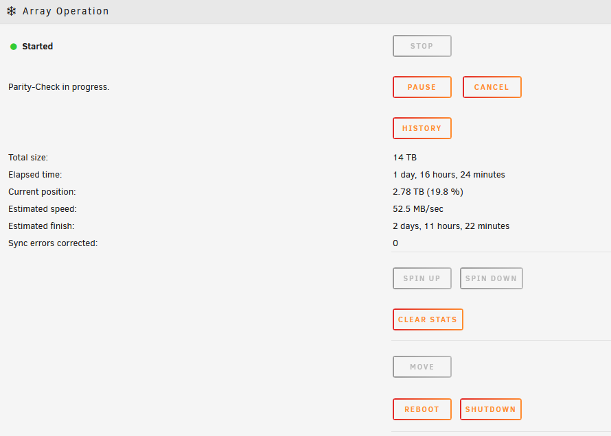

Your parity check paused after that at 18:00, resumed at 00:00. Are you sure it isn't just paused now? Post a screenshot of Main - Array Operation.
That's fine, check does "estimated finish" decreasing time to time.
Sorry, I meant screenshot from OP. If you have a problem you should start your own thread.
Just now, Nexius2 said:
Try again without clipping some of the parts I wanted to see.

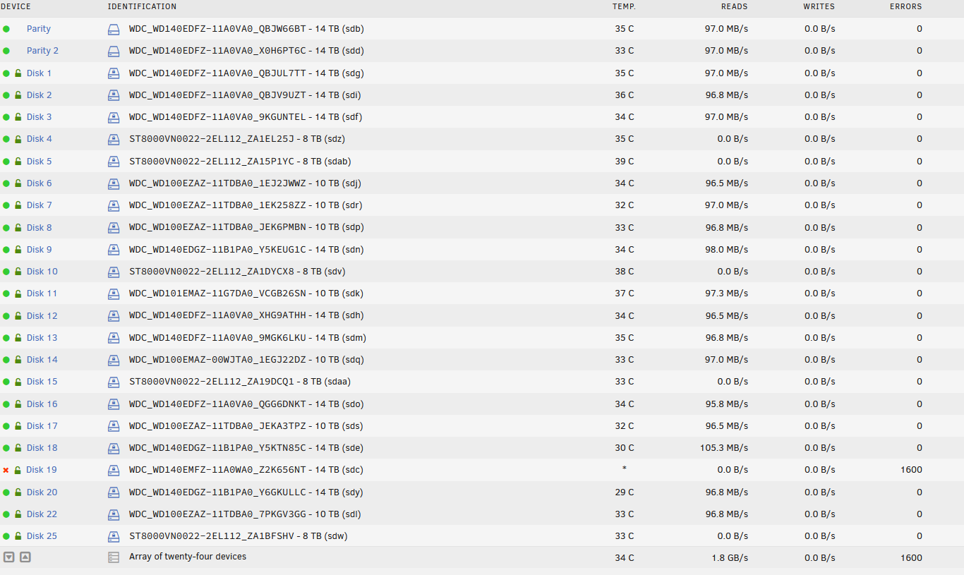

is this what you want?
No, I want only Main - Array Operations, but all of Main - Array Operations. You clipped the top and bottom of that section when you posted it before.

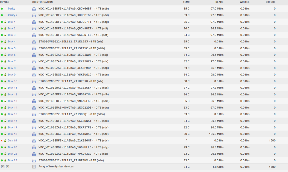

Also, FYI, your post of Main - Array Devices is also clipped on the right, making it impossible for me to see that emulated disk19 is mounted and has contents.

every time I had this, it was written emulated but not this time....
but it seems to be.
I don't need to see it though since I already could determine that from diagnostics.

I just want to confirm does corrected parity check still in progress. If nothing have change it likely in stop. ( I currently in rebuild, finish time will change continue )
image.png.fc4d5342aa3d150832f0937cf3d4c56f.png  image.png.8be6a15e780b73e9cda7f524b22c6d5e.png  image.png.07069e5754d6c7087d4a1886b987c5bb.png
Edited by Vr2Io
Just now, Vr2Io said:
Fine.
nothing has changed since last night
Then you should restart rebuild by new disk or same disk. And must confirm the power connector in good connect state.

That does show emulated disk19 is mounted and has plenty of contents. Not sure what you mean by "written emulated". If you mouseover the red X it will tell you the drive is emulated. And emulated disks can be written to (by updating parity) so those emulated writes can be recovered. If some other process was writing to disk19 those writes could be recovered by rebuild.
