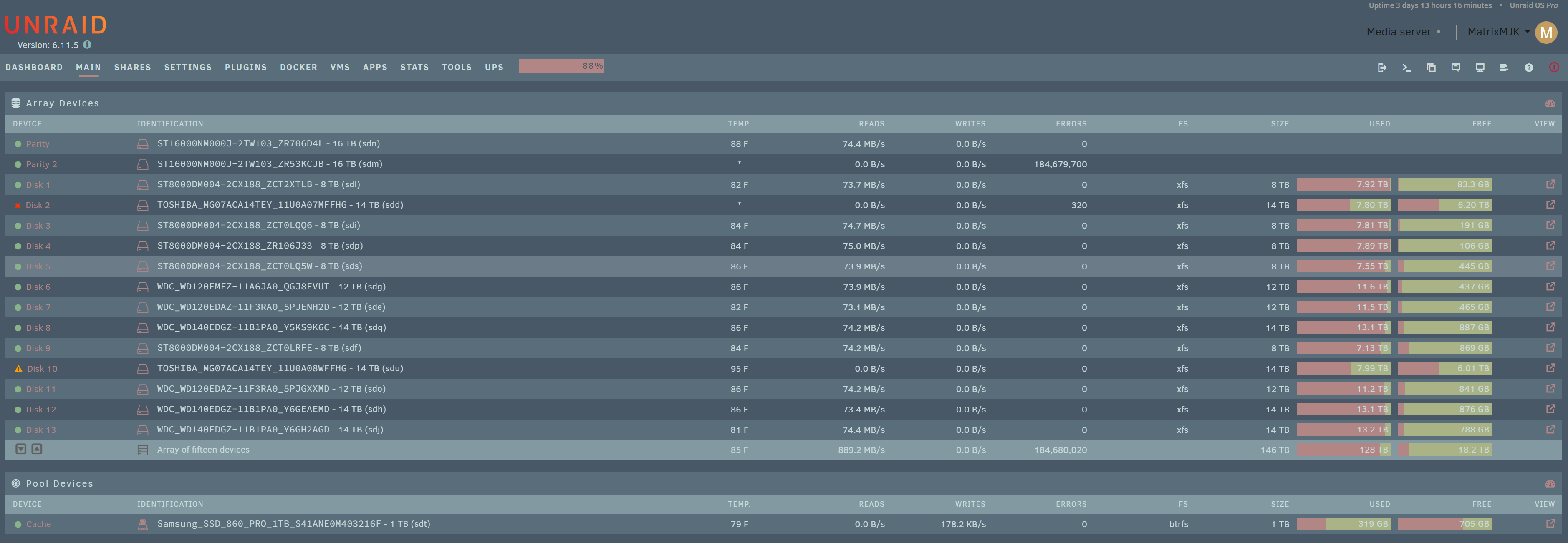

I have replaced two drives in my system to expand the array size. Last week I replaced one 10TB drive with an 8TB drive and completed the drive rebuild successfully. Then a day or so ago I replaced another drive with another new 14TB and started the rebuild. (Just a note that I followed the instructions for replacing with a larger drive at https://wiki.unraid.net/Manual/Storage_Management#Replacing_a_disk_to_increase_capacity).
Some time in the past 12-15 hours, one parity drive had a bunch of errors and the drive I had originally replaced dropped out as well. The rebuild thinks it is still running and is reading from the remaining drives, but no writes are happening.
I have enclosed a screenshot of what the array looks like and a diagnostic report from the same time.
Let me know what action to take to save what I can. I don't think the parity or the other recently rebuilt drive are bad at this point, but of course that could be the case.
Thanks for the assistance.

Parity2, disk2 and disk10 all disconnected. Disk2 became disabled. Emulated disk2 and disk10 mount and have plenty of contents. SMART for all 3 disks looks fine, I didn't check the others. Do any of your other disks show SMART warnings on the Dashboard?
I notice you have a RAID controller. RAID controllers are NOT recommended with Unraid for many reasons.
But it looks like all the affected disks are on the LSI controller. Probably you disturbed connections when you replaced disk10.
Since you have dual parity you can rebuild both disk2 and disk10.
Shutdown, check connections, SATA and power, both ends, including splitters. You will have to start rebuilds over.

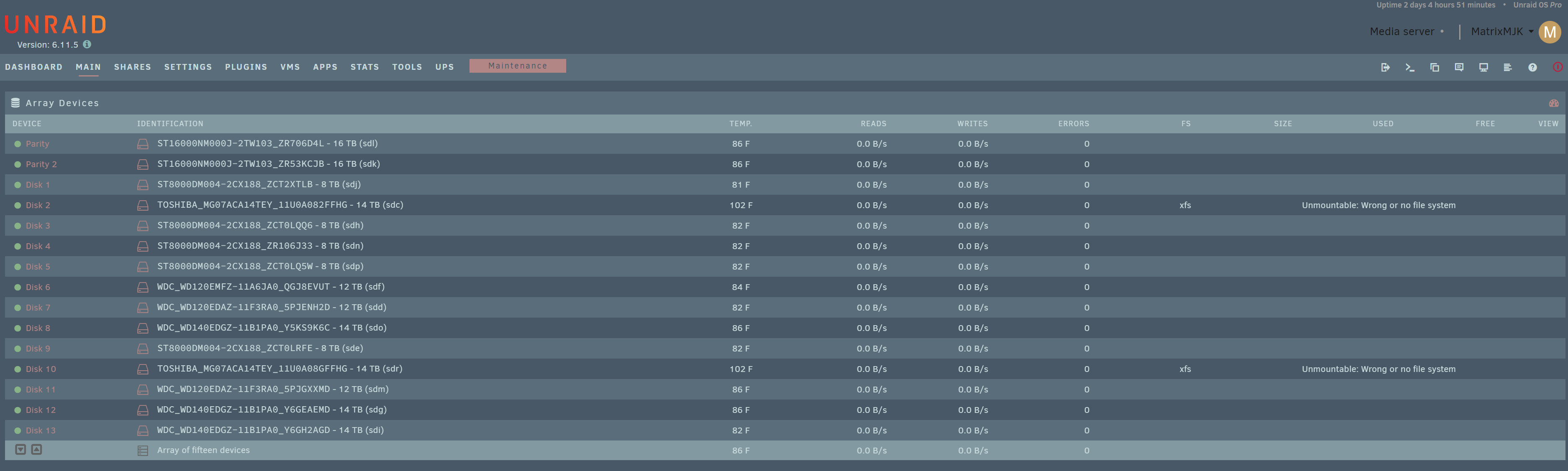

Just a quick update:
After starting the array, both drive 10 and 2 show as "Unmountable: wrong or no file system", but it looks to be rebuilding (reading from all other drives except 2 and 10) and writing to drive 10 as I would expect. I'll let it proceed and wait till morning to see if I should stop it and format the drive before starting the rebuild again.
Format is never part of a rebuild, post new diags

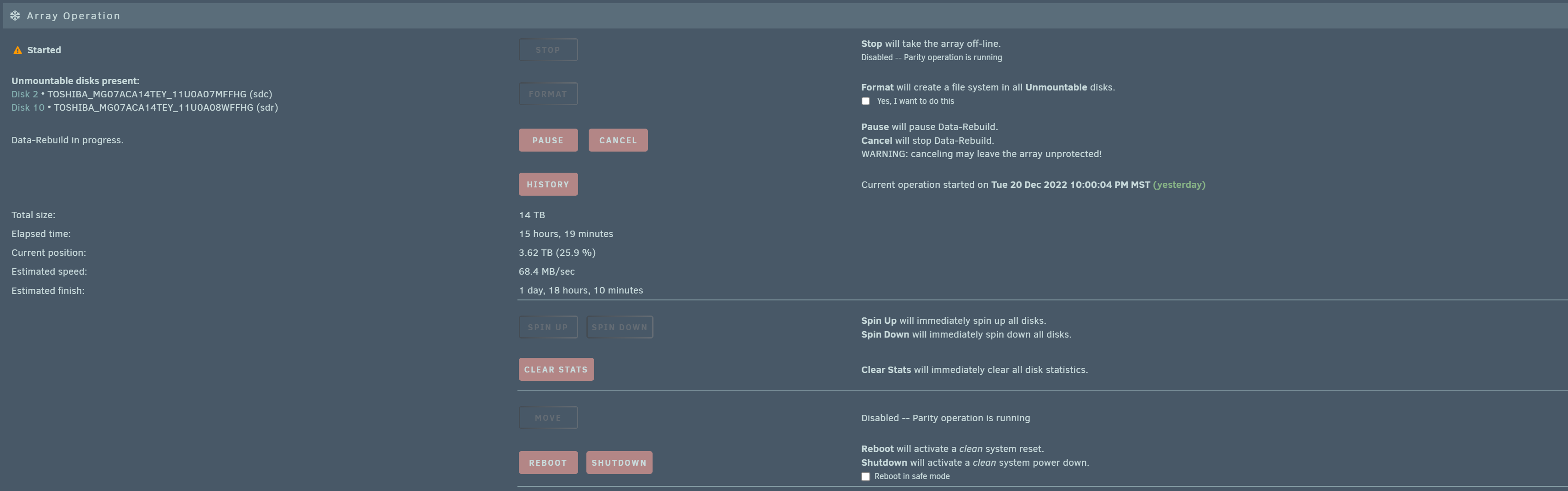

OK, I have attached current diags (while it thinks the rebuild is running) and a screenshot.
I can shutdown them machine and replace the SAS and power cables again if thats what you think I should do.

Post a screenshot of Main - Array Operation.
Not currently using the ZFS plugin. I'll remove it if it declutters the output as well as stopping the docker service.
Here is the Array Operation section:

Dec 20 22:00:04 Tower kernel: md: recovery thread: recon D10 ...
No I/O errors during rebuild, might as well let it complete and try to repair filesystems when done with disk10 rebuild. We can try to repair the emulated filesystem on the other disk before rebuilding it.

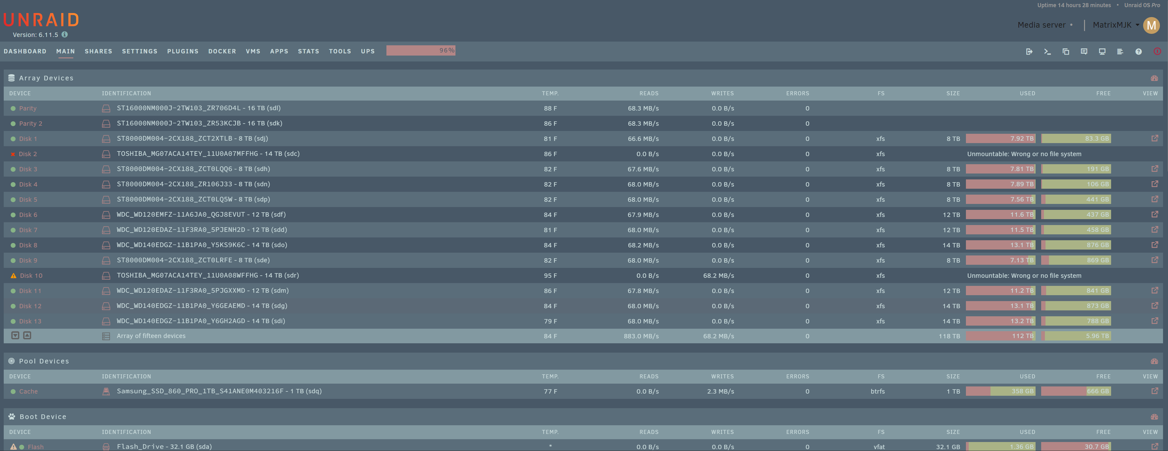

OK, drives did not really re-build. Guessed that would be the outcome from the indicators.
Ordered two new HD's. Shut the system down and replaced the two 'unmountable' drives with new ones and powered up the server. After starting up I set the two new drives to the drive #2 and #10 spots (for the missing ones) and started the array. Those two spots still show 'unmountable'.
Should I format (I know, not from the "main' UnRAID menu) or take other action to prepare the two new drives and re-start the rebuild?
I have always pre-cleared drives before using them in the array, so not sure if the format step is needed since these were not pre-cleared.
Attached is a new diag with the new drives after starting the array.
So it is now rebuilding to new disks.
Not clear there was anything wrong with the original disks you already rebuilt. Those were unmountable as expected since you were rebuilding unmountable filesystems instead of
