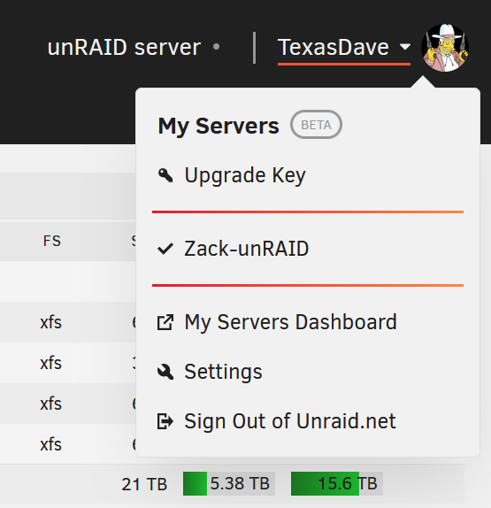

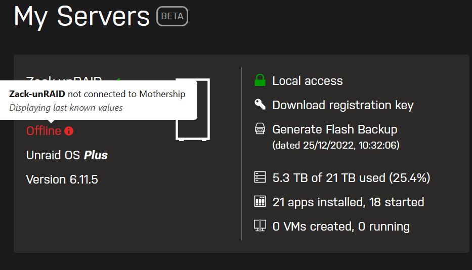

I just upgraded my cert as requested by "Fix Common Problems". Seems to have gone well. But now I cannot seem to connect using the "My Server" plugin. I attach a few command line actions and my settings Zip. My router does not have DNS Rebinding enabled.

My system does not seem to connect to the server service any more?

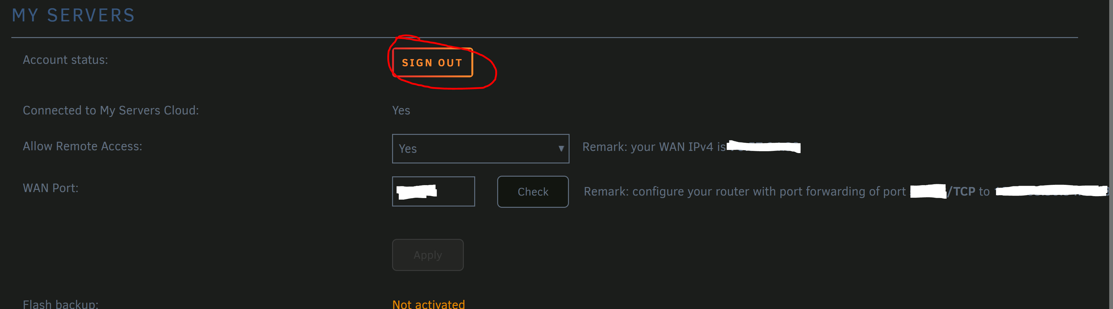

@dja, have you tried signing out from the My Servers plugin itself and not from the main Unraid menu?

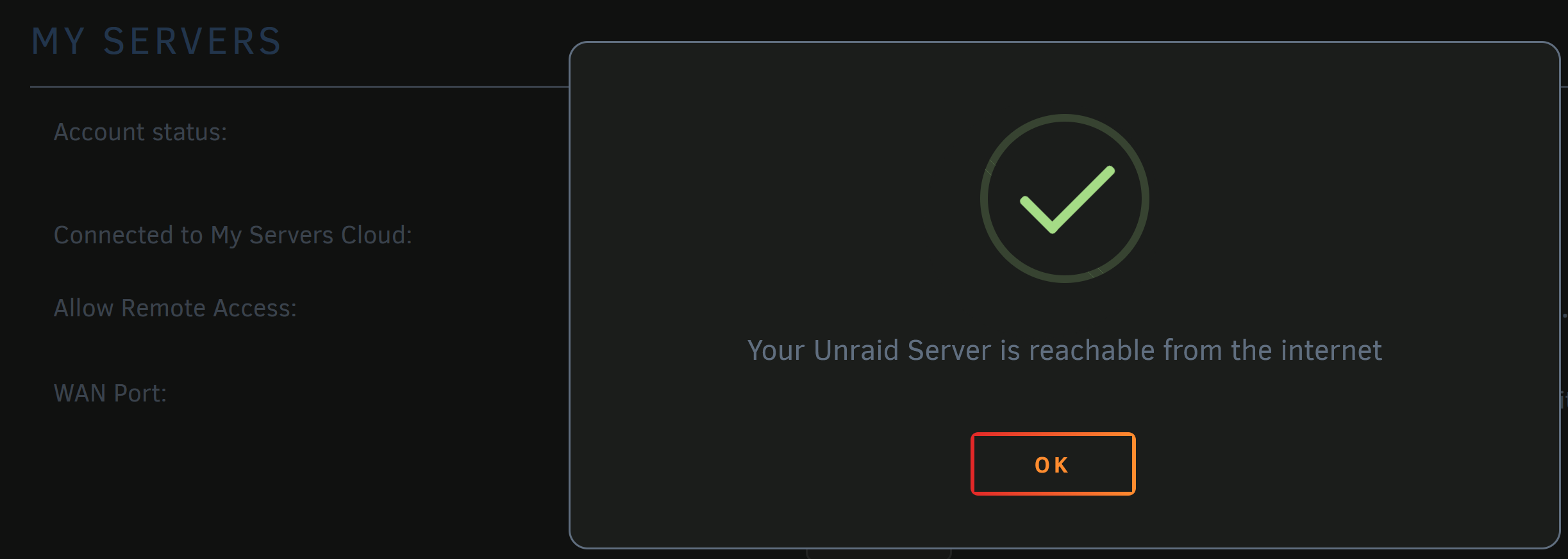

Also, are you allowing Remote Access? If so, have you clicked "Check" to confirm that it says My Servers is reachable from the internet? And (not that it should be a requirement), have you tried uninstalling and reinstalling the My Servers plugin? Mine is working, so it doesn't appear to be down across the board.

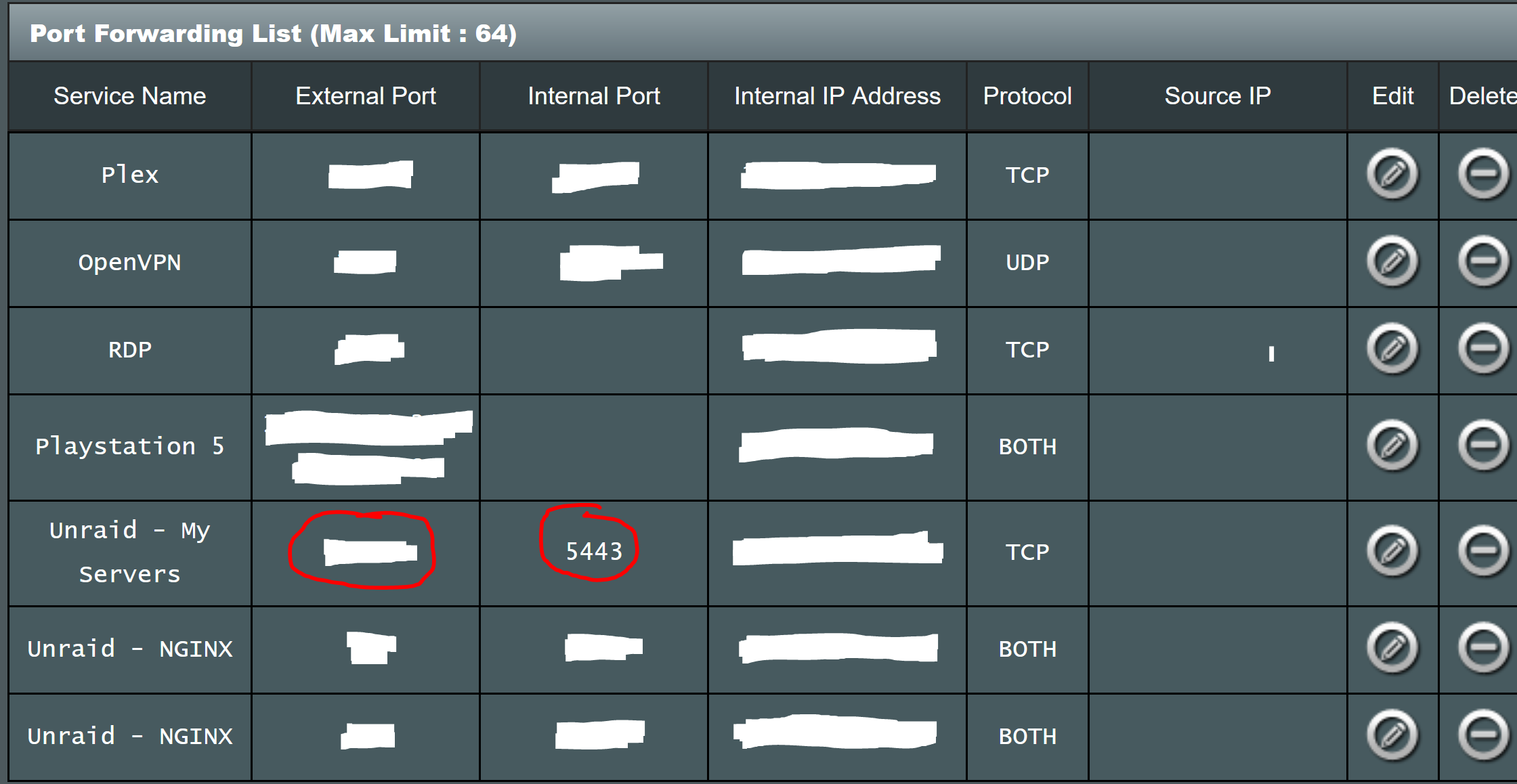

In my previous image you can see a remark that says to port forward whatever you set your WAN port to to IPV4ADD:PORT. For example, mine told me to forward it to port 192.168.XXX.XXX:5443. Did you do that on your router? This is what my port forwarding looks like on my router (although your router settings may be different):
The first circled section (the External Port) was my WAN Port in my previous screenshot, and the second circled section (the Internal Port) is the port that the remark in the previous screenshot told me to forward it to. Once you have done this (if you haven't already), try hitting the Check button from my original screenshot to see if you get this pop-up message:
Yes, I have done that and it is reachable according to the GUI.

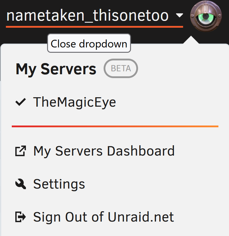

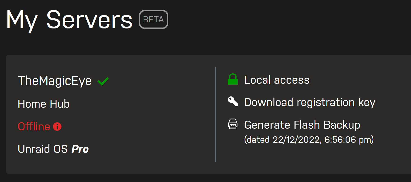

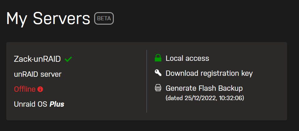

I am also having the same issues. Successuly followed the Settings → Management Access →  Upgrade Cert process in your documentation and am now no longer connected to the mothership. Occasionally on the MyServers page at Unraid.net the connection momentarily shows as connected, but is otherwise as pictured below.
Exactly what I am seeing after doing the same upgrade.

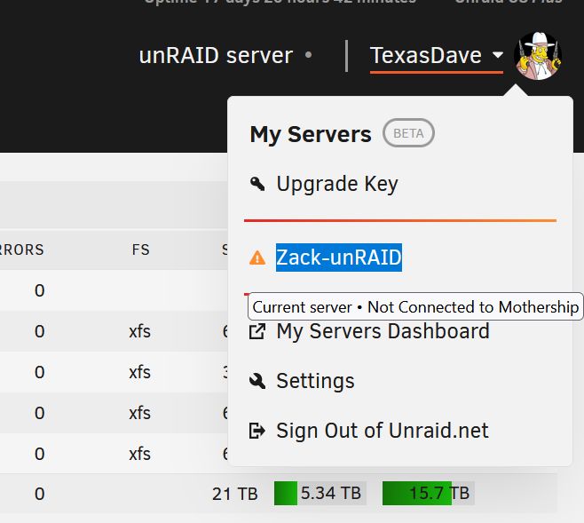

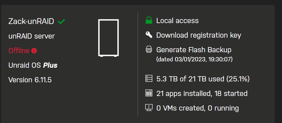

Update from me. My actual unRAID console now (mostly) shows that I am connected. Did not do anything different.
But the dashboard is very inconsistent. Sometimes it shows connected, other times it does not.
