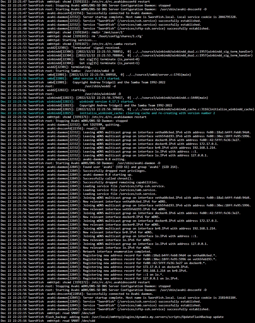

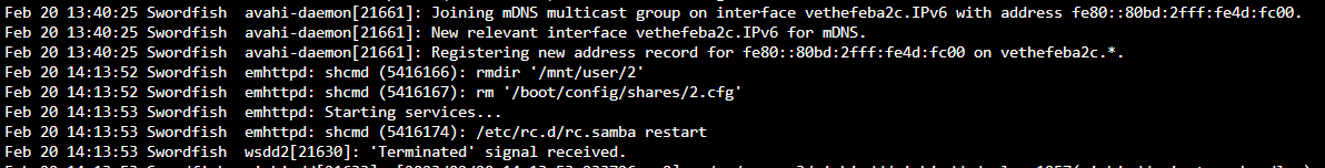

I opened up the syslog and noticed something about samba, which might be the issue? Attached a screenshot of the syslog. Hopefully I didn't leave in something I shouldn't have.

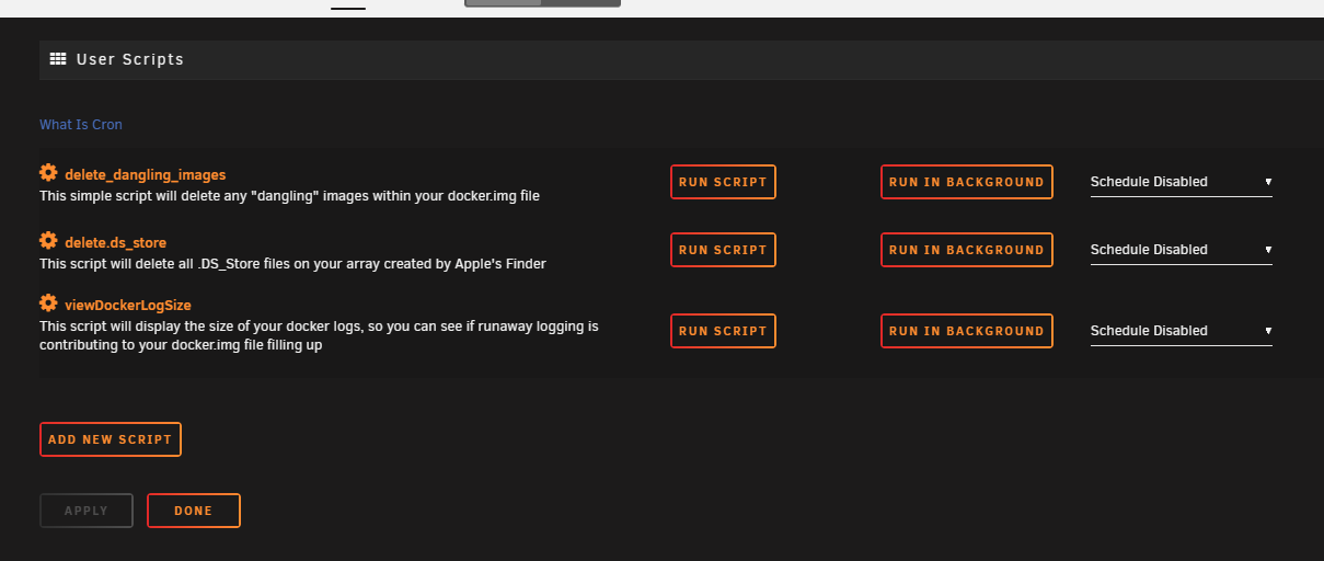

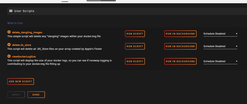

Edit: I did some searching and downloaded one of your plugins that I assume shows what user scripts I have running. It doesn't show anything is running?

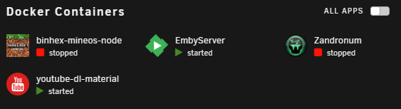

I have four dockers. Two of them are game servers, which are almost never ran. Haven't ran them for months.
Other two are an Emby server and YouTubeDL.

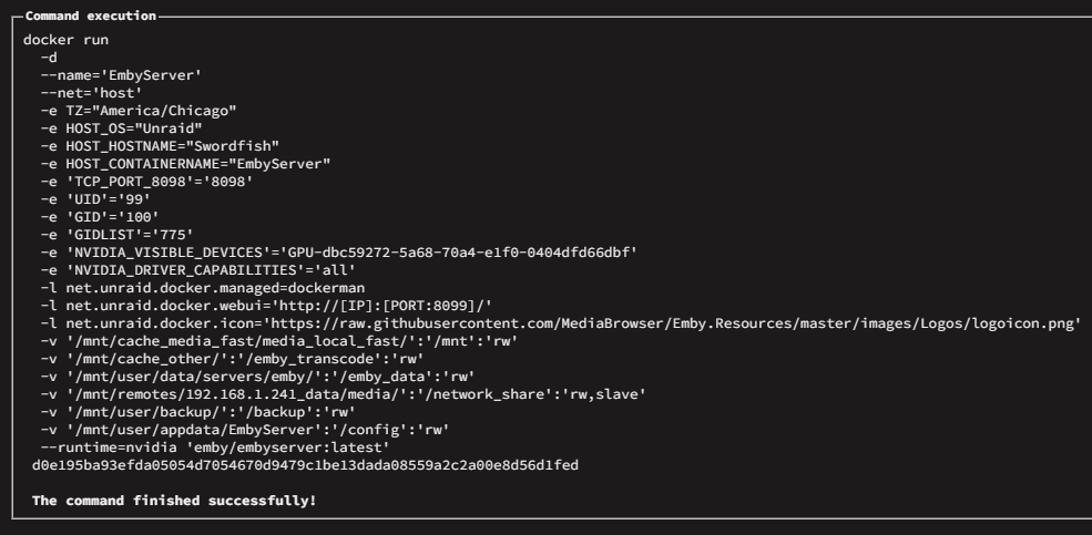

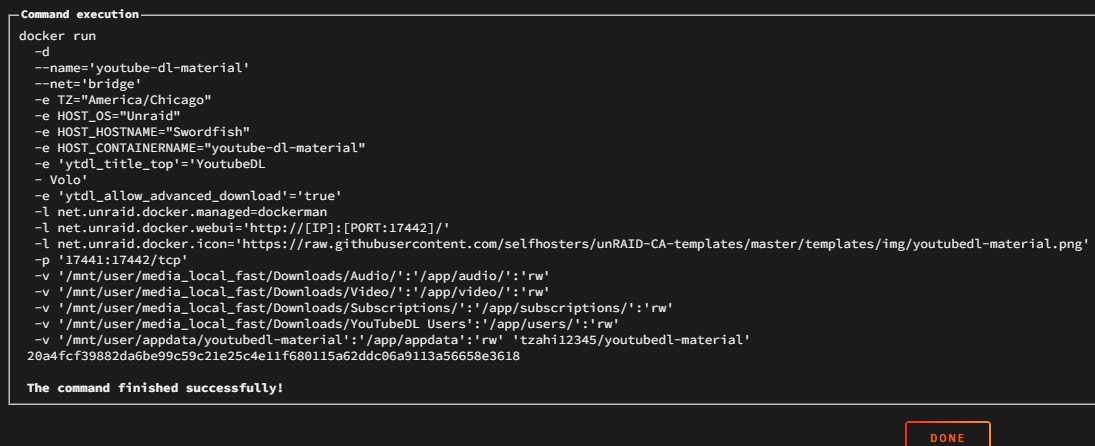

Post docker run for those
Looks like they both write to /mnt/user ?
msedge_2023-02-20_14-59-14.thumb.jpg.98ad63b7da99518324954310103dfa44.jpgmsedge_2023-02-20_14-57-51.jpg.8e09297fa1d8cba647a8606ae1bf07ae.jpg
Emby is mapping host path /mnt/cache_other (the top level of your 'cache_other' pool) to /emby_transcode.
So any time emby writes a folder named 2 in /emby_transcode, that is a folder named 2 at the top level of your cache_other pool, and so a user share named 2.

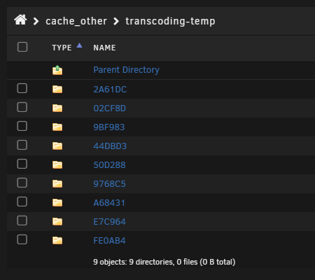

There are folders in there that it uses for transcoding. Wouldn't those also be showing as Shares?

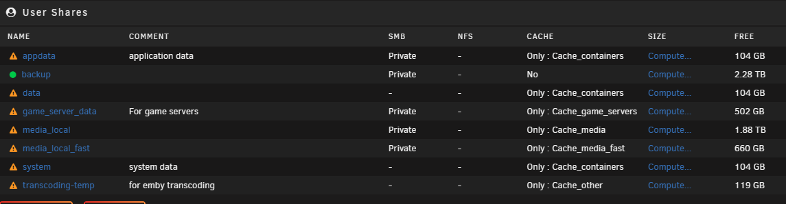

Post a screenshot of User Shares page
Here it is.

Sorry, I didn't notice that you were showing the transcoding-temp folder on cache-other. Those folders are not top level folders on cache-other. They are folders in transcoding-temp user share.
You are allowing Emby access to the top level of cache-other. If it creates a folder at that top level, it will be a user share.
