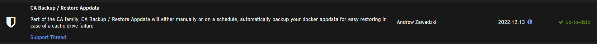

Hello,
I am currently still deployed on CA Backup / Restore Appdata, due to some of the concerns when the repo was forked a few months back as there were dev concerns reported (previous thread).
I am curious how things are coming along as I would like to consider moving to the latest repo. Anything to be noted before moving to the latest (issues, bugs, errors, specific deployment processes)?
Current version:
Thank you.
