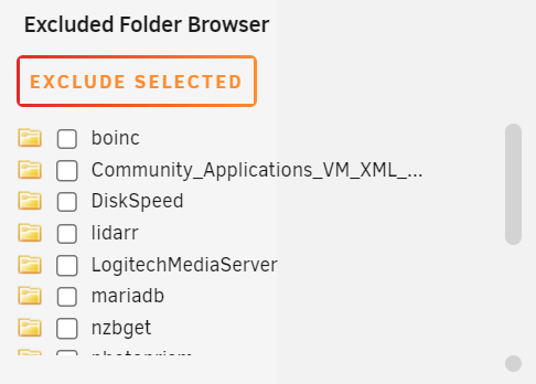

OK, how do I exclude more than one folder? I've got two for plex I want to exclude. If I past one folder in, it's there, but then how do I add a second?

On 1/19/2023 at 5:55 PM, trurl said:
Doesn't work at least on my system. I can excluded an entire selection, but that isn't what I want. I want to exclude my Plex cache and transcode folders only.
Just extend the path when filled in the textbox. You can use * as an wildcard afaik.
