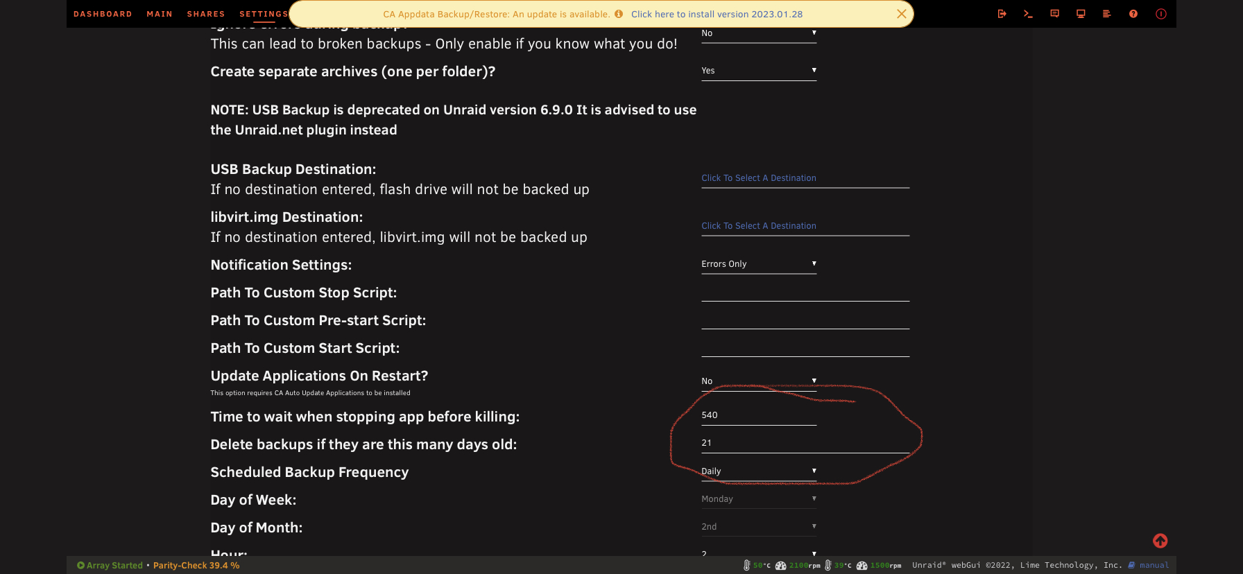

This is the closest setting.
@wgstarks - thank you for that! I cannot believe I missed it...

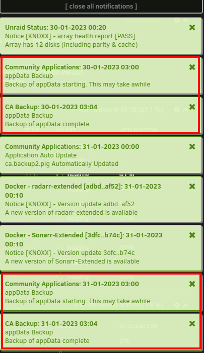

Double Notifications
I can't say how long this has been going on for as I just noticed it. I'm seeing double notifications of appdata backup, and, from different 'senders'.
It always starts with "Community Applications" but shows finished from "CA Backup".
Same start and end times.
Nothing showing wrong in the log at all.
Maybe some differences in the code. Something I fix later.
you could notifs at errors only, if you wish.
I put it to notify just to make sure that it was actually running. I'll be changing it back to errors only now.
Just thought I would mention what I saw happening.
