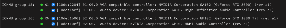

Under unRAID System Devices, I see:
IOMMU group 1:
[8086:1901] 00:01.0 PCI bridge: Intel Corporation 6th-10th Gen Core Processor PCIe Controller (x16) (rev 07)
[8086:1905] 00:01.1 PCI bridge: Intel Corporation Xeon E3-1200 v5/E3-1500 v5/6th Gen Core Processor PCIe Controller (x8) (rev 07)
[10de:2204] 01:00.0 VGA compatible controller: NVIDIA Corporation GA102 [GeForce RTX 3090] (rev a1)
[10de:1aef] 01:00.1 Audio device: NVIDIA Corporation GA102 High Definition Audio Controller (rev a1)
[10de:1b06] 02:00.0 VGA compatible controller: NVIDIA Corporation GP102 [GeForce GTX 1080 Ti] (rev a1)
[10de:10ef] 02:00.1 Audio device: NVIDIA Corporation GP102 HDMI Audio Controller (rev a1)

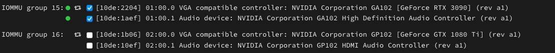

Both GPUs (VGA & Audio devices) are bound to vfio-pci for passthrough purposes, as seen by the green dots next to the GPUs.
1997788629_Screenshot2022-12-23at4_13_20PM.thumb.png.51d5895c8c296240f0281a5f1b9fbd23.png
Questions:
Is this an issue because both GPUs are on the same IOMMU group? Is there any safe way to break up the cards into different IOMMU groups, but keep the multiple functions the cards on the same IOMMU group?
Can anyone in the community help me through the steps needed to resolve this issue. Thanks in advance!
Probably yes
Why you want this?Even if audio and video are on different iommu there should be no issue...
Just enable in the config acs override patch, set it to 'both' (meaning downstream,multifunction), reboot the server, check again your iommu groups, reassign devices to vms if needed.
Set the gpu in the target as multifunction as you did.
On 12/24/2022 at 7:50 AM, ghost82 said:
Probably yes
Thanks for your reply and suggestion. I set the config acs override to both. When I boot into the first VM (either Ubuntu Server or Windows), that particular VM will boot properly and work with its appropriate video card. When I boot the second VM, I no longer get the error message popping up.
However, as the second VM boots, the first VM always auto terminates, so it's not running both VMs at the same time. I tried using the option downstream, but this resulted in the same symptoms. However, it kept the multifunction capabilities on the same IOMMU, and the video cards were on different IOMMUs.
I don't see any error messages popping up, so I am unsure what is happening? Any ideas?
Edited by rvijay007

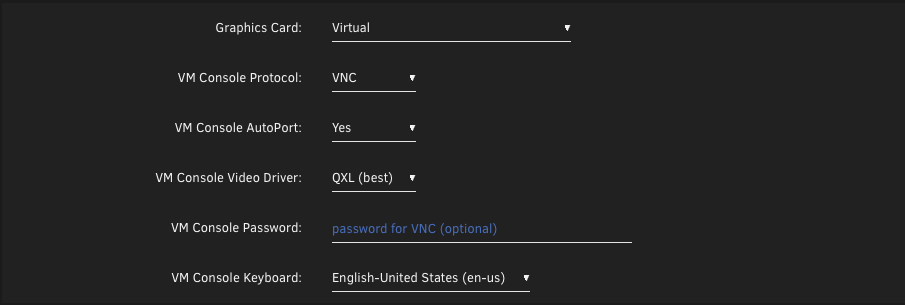

Thanks for your reply. I actually have an unbound Intel HD Graphics on the chipset that I believe unRAID uses as primary (not sure how to confirm this?), and this isn't bound to vfio-pci, as seen below.
1211030277_Screenshot2022-12-26at10_23_27AM.thumb.png.c34aee3e15c206a76f266873a6ce8ecf.png
I do have a VNC driver for both, and assume it's using the primary HD Graphics to render this, and that section is common between both VMs.
Does that affect the simultaneous usage of different GPUs? I don't think this is the case as if I remove the GPU definition from either one of the VMs, then both VMs can simultaneously run.
Only this section is the same between both VMs.
Edited by rvijay007

In the VMS tab, are the GPU's listed properly per VM?
Each GPU is in its own IOMMU group?
Not sure why you show Graphics Card set to 'Virtual', aren't you passing-through the GPU's as primary Graphics Card?
Also make sure the device ID's didn't change (01:00.x is 3090, 02:00.x is 1080) and that they match their corresponding xml's.
Make sure the xml's are proper like you show in the OP, with multifunction='on' and both video and audio passthrough are on the same bus/slot.

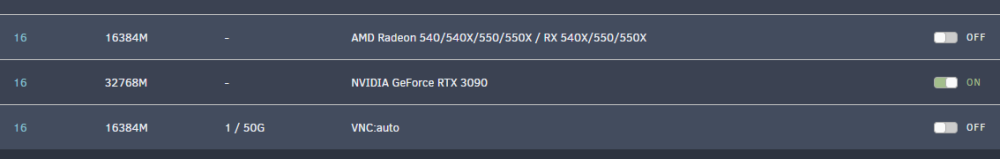

Each GPU is in it's own IOMMU group, as shown here:
1324357360_Screenshot2023-01-02at1_19_03AM.thumb.png.69d28c0c2db8986eb6f2a689a67249ee.png
I'm not sure what you are referring to when you say I said something about the graphics cards being virtual? I am trying to pass through the video cards, but don't want them to be the primary display driver as I'm trying to use them for computational purposes. That's why I also have VNC
VNC is not dependant on a GPU as it is software driven. Do you still get error say gpu is running in the other VM? Configs look ok to me.

Re: Memory - I will try out the memory suggestion and report back, but I'm confused why there are specifications for Initial and Max memory if the community says they should always be the same?

Thanks everyone. Though I don't really understand why, the issue seemed to resolve itself when I changed the Ubuntu VM definition to use the same amount of Max Memory as Initial Memory. That is, I changed it from Initial 16M Max 32M to Initial 16M Max 16M. There are 64M of RAM in my box, and those were the only 2 VMs running with nothing else of note using RAM, so there should have been plenty of RAM.
I'm not entirely sure why that was blocking concurrent GPU access, and as mentioned earlier, I could make the VMs run concurrently if I removed the GPU definition from only one of the VMs, even with different Initial/Max memory specifications on the Ubuntu.
The CPU core definition didn't make a difference; both VMs could share cores/threads and they still work concurrently after the Initial/Max memory change.
Does anyone know why the memory specification allowed the system to work?
Thankful to the community helping me through this issue!
No, that's not how initial memory works; you couldn't run both vms with gpus because the amount of reserved ram was 32+32 (at boot systems use max memory, then you need a balloon driver in the guest and manually assign memory to the host or something else to do it automatically if you want dynamic memory), system log should had reported out of system memory.
By decreasing to 16 you are able to run both vms (16+16 or 16+32).
