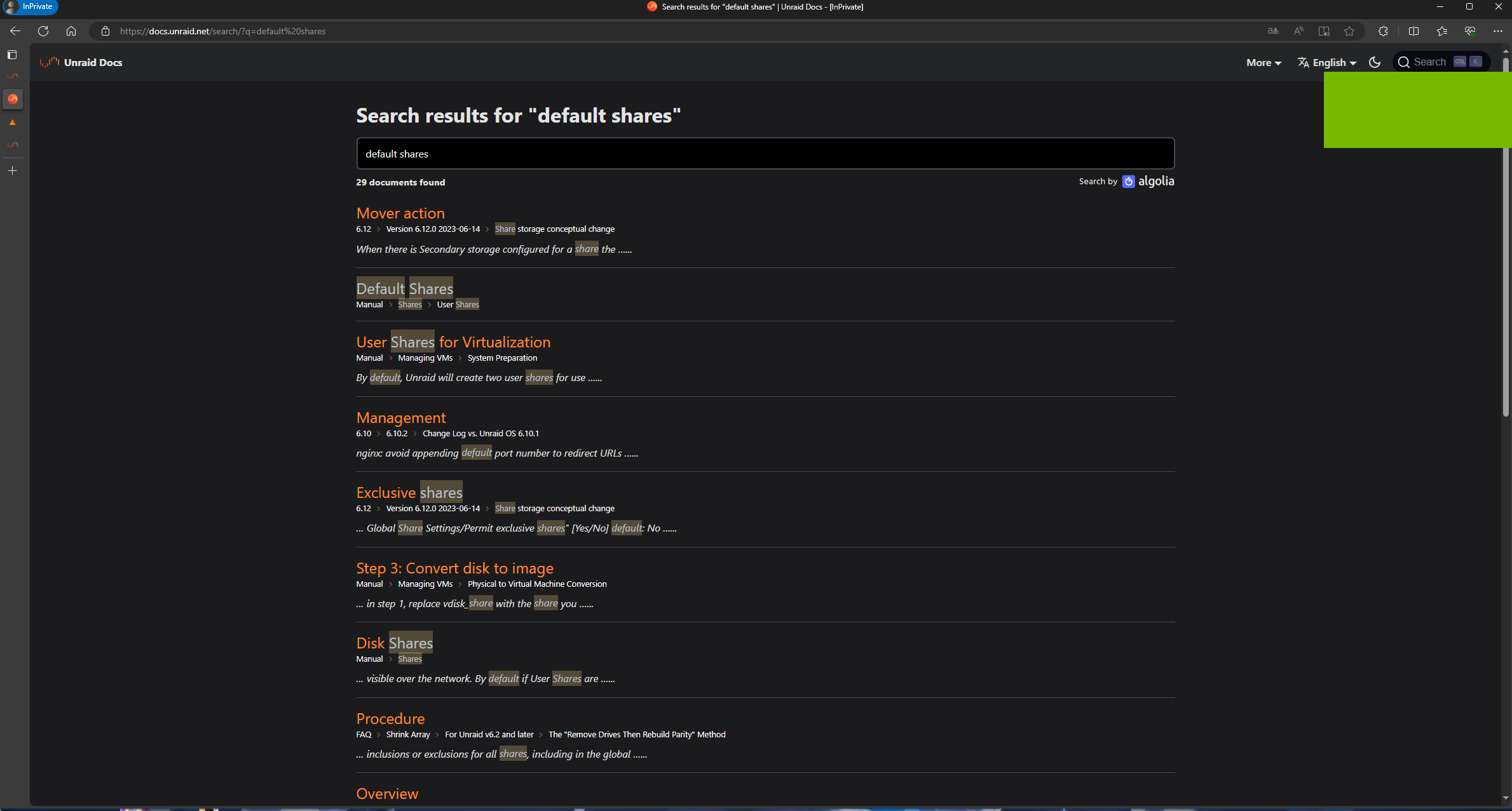

https://docs.unraid.net/search/?q=Default Shares

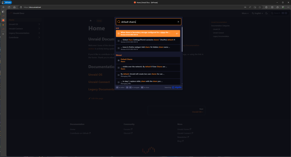

Interesting.. how'd you get the search function to work? Seems hit & miss
60244313_Screenshot2024-02-15at10_26_42.thumb.png.769a6f2b88efe66757979f32186f361b.png
1334112064_Screenshot2024-02-15at10_26_47.thumb.png.3ed3b6e83f41e687d2810abc35a11640.png
Probably a browser issue

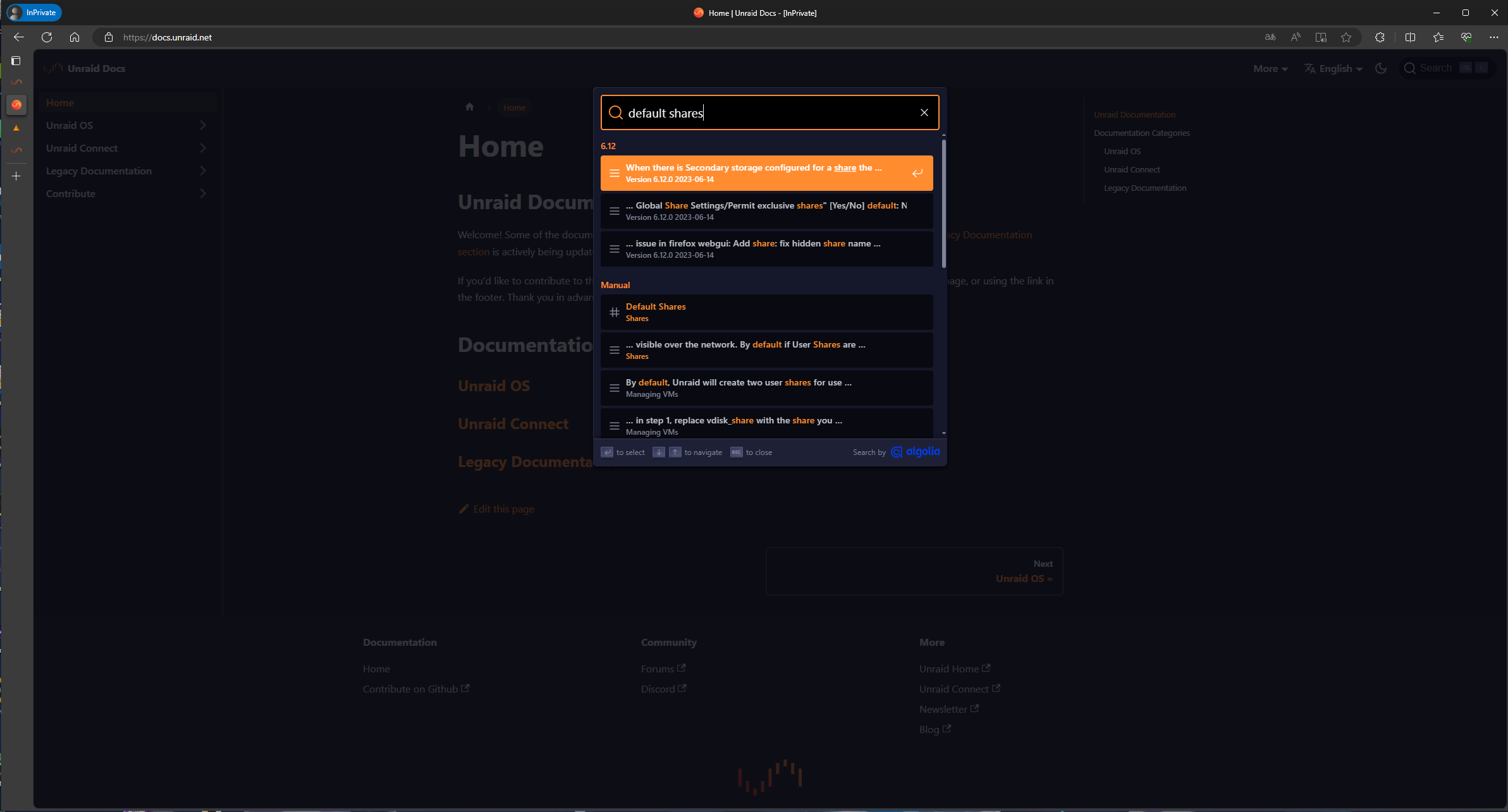

378882889_DesktopScreenshot2024_02.15-11_31_42_54.thumb.png.707599197e63b687c5764e11d8bc7933.png876885310_DesktopScreenshot2024_02.15-11_31_49_09.thumb.png.ee9469d437bc3b58c5c9e70525446cd4.png
Ok figured it out its a geo block on my router (get around it if I use a VPN) which means the search servers are in russia or china or the IPs have appeared in a block list.
