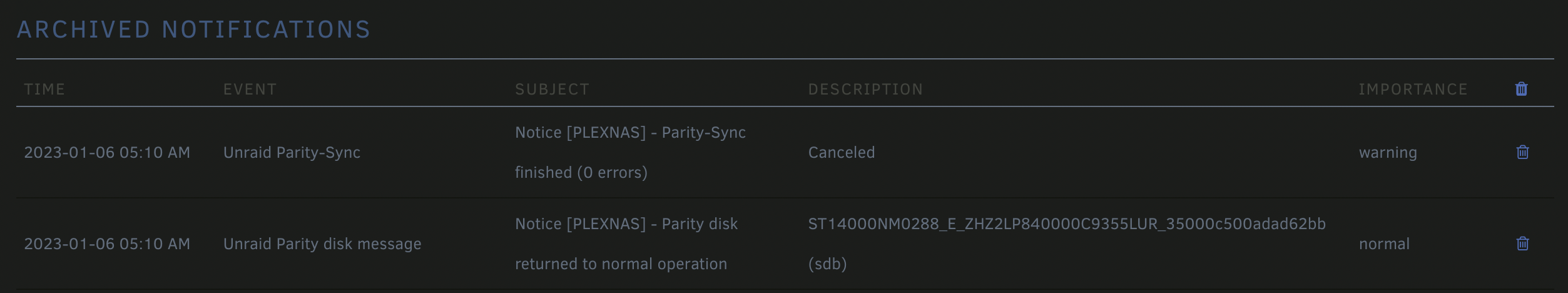

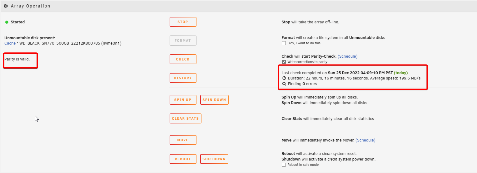

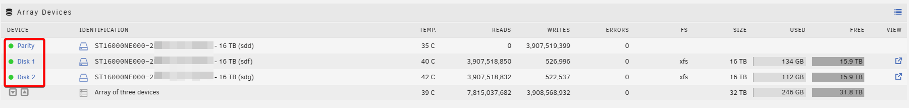

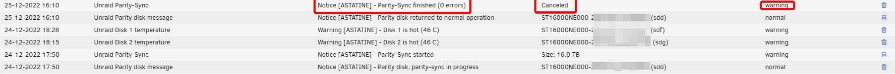

December 26, 20223 yr After a fresh install, parity-sync started yesterday. It took around 17 hours for it complete. I left it go on overnight. When I came to check today. I had this notification waiting for me saying 'Parity-Sync finished' however, it was colored yellow which is for warnings. On further checking in archived notification is find that the description of said notification is 'Canceled'. I don't understand why it is this way. I never canceled the sync. Additionally, the device status says operation normal under 'Array Devices' section and 'Array is valid' under the 'Array Operations' section. Does the 'canceled' description mean I have sync again? Archived Notifications: Array Devices section: Array Operations section:
December 26, 20223 yr Author @trurl Here are the Diagnostics. I started 'Parity-Check' just to be safe and its notification also came as 'warning'. You can see in the screenshot above too. The notification from when 'Parity-Sync' started, its description is also 'Warning'. Maybe notifications about any action related to parity come up as warnings, what do you think? astatine-diagnostics-20221225-2252.zip Edited December 26, 20223 yr by Astatine

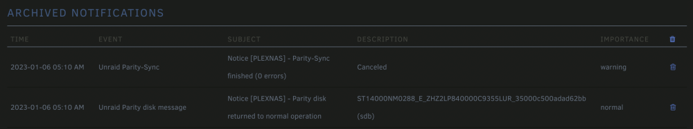

January 6, 20233 yr I had this happen as well and was confused by it. It was my first parity sync on a new array, FWIW. It appears to be healthy and in-sync, but seeing a warning that says "Canceled" instills a tiny bit out doubt. Attached diagnostics. plexnas-diagnostics-20230106-0627.zip
January 6, 20233 yr Community Expert Solution Jan 5 09:50:20 PlexNAS kernel: mdcmd (61): nocheck cancel Jan 5 09:50:20 PlexNAS kernel: md: recovery thread: exit status: -4 Jan 5 09:50:39 PlexNAS kernel: mdcmd (62): check correct Jan 5 09:50:39 PlexNAS kernel: md: recovery thread: recon P ... Jan 6 03:40:01 PlexNAS crond[1122]: exit status 1 from user root /usr/local/sbin/mover &> /dev/null Jan 6 05:09:29 PlexNAS kernel: md: sync done. time=69530sec Jan 6 05:09:29 PlexNAS kernel: md: recovery thread: exit status: 0 Looks like it was restarted and completed

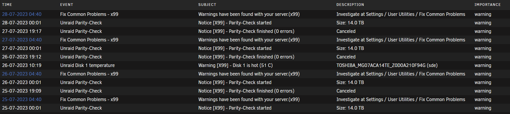

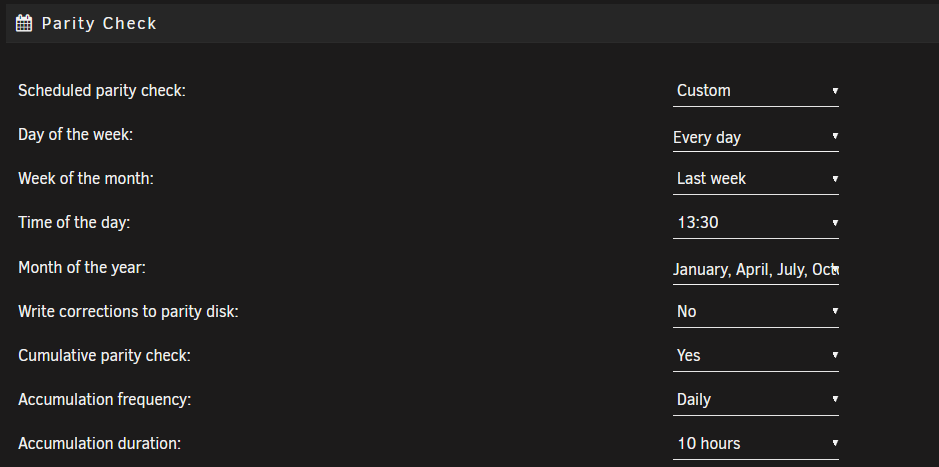

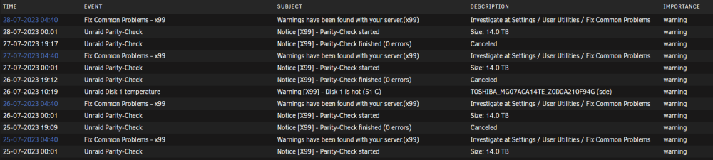

July 28, 20233 yr I have similar problem mine get started and canceled 4 times. and the parity check history shows only two of them. For 4 days my disk was spinning for 19 hrs, i didn't canceled. And the logs doesn't tell anything. x99-diagnostics-20230728-2136.zip PS: So today was the same thing happened.. so after more checking i found where the problem was. Who in the right mind will use "Every day" literally in the context of other settings and the specific task. Here "Every Day" should mean "Any day" - of the "Last week". And interestingly this is the only options that doesn't have an explanation. Edited July 29, 20233 yr by ilarion
