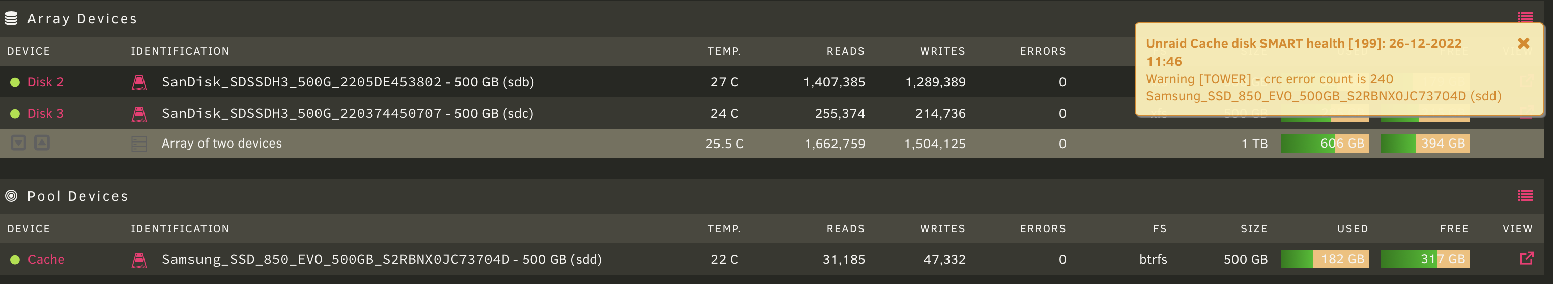

I noticed that the drive on which the cache is located is reporting errors. Could it be related to this?

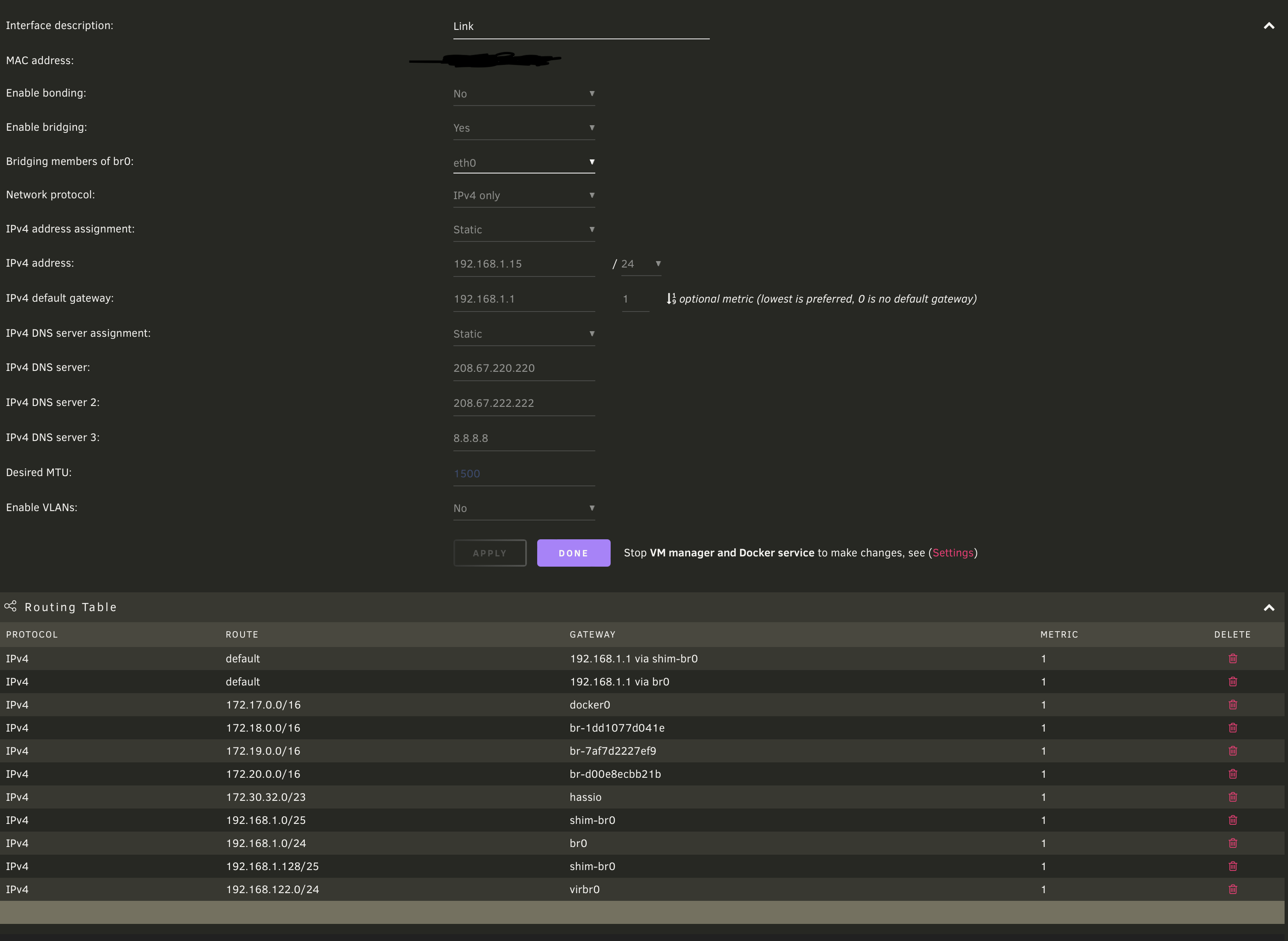

Unfortunately, the internet connection on my server has recently failed again. The VMs have internet, local access also works; however, the Dockers have no internet.

If only the dockers are losing internet access it suggests a problem with the docker network, suggest deleting any custom networks and re-configuring them.
