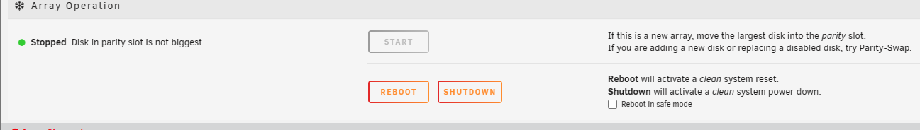

cant swap my parity disk
Hello, I have an array of 6 1tb disks with 2 1tb parity disks
recently one of the two parity disks started reporting uncorrect sectors and I want to go ahead and swap it. unfortunately unraid wont let me swap it, I go through the normal parity swap procedure and get stopped when I try to start the array with the new/replacement disk selected saying "disk in parity slot is not the biggest"
which makes sense, but after checking all of the attributes of all my disks in my array (old parity and new parity included) they all have exactly
1,000,204,886,016 bytes total (I got this from the identity tab in each disk)
the only difference between the old parity and the new parity disk is that the new one is that the new one is a SSD (I know it wastes performance, but I'm fine with it. I'm going to replace the drives in my array one by one with these SSDs)
is it getting hung up on how the SSD doesn't have physical sector size defined or something goofy like that? if so, what do I do to swap it in or force it?

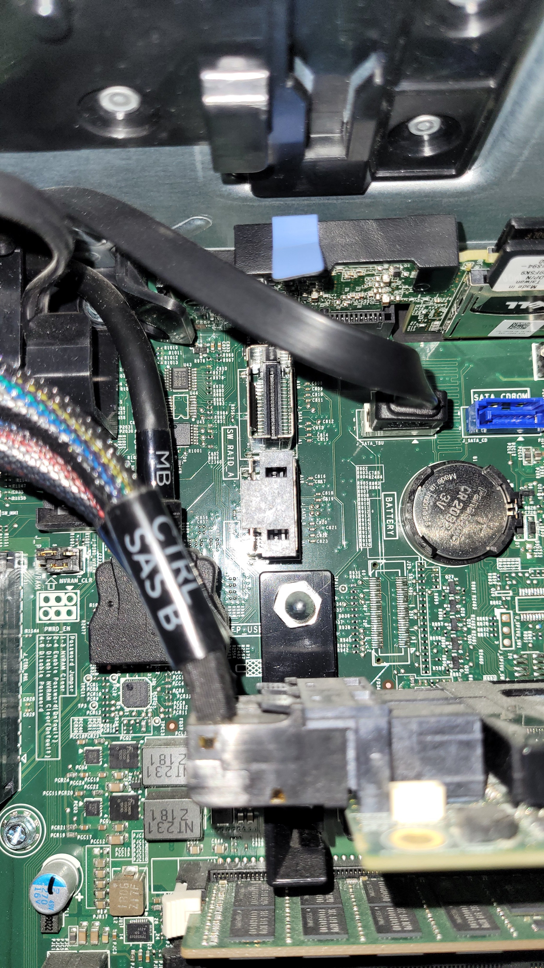

nevermind, I'll have to use the RAID card no matter what. the backplane does use 2 Mini Sas connectors to connect to the SAS/RAID card but the motherboard's "SW_RAID_A" and "SW_RAID_B" ports are something I'm not familiar with. I attatched a picture of them in the center/top portion of the image with the SAS/RAID card in the bottom/right portion of the image (just for reference)
I'll see if I can access the RAID settings for the controller from BIOS

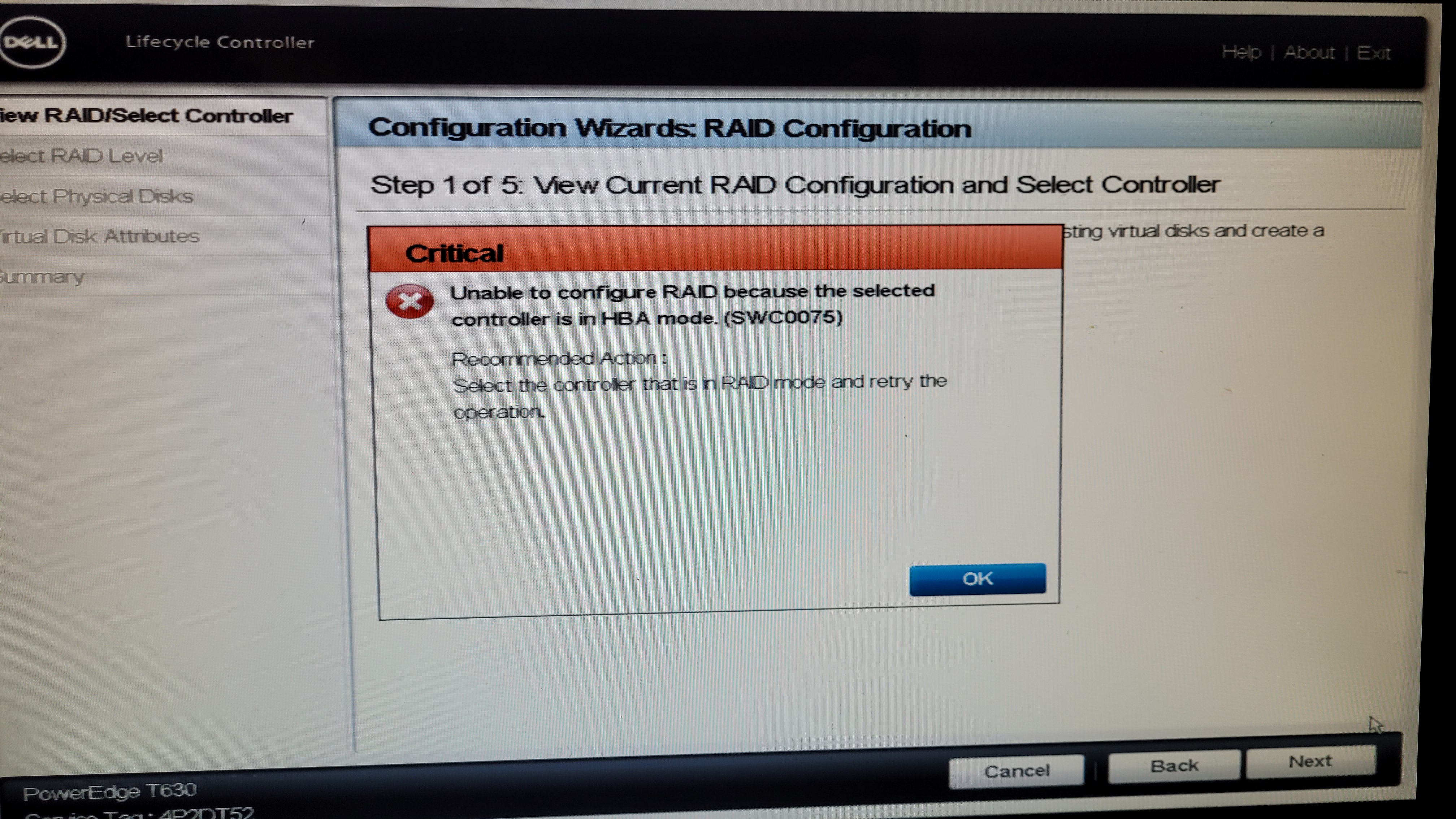

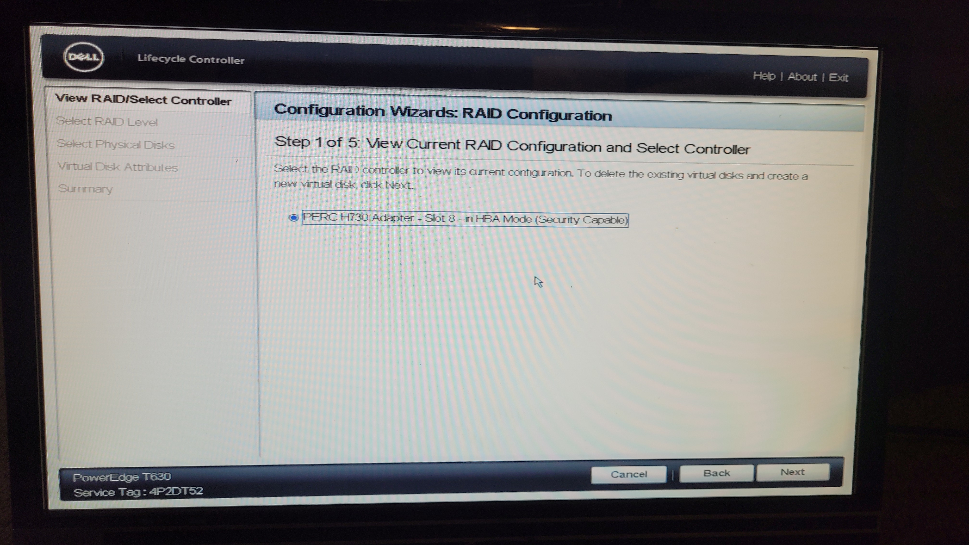

one final addition to the thread for the night. this was all I could find in the BIOS
trying to configure the Hardware RAID at all gives this error saying its not in RAID mode
looking at the controller, it says it's in something called HBA mode. looking in the normal BIOS stuff it says my options are ATA mode ACHI mode and RAID mode. Its been in ACHI mode & I intend to leave it there / that's what makes sense anyways right? that's modern SATA
all of this is to say
the RAID portion of the card is not enabled or in use at all
its just passing everything through and treating them like normal SATA devices instead of parts of a Hardware RAID array
which unfortunately doesn't help me
