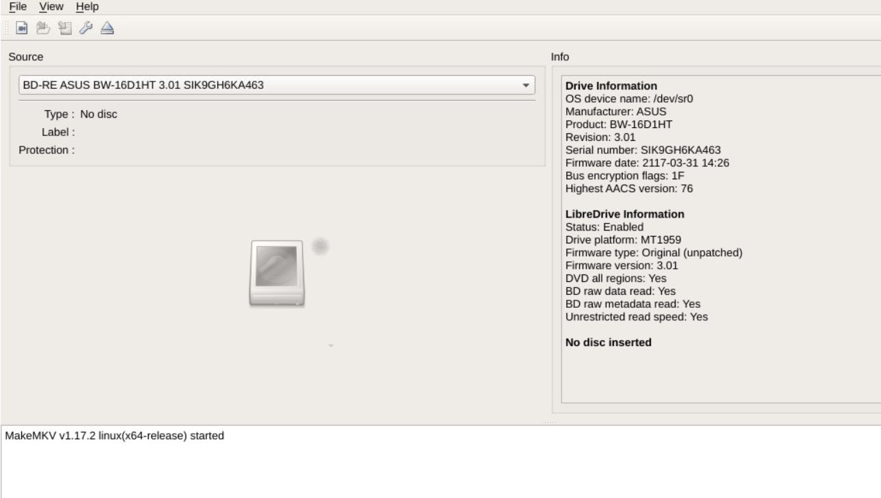

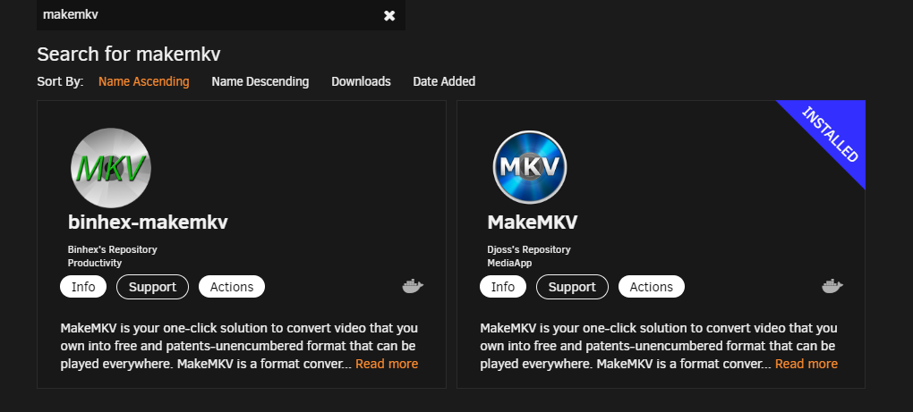

I rip my DVDs/Blurays/4k Blurays for use in Plex using the Makemkv docker container.
Thank you for the advice, however it just gives me a "The program can't find any useable optical drives" error message. Any suggestions?

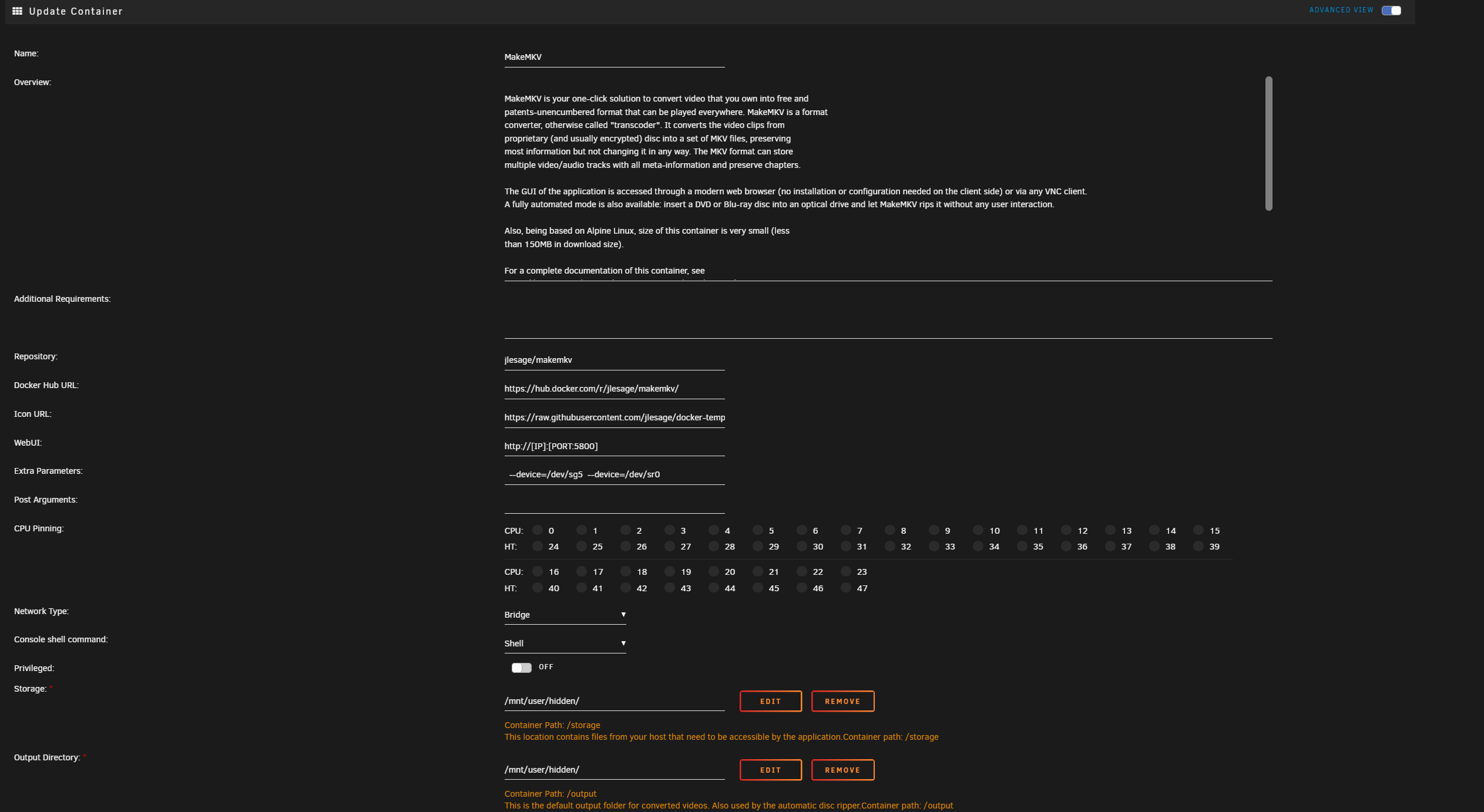

Edit the docker, and change to advance with the slider button top right.
in the extras field you need to set the devices.
to find the sg name run
root@unraid:~# lsscsi -g | grep /dev/sr
[6:0:0:0]    cd/dvd  ASUS     BW-16D1HT        3.01  /dev/sr0   /dev/sg5
root@unraid:~#
I have two drives but the USB one is not connected the sr1 so for my asus drive I would need to set   --device=/dev/sg5 --device=/dev/sr0
You need to have both.

Sadly when I went and added the devices manually, it still says it can't find them in both MakeMKV and binhex-MakeMKV.

Did you try the extra parms?
image.thumb.png.2d78bdead28d94c1aebea4cb97eaf711.pngimage.thumb.png.6da0dd38ed599a447497d1168e6b953a.png
That's what I did wrong. The instructions said to "add" the devices, so I was literally adding them as new entries. But, fixing that problem, I still get the same message.

so you need sr0 and sg3 in the docker config.
Me realizing I was typing sg0:
And that was the entire issue. My own stupidity. Thank you so much for going through everything with me. I have no other way to watch DVDs and my servers aren't configured to handle much more than hosting and storage. So this is a life saver. Thank you again.
