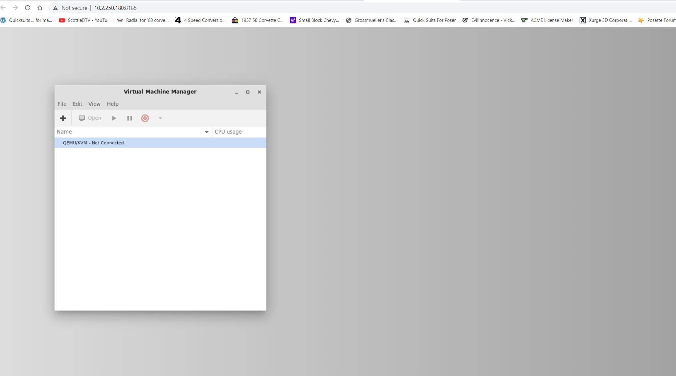

When I launch the VM Docker and access it via the webgui, I get these errors.
QEMU/KVM NOT CONNECTED

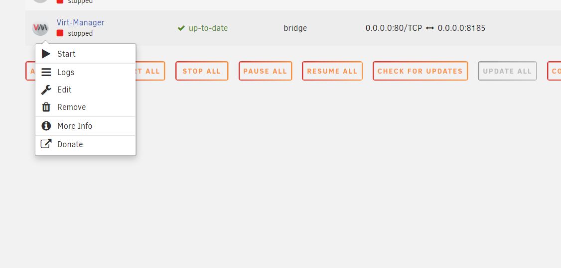

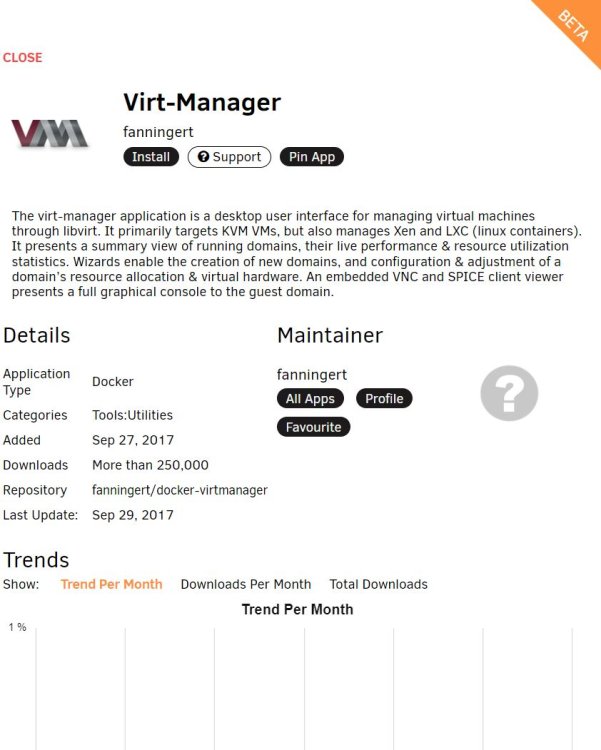

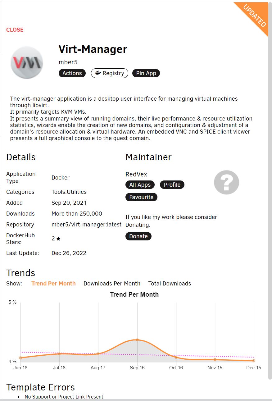

When I click the icon I get this. I do not see "support"! Do you?
More Info takes me to the docker page.
All my other dockers do have a support option but Virt0Manger does not.

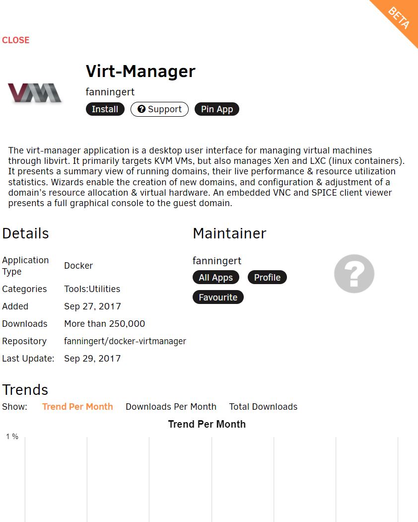

That is correct. The BETA version has a support icon but was last updated Sep 29, 2017.
However the production version last updated Dec 26, 2022 has no support icon.

I noticed there was an update "Dec 26, 2022" for Virt-Manger. I installed the update and it did not resolve my issue nor is there a SUPPORT option.

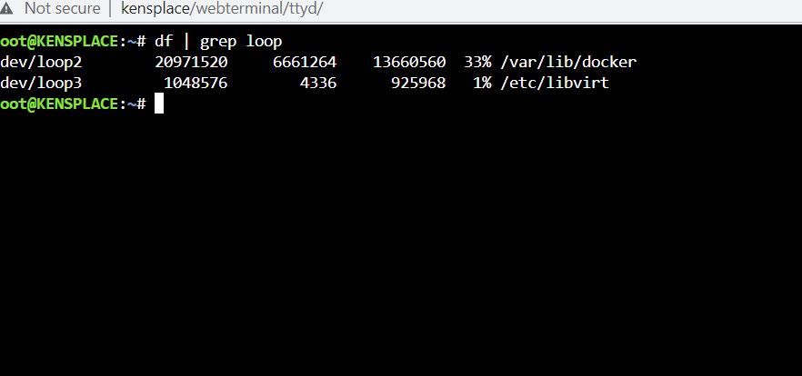

Sounds like there is an issue with the image file.
/etc/libvirt is a mount point and the image file from the system share is mounted here.
does the following show your image is mounted
root@unraid:~# df | grep loop
/dev/loop2        62914560     7337288    53973368  12% /var/lib/docker
/dev/loop3         1048576        5224      924856   1% /etc/libvirt
root@unraid:~#

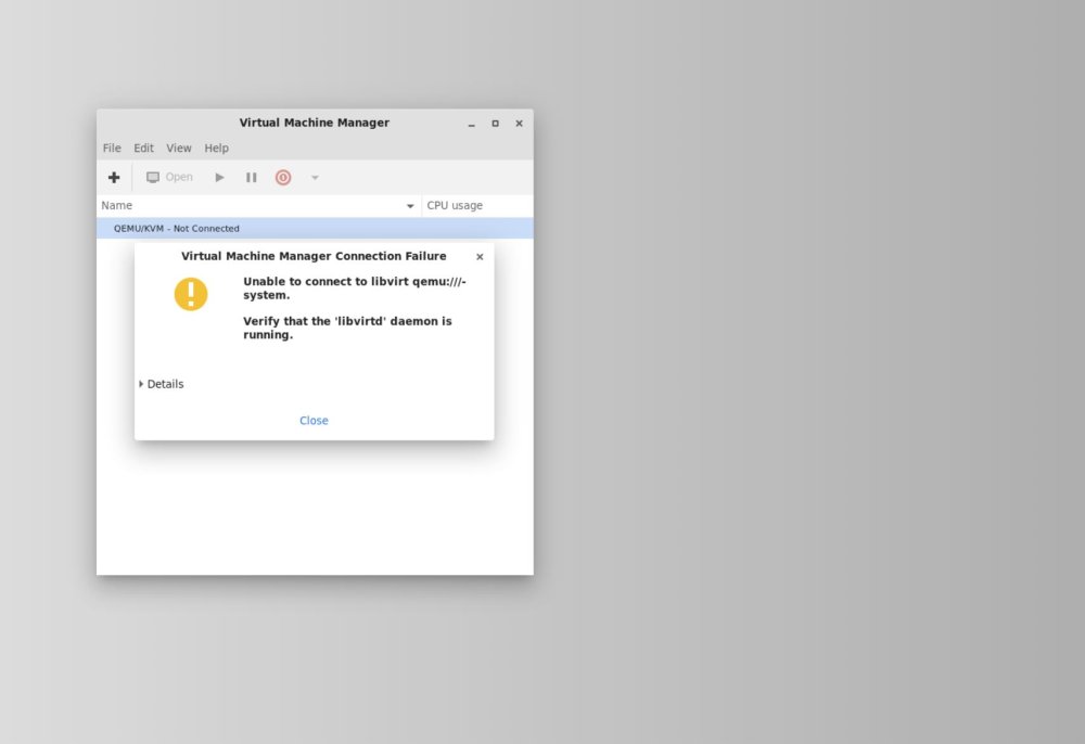

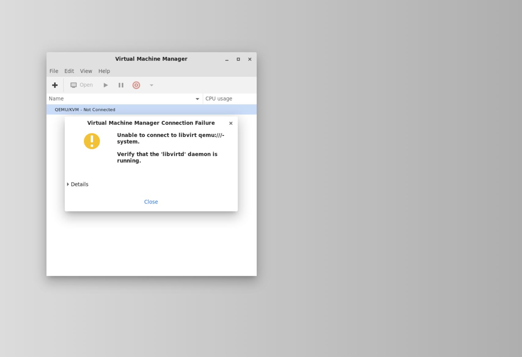

However Virt-Manager will not launch.
I get the attached error.

Executing df | grep loop
reports the attached screen capture...
