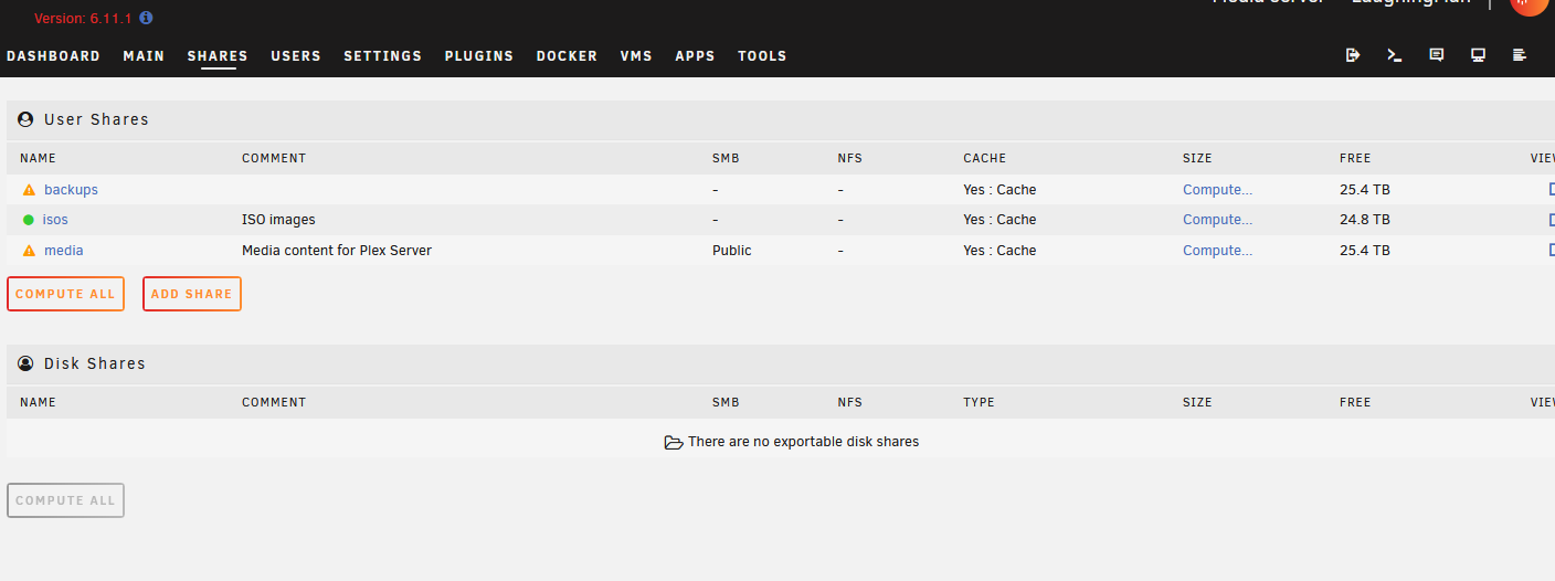

My shares continue to disappear after a couple of hours within the Web GUI. (screen shot attached)
If I go to my Cache, the shares are displayed but if I go to my Shares tab, those same shares are missing. This is causing my dockers to have access/permission errors and become useless.
A reboot will resolve the issue, for a couple hours at best.
Any help would be very appreciated. Thanks in advance.

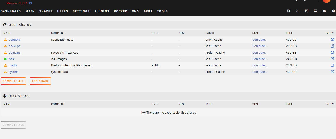

HI
I seem to have the same issue with the disappearing shares.
I ran the check Filesystem with -n parameter which was there ans got the result in the screenshot.
Can anyone help what should I do ?
