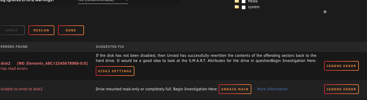

Fix common problem alerted me that i have a problem with disc2 in my array. I  looked a possible problems  however i unable to find the culprit. I have flowed  the Spaceinvaderone video for a possible cause regarding full disk.  for a few weeks now i have not been able SMB into my appdata file as it stated that the Appdata Original file is missing. I have not been able to find a solution to reinstate it as this could be my problem? I have included  diagnostics and  screenshot of the error.

No SMART report for disk2 in those diagnostics.
USB drives are not recommended for array or pools due to many reasons, including unreliable connections.

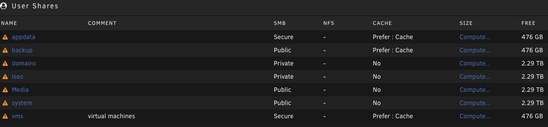

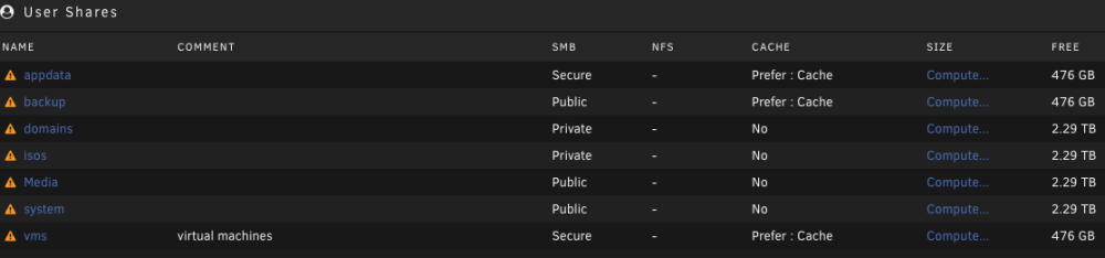

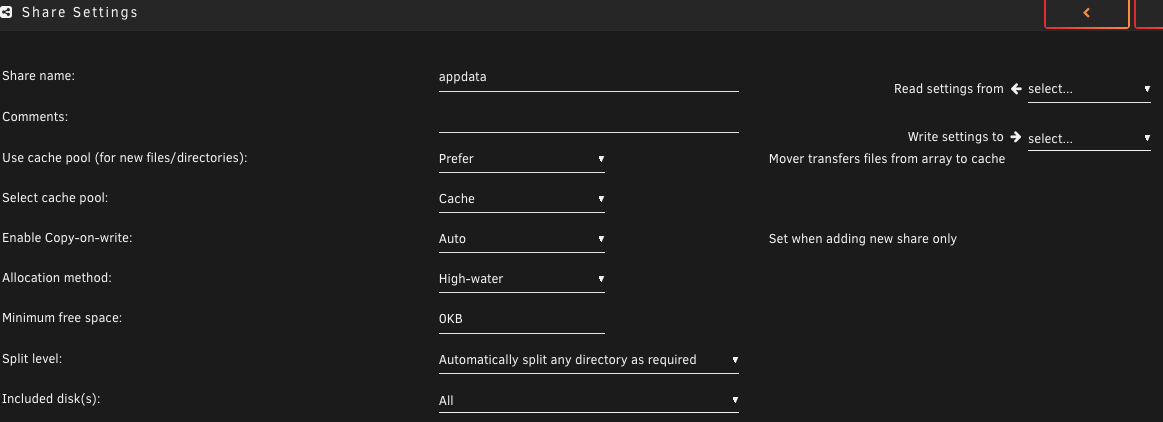

Hi I have tried the above without success.  Could you advise/help on the following which i have found regarding my appdata folder in unRaid. After looking at  Spaceinvaderone videos in setting unraid and dockers847912129_Screenshot2022-12-29at08_45_28.thumb.png.964eec17ae6a9de428455c9f335096b8.png2076975988_Screenshot2022-12-29at08_44_31.thumb.png.5cd12355f5e4332584ddbd66604f2633.png294510841_Screenshot2022-12-29at08_43_51.png.4eeb820d6c9453e4729a2493fdca9bc1.png  i do not think my unraid configuration is not setup correctly my shares does not show the content of  appdata  with the dockers  the other folders are the same. Yet i  can find the /mnt/user/appdata on the terminal.  Can i reinstall new unraid OS and restore the docker containers as these have been backup with the CA Backup.

Do you mean you don't see them on the network?

Yes, however i installed unraid on a trial key and it reconfigured it now i can see  everything on the network  thru macOS/windows. Only problem is that i cannot edit the templates as the edit option has disappeared. Any ideas what i do  see below screenshot.
