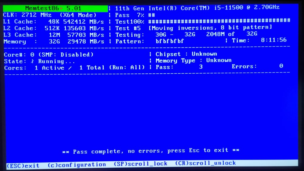

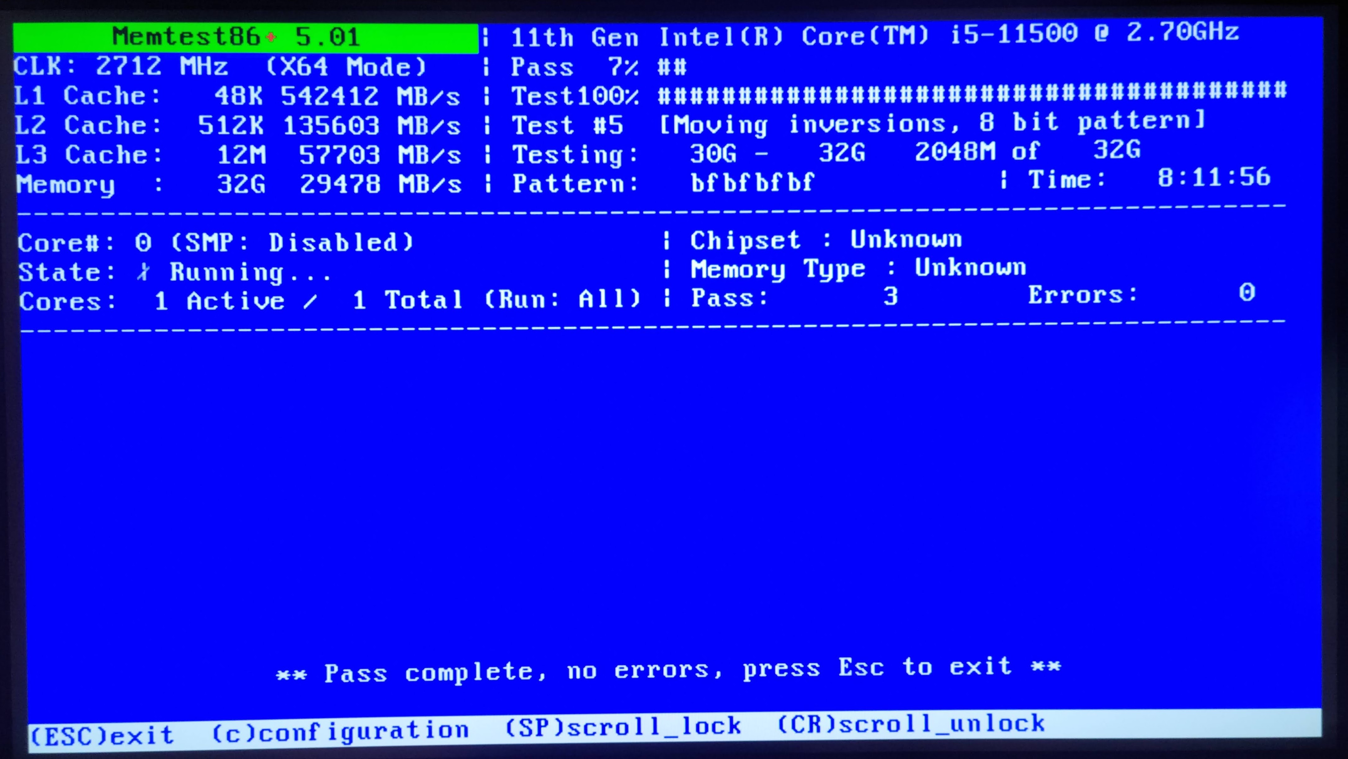

No known hardware issues, start by running memtest.
memtest ran over night. Stilling running. will try to keep it running until later today
Edited by cmalec
made another 4th pass still no errors. exited and booted back up Unraid.
