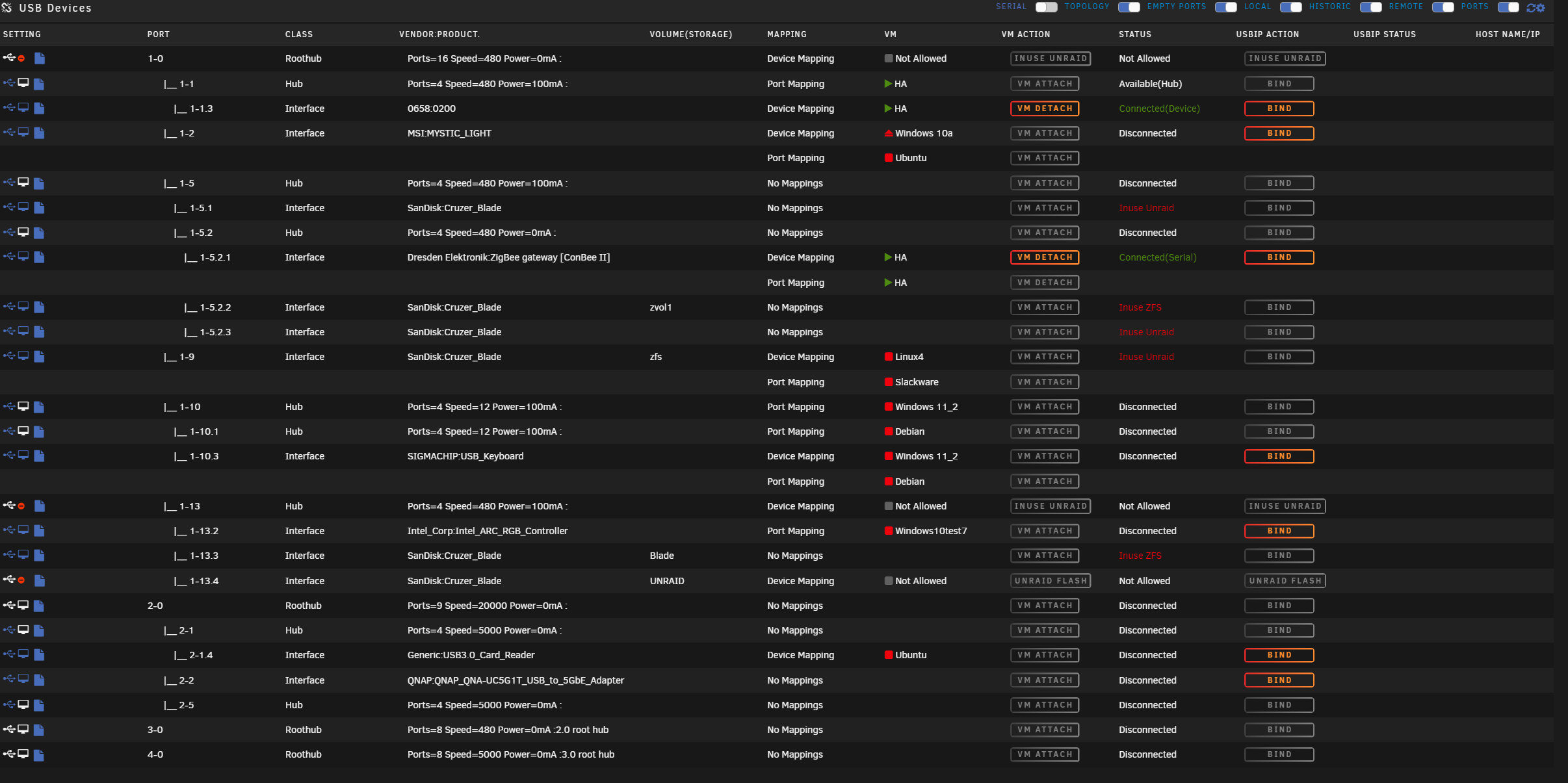

connect then the usb ports to the vm after i swiched the kvm
My usb manager plugin will allow auto conmect.
Hmm, may i try then a other way. What plugin do you use?
Does the Plugin "remember" the usb device? Because aslong as the kvm is swiched to the main pc the usb devices are not connected to Unraid.
Edited by Kasjo
https://unraid.net/community/apps?q=usb+manager#r

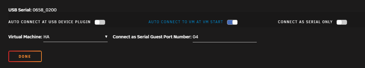

Yes you can setup by device ID or port. You can also enable hubs.
You have options for hotplug and vm start.
Edited by SimonF
I try this way then. Thx mate.
Works perfectly. Thx Mate :)
