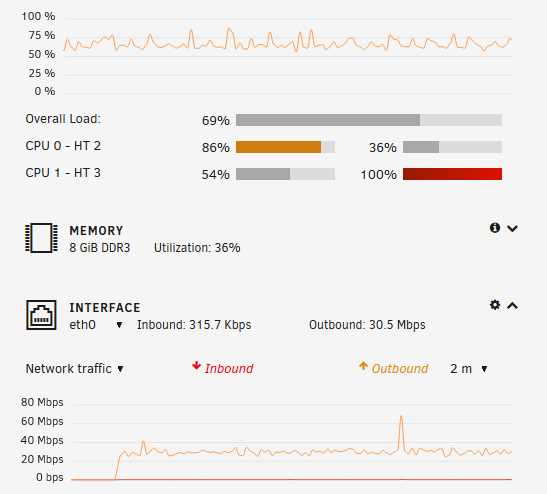

However I am running FoldingAtHome Docker and its settings means that my CPU is running at 66% to 80% and it was still streaming three streams without a problem.  When I tested with FoldingAtHome paused, there was still no problem.
I am still wondering why you have tested to see if you can stream from Unraid to a windows PC.  (OR don't you have a stand alone PC...)
PS--- Multi-layer can work fine if one pays attention to the connection link between the layers and carefully evaluate the potential for that link to a choke point for data transfer.  My Gb home LAN actually has three layers and it works flawlessly for what I want to do.  Maximum speed required on the bottom layer is 100Mb/s. Max speed required for the layer choke point/link-cable is 200Mb/s.  From the Primary (layer 1) switch (16 ports) to the router speed requirement is 300Mb/s (My Internet ISP's download speed).  The reason for layer 2 and 3 is that they are on a separate floor and separate rooms. The floor and rooms have only one cable between them that the up-link port.
Edit: Here is a screenshot of the current running system with one HD stream:

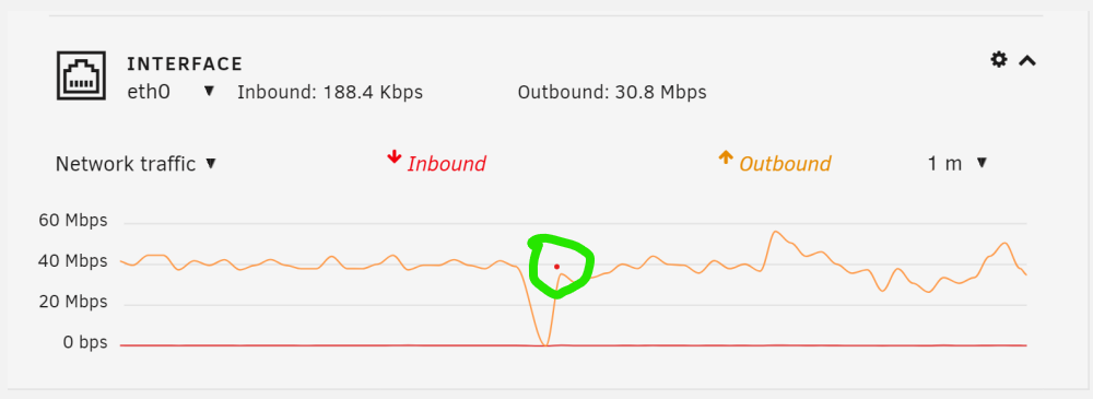

Just realized something. (Noticed it yesterday but it didn't register...)  Look at this screen capture from your post from about eighteen hours ago:
Notice that red dot (that I circled in green)  That is the data rate of the incoming traffic.  It occurred at the same time as the outgoing traffic resumed.  I would suspect that somewhere on the network, packet transfer was suspended for a period of time.  That burst was the stored packets being transferred to your server when the suspension was lifted.
I would suspect that those packets came from your NEO requesting data packets (each packet would be less than 1500 bytes of data) from.   There is storage on the network itself. (How else can a Gb/s stream be sent to a device that will only receive 10Mb/s.)   It looks like the Neo is working properly so the problem must be elsewhere.  The problem could be in the Unraid server hardware or it could be somewhere in the LAN hardware. (Personally, I would reboot all of the LAN hardware, switch the server cable to another switch port, swap out the cable between the server and switch, and even try a new NIC card in the server as a last resort.)
