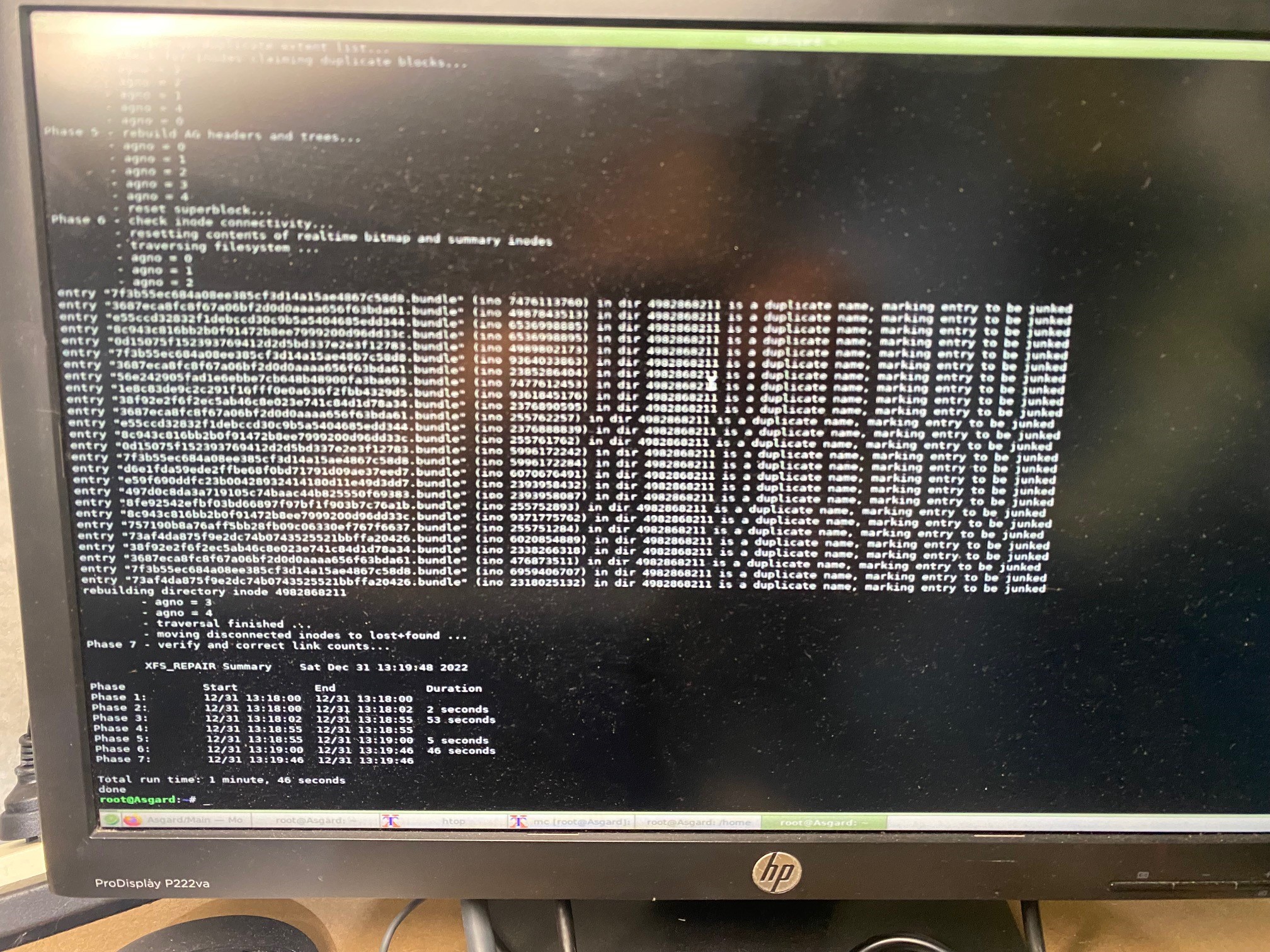

December 31, 20223 yr Author o I worked out how to do it. but each time I run repair, the photo you see attached comes up. it finishes, but if you run it again, you get the same result. I ran it a couple times and restarted the array, but still have the same issues with getting to the web server. It says it is repairing it? but seems to not be? David

January 3, 20233 yr Author Hi Jorge finally got it to transfer to usb stick. cant access it via network or SSH etc. here is diags many thanks David asgard-diagnostics-20230103-1035.zip
January 3, 20233 yr Community Expert Disk1 is mounting and so far there aren't any fs issues logged, do contents look correct?
