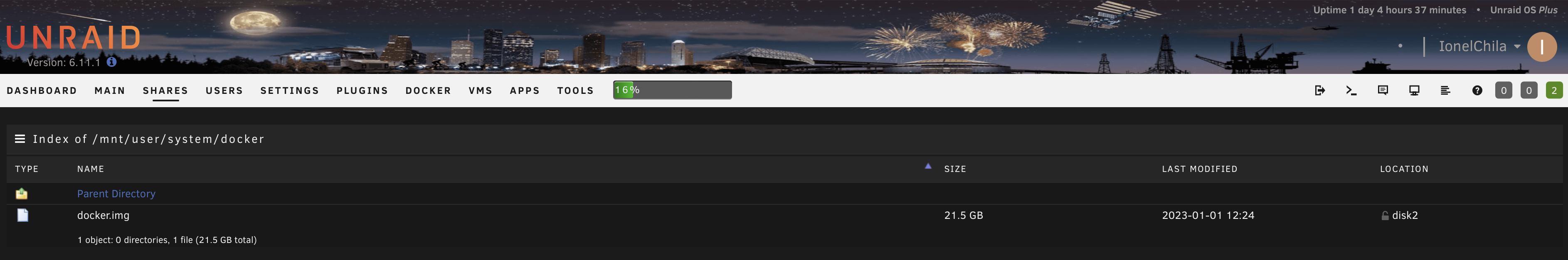

Despite my "System Data" share setup as Prefer : Cache for some reason when the dockers starts, the docker.img always ends up on the array disk 2 rather than the cache / pool ssd drive. I have 2 perfectly identical UnRaid boxes and one works and the other doesn't.  How do I prevent the docker.img to start and stay on the array drive?  I tried everything,  stop dockers, kick off mover, done a full parity check, you name it. No matter what I do it just stays on the array disk :(
1880198277_Screenshot2023-01-01at4_14_15PM.thumb.png.236875dce3a8283d6e06cb3df9c7625f.png

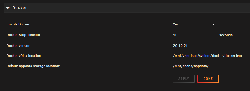

In Settings --> Docker what is your path to docker.img?  In my example below vms_isos is a named cache pool SSD other than Cache (which also exists)

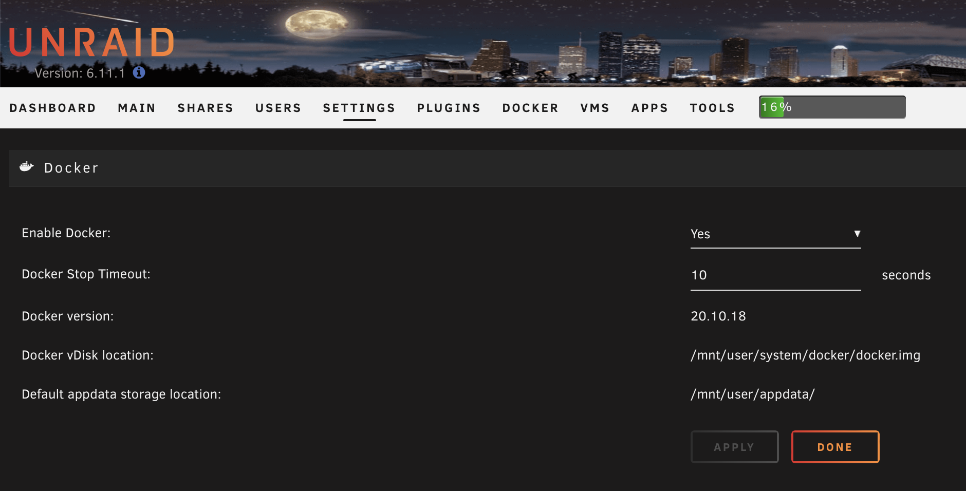

This
791267616_Screenshot2023-01-01at5_42_38PM.thumb.png.30b5c16c7bf0c9204690e4e0e111817a.png
Never mind. I just blew the docker.img file, recreate it and reinstall all the apps.  That fixed and all back to normal now.
