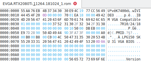

Thank you for the response. Still no luck, just a black screen. Also, having a vBIOS gives me this error:
2023-01-02T16:49:06.327152Z qemu-system-x86_64: -device {"driver":"vfio-pci","host":"0000:01:00.0","id":"hostdev0","bus":"pci.0","addr":"0x5","romfile":"/mnt/cache/appdata/domains/EVGA.RTX2080Ti.11264.181024_1.rom"}: Failed to mmap 0000:01:00.0 BAR 1. Performance may be slow
I did remove the header with a hex editor:
Any other suggestions?

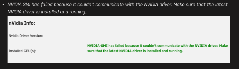

Ok, turns out the video card is having issues. I was getting this:
I took the server down, reseated the card and now it's no longer seen in the BIOS or listed in the IOMMU groups. Going to RMA it and then I'll try this again. Thanks for your help.
You could look up your card on https://www.techpowerup.com/vgabios/ and find your bios there.
Maybe something went wrong with your vbios dump?

I didn't dump my own, that's where I got the vBIOS file from.
I'll try it again once I get the card back. Thanks.

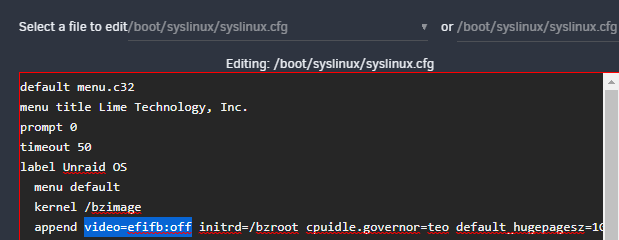

This is usually because the gpu is not properly isolated, efifb may be the culprit, search this forum for fixes.

It should be better to dump your own, if possible, otherwise make sure that what you are downloading is the vbios for your exact model, then check and remove the nvidia header.

And @ghost82 suggestion, edit /boot/syslinux/syslinux.cfg and add 'video=efifb:off' after 'append', like this:
And see if this helps.
I am 100% sure that I have the correct BIOS file and I did the header per SpaceInvaderOne's video. Can you elaborate on not properly isolated? If it is bound, that is the only criteria for isolation, correct?

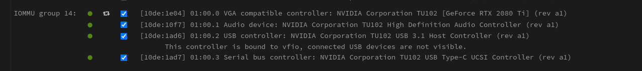

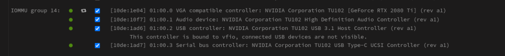

This is from system devices:
I searched the forum regarding efifb, and all I found was people inserting it into their syslinux.cfg, which doesn't seem to work for me. Let me know if there is anything else I could provide that might shine more light on things. Thanks!
I don't have  HyperV enabled (per the video on unRAID's gaming VMs home page), so there is no section to add that to.
I had to remove that line from my syslinux.cfg. After adding it and restarting, I couldn't get my server to boot up past that modified line.
I apologize, I just found another post by @ghost82 that says you won't see any output on the screen once that line is processed. I did not know that. I will add it back and try again.
We have success! That one line in the config fixed it. Thank you folks so much for your help!
