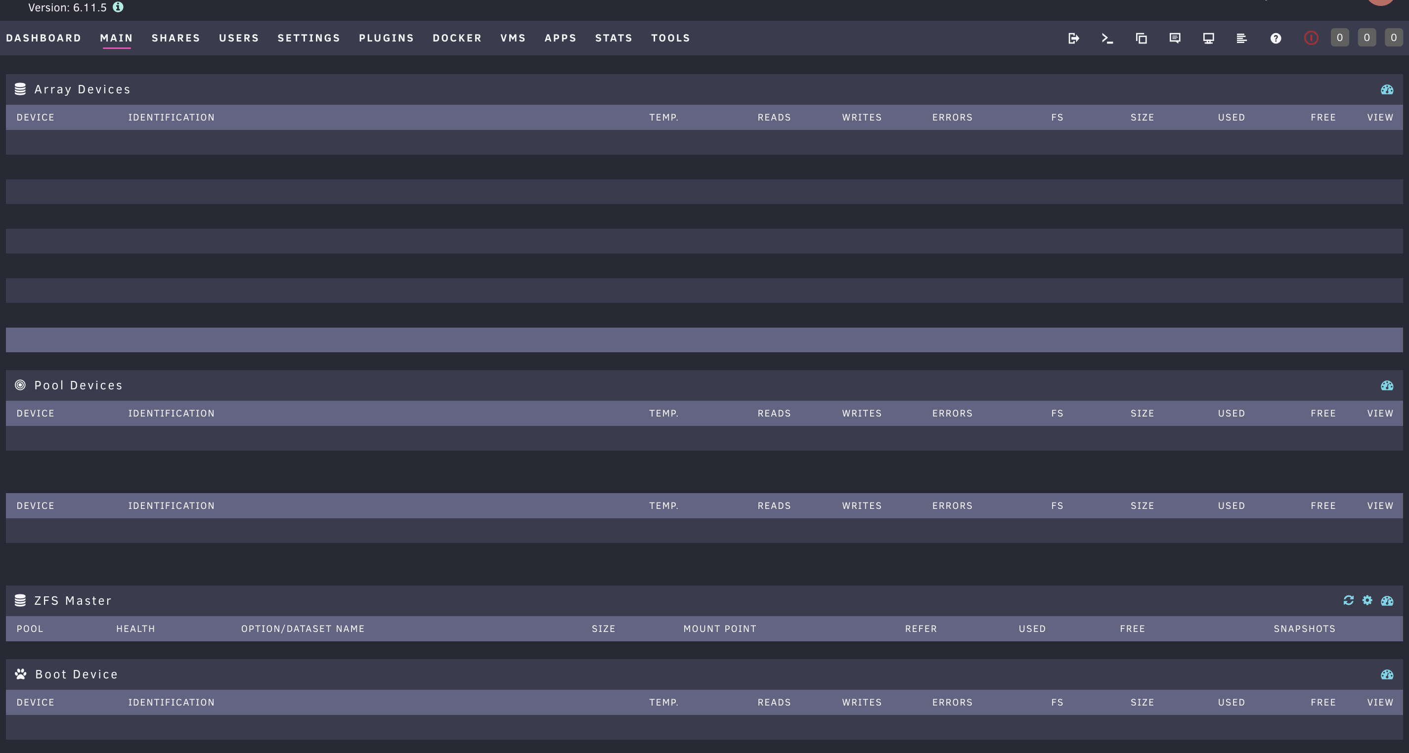

My unraid server web UI is suddenly broken. seems the php resources are failing to load with this error
Searching for mccloud/ps3netsrv:* Not FoundSearching for unRAIDServer.plg Found Looking for conditions Testing unraid version 6.11.5 >= 6.6.0 Passed Testing unraid version 6.11.5 <= 6.8.0 Failed Conditions not met. Do nothing! Searching for disklocation-master.plg Found Looking for conditions Testing plugin version 2022.06.18 < 2020.02.23 Failed Conditions not met. Do nothing! Searching for community.applications.plg123 Not Found[]
above was from plugins/community.applications/scripts/notices.php

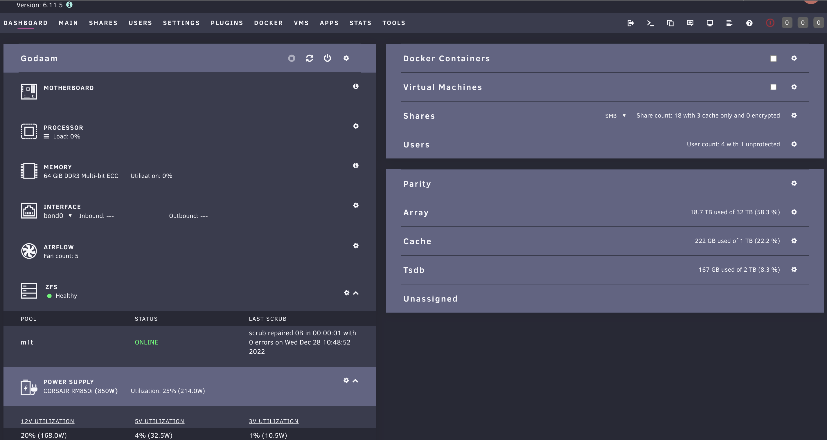

Is this a bad update on plugin, or a sign of something worse? I can ssh into the server fine. A monthly parity check is runnning, so I am reluctant to reboot right now if its just a UI issue. how can I confirm the extent of damage? Trying to get diagnostics hangs from UI
This is what the UI looks like. What are my options to troubleshoot?

What do you get from command line with this?
df -h /
df -h /
here it is
~# df -h /
Filesystem      Size  Used Avail Use% Mounted on
rootfs           32G  1.4G   30G   5% /
also
~# ls -al /boot/config/plugins/community.applications*
-rw------- 1 root root 100057 Dec 30 14:47 /boot/config/plugins/community.applications.plg
/boot/config/plugins/community.applications:
total 240
drwx------  2 root root  16384 Dec 30 14:47 ./
drwx------ 30 root root  16384 Jan  1 23:25 ../
-rw-------  1 root root     17 Oct 29 18:46 accepted
-rw-------  1 root root 127304 Dec 30 14:47 community.applications-2022.12.29-x86_64-1.txz
-rw-------  1 root root    151 Nov 10 23:35 community.applications.cfg
-rw-------  1 root root    153 Dec 30 14:47 notification_scan.cron
-rw-------  1 root root    686 Dec 30 14:47 pinned_appsV2.json
-rw-------  1 root root     13 Oct 29 18:46 plugins_accepted
the php response I posted in first post is a red herring, that seems to be what notices.php does. I did try in an incognito tab as well as on mobile, so the issue is real
I managed to get the diagnostics from command line. attached
godaam-diagnostics-20230102-1209.zip
Edit: seems like nginx is having memory issues, but why would that be?
Jan  2 12:09:46 Godaam nginx: 2023/01/02 12:09:46 [error] 20455#20455: nchan: Out of shared memory while allocating channel /diagnostics. Increase nchan_max_reserved_memory.
there is no memory pressure at system level
Edited by apandey
added investigation details from diagnostics
I restarted nginx via ssh and that fixed it. so, at least have proved that only nginx was out of order
still wondering what the underlying issue is. it will very likely happen again 😬
