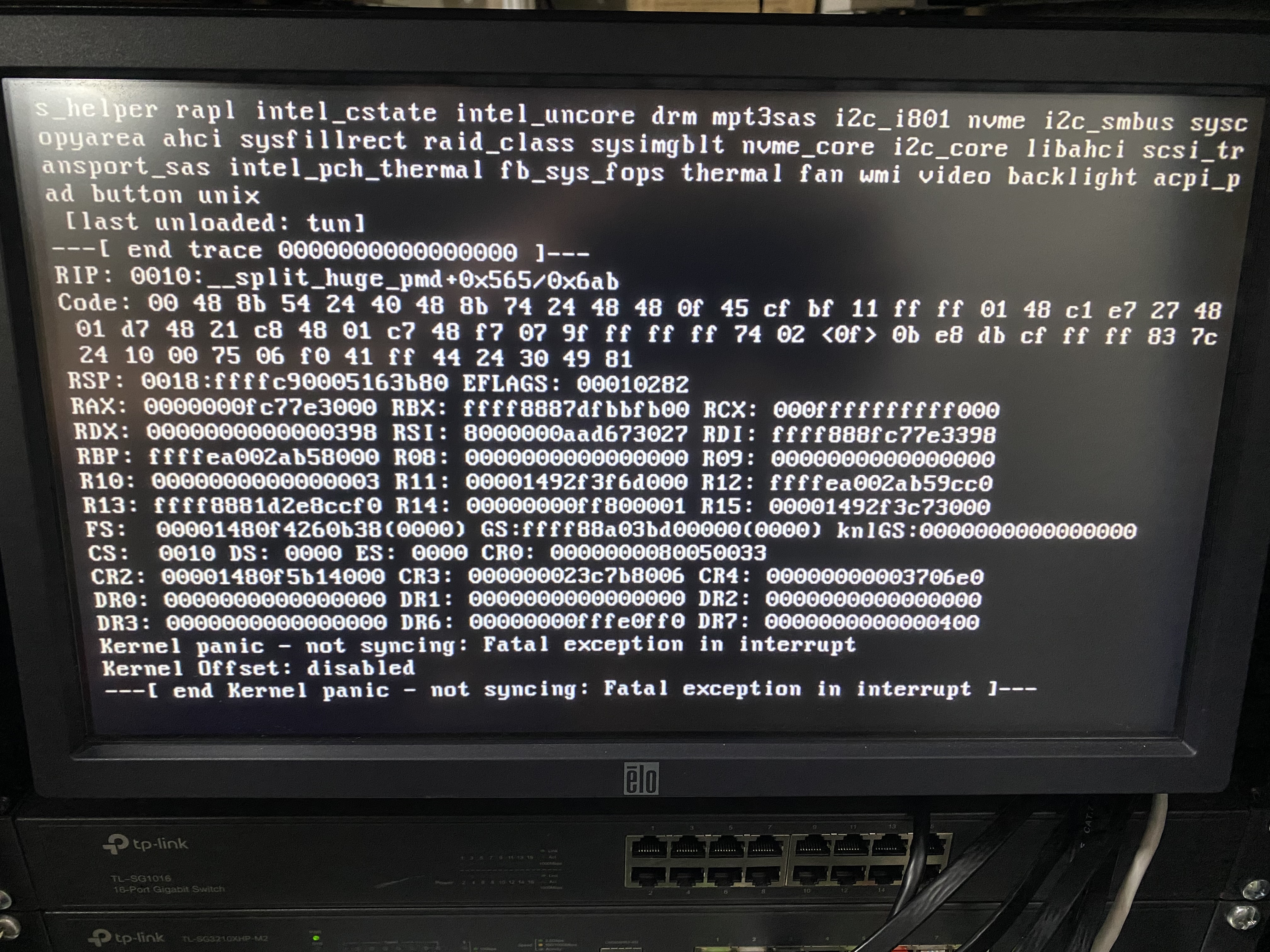

Jan  2 16:01:06 Server kernel: ------------[ cut here ]------------
Jan  2 16:01:06 Server kernel: kernel BUG at mm/huge_memory.c:2154!
Jan  2 16:01:06 Server kernel: invalid opcode: 0000 [#1] PREEMPT SMP NOPTI
Jan  2 16:01:06 Server kernel: CPU: 14 PID: 13614 Comm: .NET ThreadPool Tainted: P    B   W  O      5.19.17-Unraid #2
Jan  2 16:01:06 Server kernel: Hardware name: Gigabyte Technology Co., Ltd. C246M-WU4/C246M-WU4-CF, BIOS F4 02/03/2021
Jan  2 16:01:06 Server kernel: RIP: 0010:__split_huge_pmd+0x565/0x6ab

Woke up to server crashed with kernel panic error on the screen.  Does anyone know what this means?

I think you are probably having RAM issues, but perhaps someone else can chime in.

I was using Mobaxterm over Tailscale.  I hope it's not RAM, thats what I get for not going the ECC route...  :(
