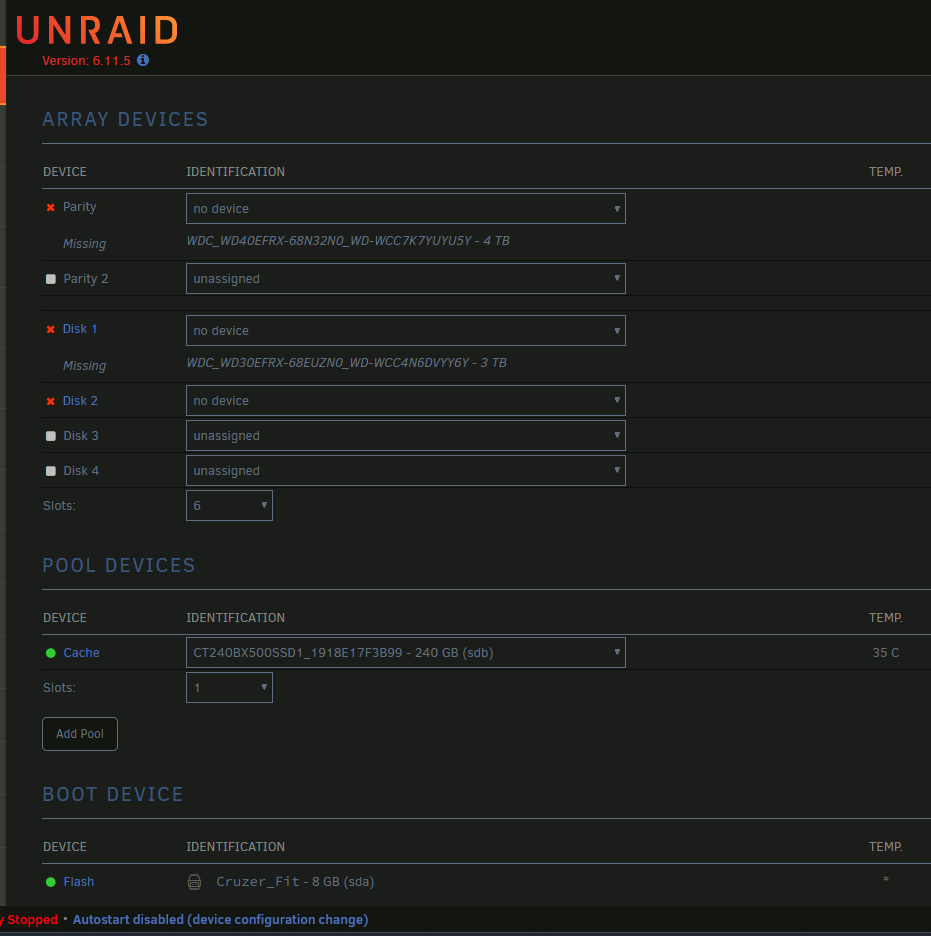

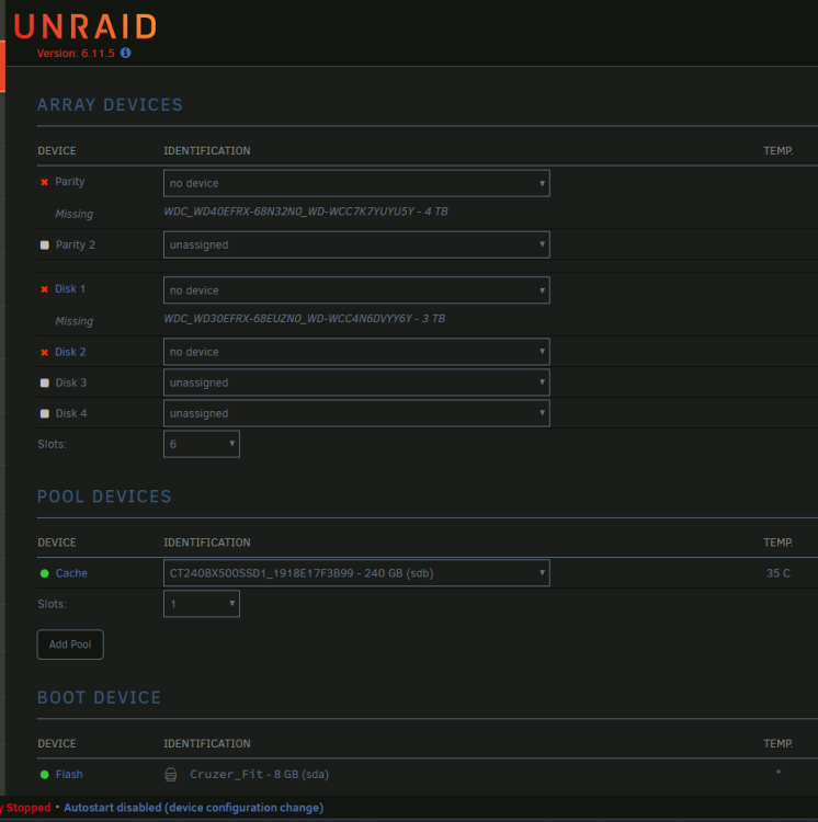

I rechecked all cables including PSU and drives (unplugged, cleaned with a soft brush, re-plugged). This time, none of the disks of the array were discovered at startup! See picture and diagnostics files.
The PSU does make a significant buzzing sound and the server itself makes buzzing sounds that cycle repeatedly every 1-2 seconds. So i rebooted the server again. this second time it did not come online at all (web interface not available)...
i think i will order a new PSU and check again.
David

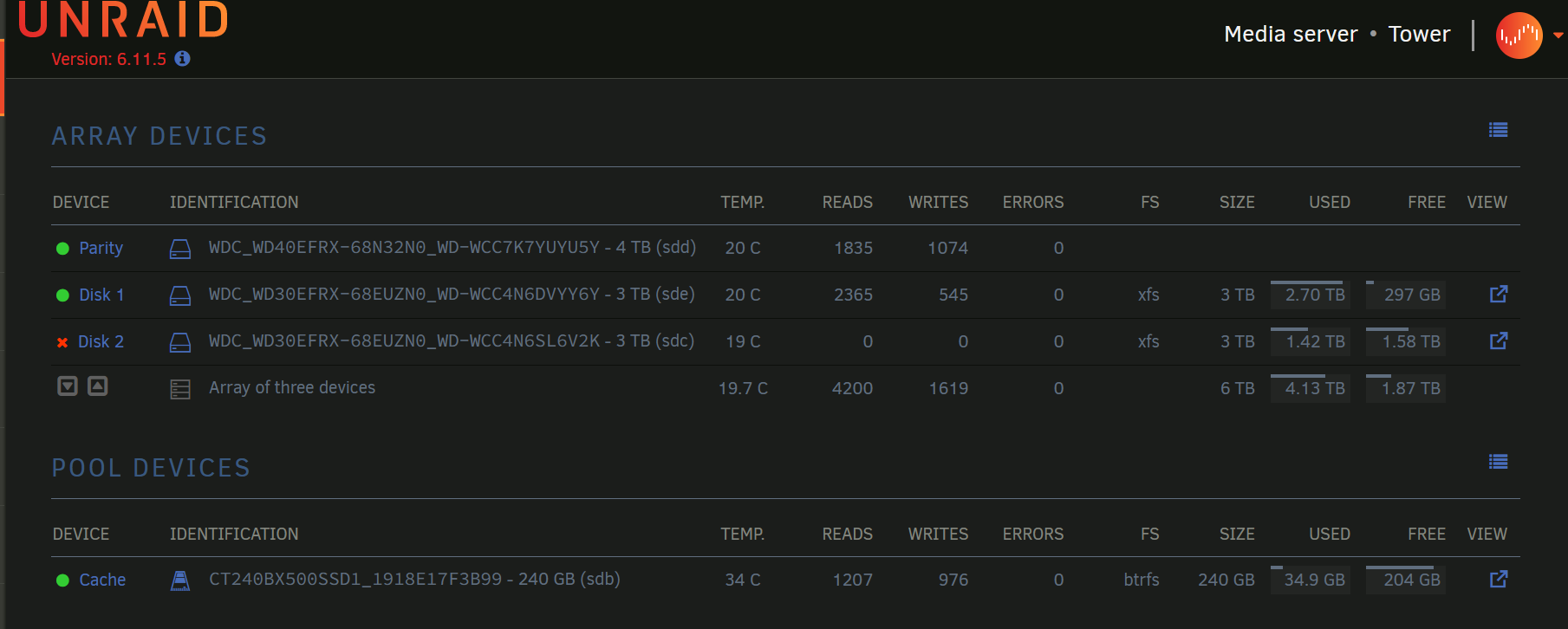

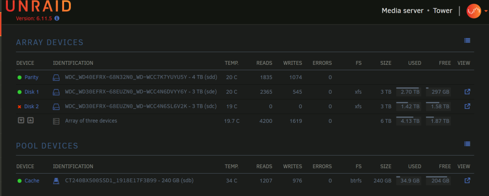

So i plugged in the new PSU and the server started fine. no more buzzing sounds.
Disk 2 is still disabled. The reads, writes and errors counts on the Main page now show 0 each which was not the case before. I attached a screenshot and the new logs.
What would you recommend i do next?
