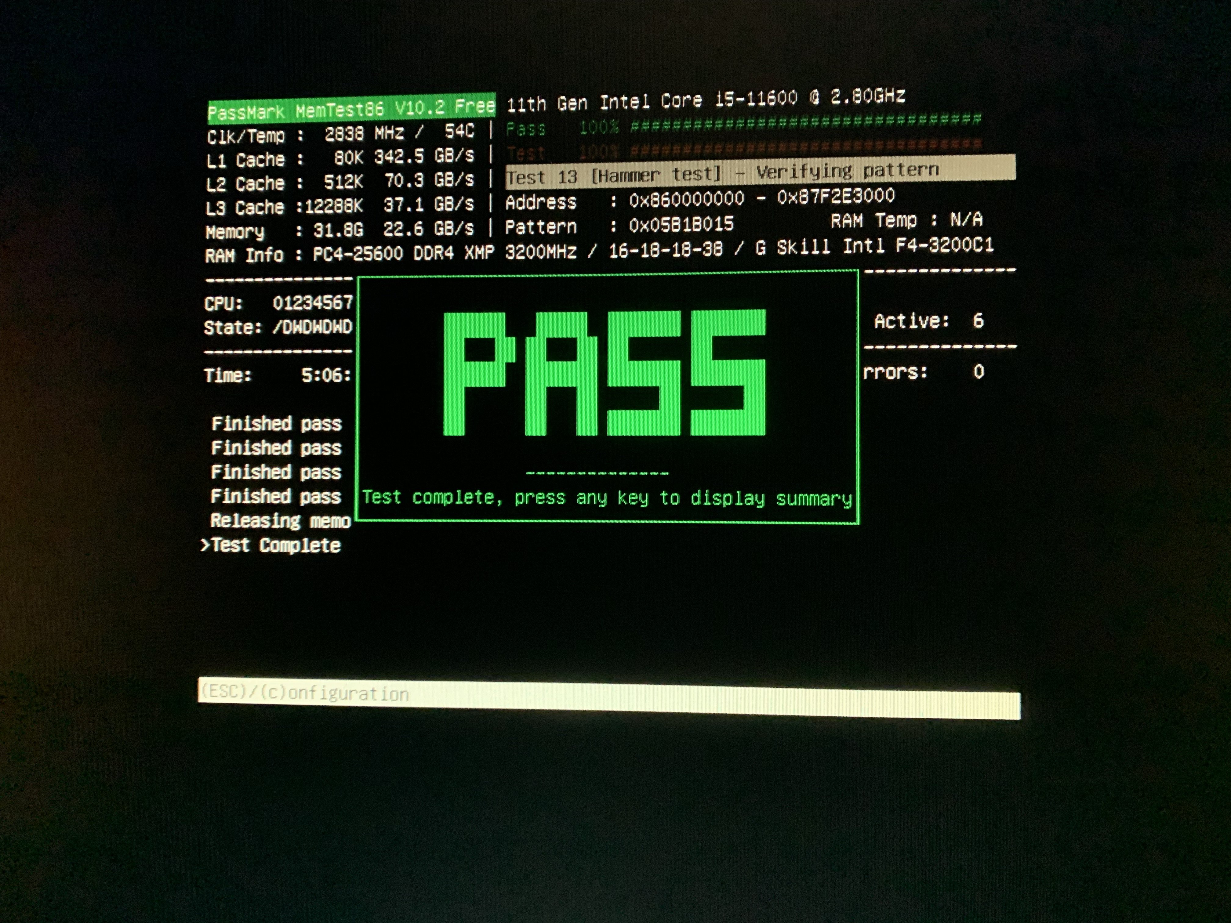

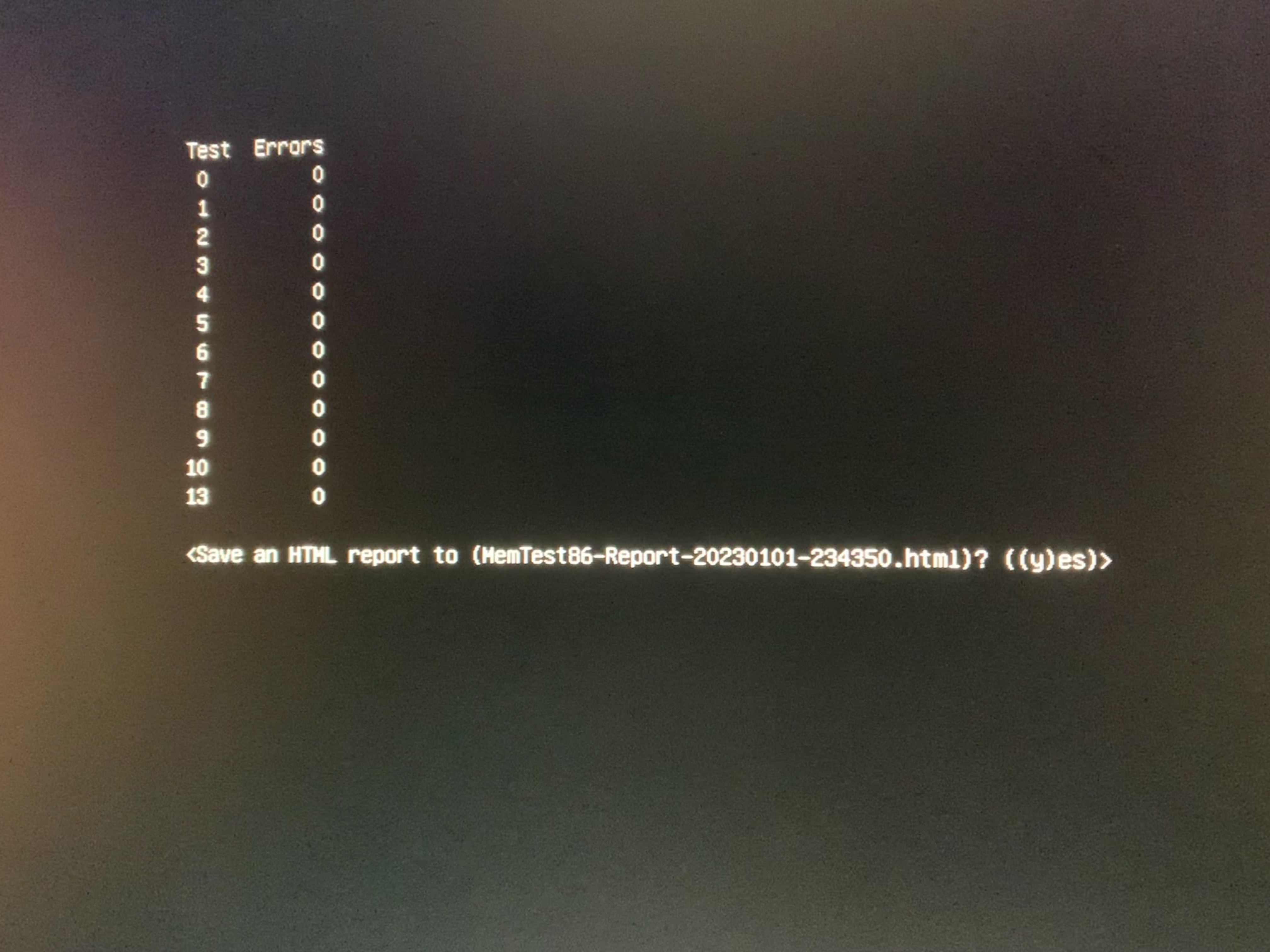

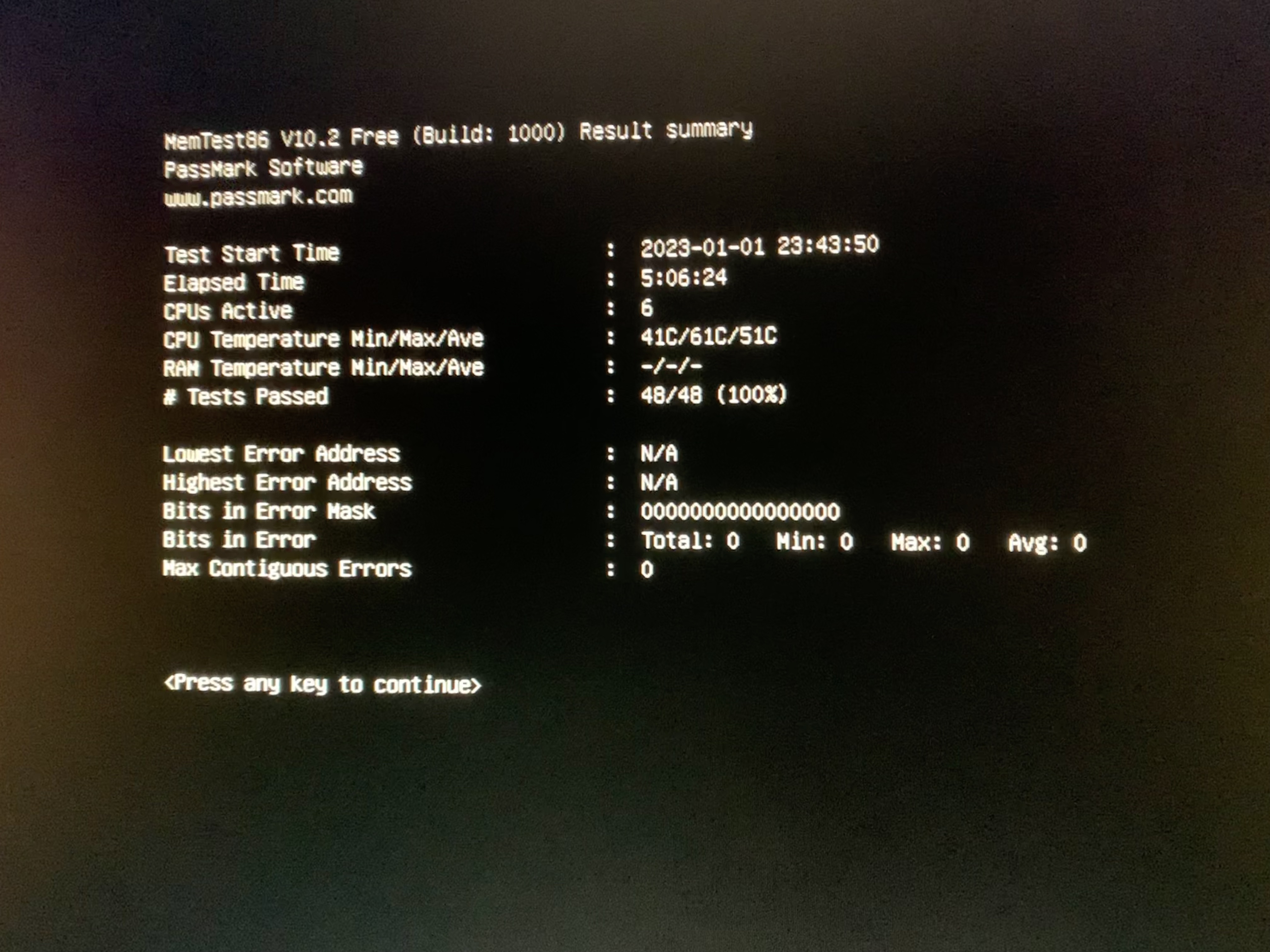

Did a Memtest86 last night actually, just prior to this reboot of the server and prior to this error presenting itself. Showed no faults at all. Ran 4 passes.
IMG_7129.thumb.jpeg.9320ee33d9567ee319a37cc8c29f3e3f.jpegIMG_7130.thumb.jpeg.33e9ed854f1c416d7ec0874f6dd439cc.jpegIMG_7131.thumb.jpeg.0def50545e2c424c66517c3e63a58da3.jpeg
The thing is that I've been troubleshooting my Plex install for the last month now. That is why I did the Memtest.

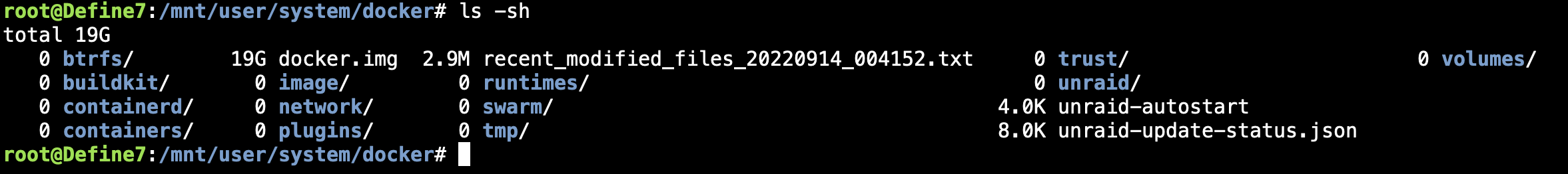

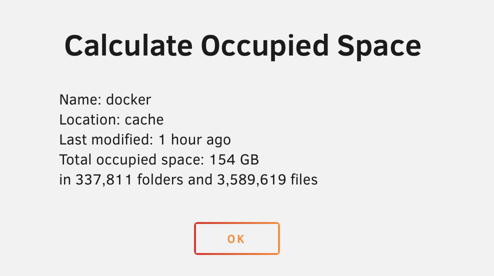

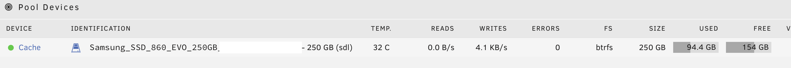

What I don't understand though is why the size of the /docker directory is so different depending on where I look:
/mnt/user/system/docker is set to cache:prefer and is on a 250 GB SSD.
69759719_Skrmavbild2023-01-03kl_00_49_45.thumb.png.d9aba1fcad5828157c4a856bed6fc623.png
Checking it's size in Terminal.
72386596_Skrmavbild2023-01-03kl_00_43_37.thumb.png.1a085f3da70ca84b22b75cbbbe53ee99.png
Calculating /mnt/cache/system/docker in Unraid UI.
Something doesn't add up?!?

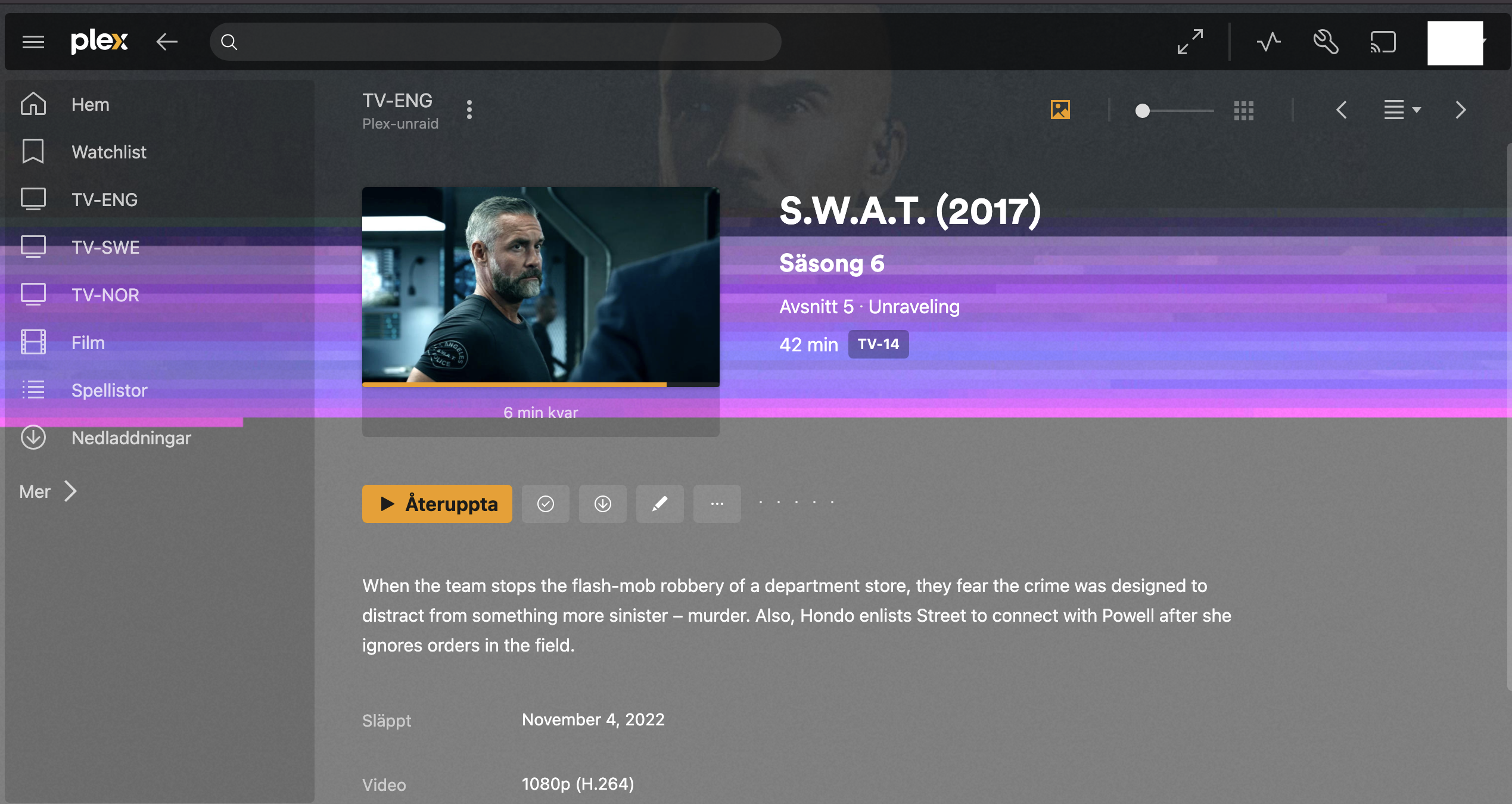

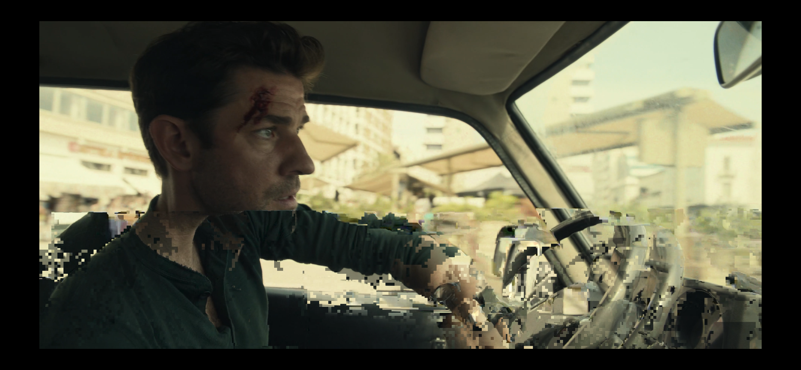

This is the Plex.app on my Mac. This sort of graphical errors I also get from time to time. I’d say exclusively on the artworks, posters and backgrounds like in this screenshot. Since that’s stored on the server in the appdata library, there must be either something corrupting the file when it’s transferred over the network to the Mac (or any other device I have, all present the same intermittent issues) or some sort of file corruption on the cache that is intermittent?! I really don’t get it...
59659407_Skrmavbild2023-01-09kl_07_52_00.thumb.png.90608222ffdb5adb8c352bbd89db81b4.png
Please help! I’m loosing faith here!

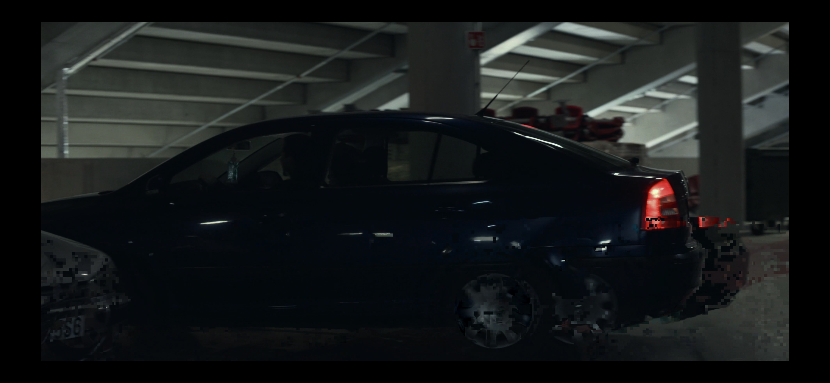

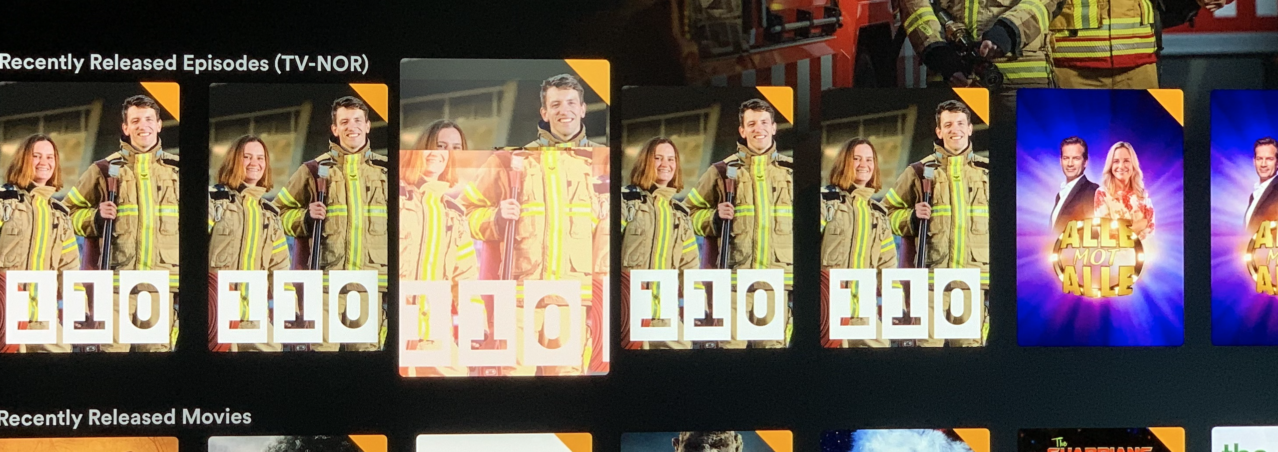

Originally my "only" problem was these weird streaming issues with glitches/freezings/pixelations/errors and artwork being displayed with artifacts in Plex UI. Like this:
135949094_Skrmavbild2023-01-10kl_15_26_30.thumb.png.434e606f9967ca943d7707a6c42db0f7.png983747264_Skrmavbild2023-01-09kl_07_52_00.thumb.png.e4a9038110ae54766809923da7cbf903.pngIMG_7033.thumb.PNG.69e9e19196df3c7432fa35deef9c88df.PNGIMG_7032.thumb.PNG.866fa375edbde7bc9484e0792b1a1b1a.PNG
