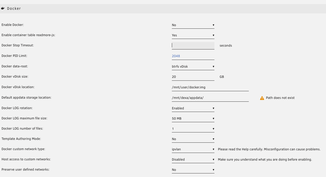

Having similar issue on first time installation>>
Docker Failed to start error
In Docker settings it shows the error :
Default appdata storage location: "Path does not exist"
Path is /mnt/user/appdata
Docker LOG rotation:
 Enabled
Docker LOG maximum file size:
50
Docker LOG number of files:
 1
Template Authoring Mode:
 No
Docker custom network type:
 ipvlan
Host access to custom networks:
 Disabled
Preserve user defined networks:
 No
