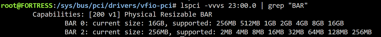

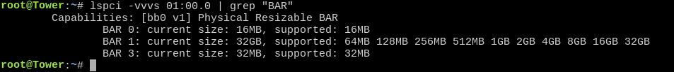

You will need to determine that yourself, using the provided scales in the script they are written out, but essentially you need to pick one that your card memory fits in (and is supported). You haven't stated if your Arc A770 is 8GB or 16GB so I would suggest starting there for a hint. You can also try listing the compatible Bar sizes with with this command:
lspci -vvvs {YOUR_GPU_ID_HERE} | grep "BAR"
You should see something like this:
root@unraid1:~# lspci -vvvs 0b:00.0 | grep "BAR"
        Capabilities: [bb0 v1] Physical Resizable BAR
                BAR 0: current size: 16MB, supported: 16MB
                BAR 1: current size: 32GB, supported: 64MB 128MB 256MB 512MB 1GB 2GB 4GB 8GB 16GB 32GB
                BAR 3: current size: 32MB, supported: 32MB

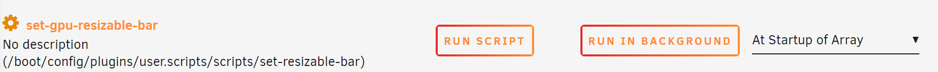

I might be wrong, but I don't think you need to unbind it.
That is what the script is for, I believe, running at Array Startup.

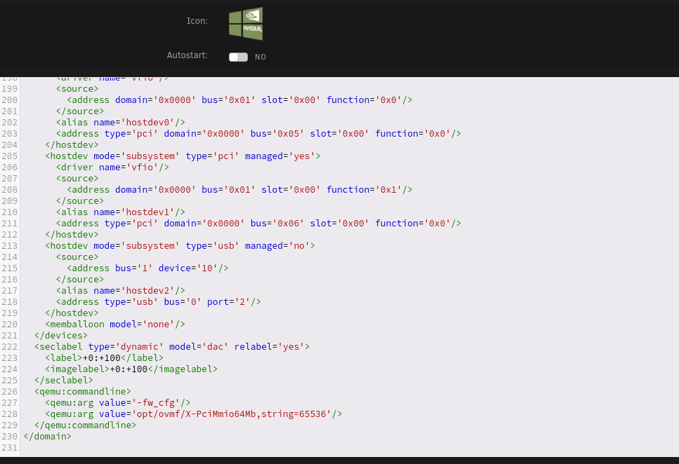

21 hours ago, jonathanselye said:
and i only have </devices> line, is that the same?
I'm not sure what you mean, if you have </devices> then you will certainly have <devices> somewhere, or you've got bigger problems.
Follow the instructions, and read your XML config carefully, line by line. Read upwards from each line beginning to find the opening <devices>.

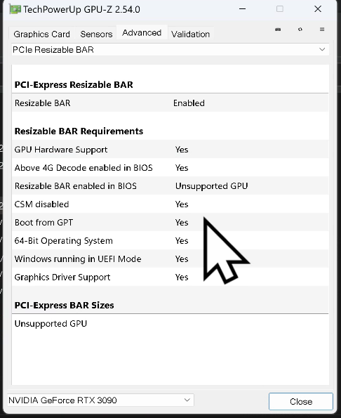

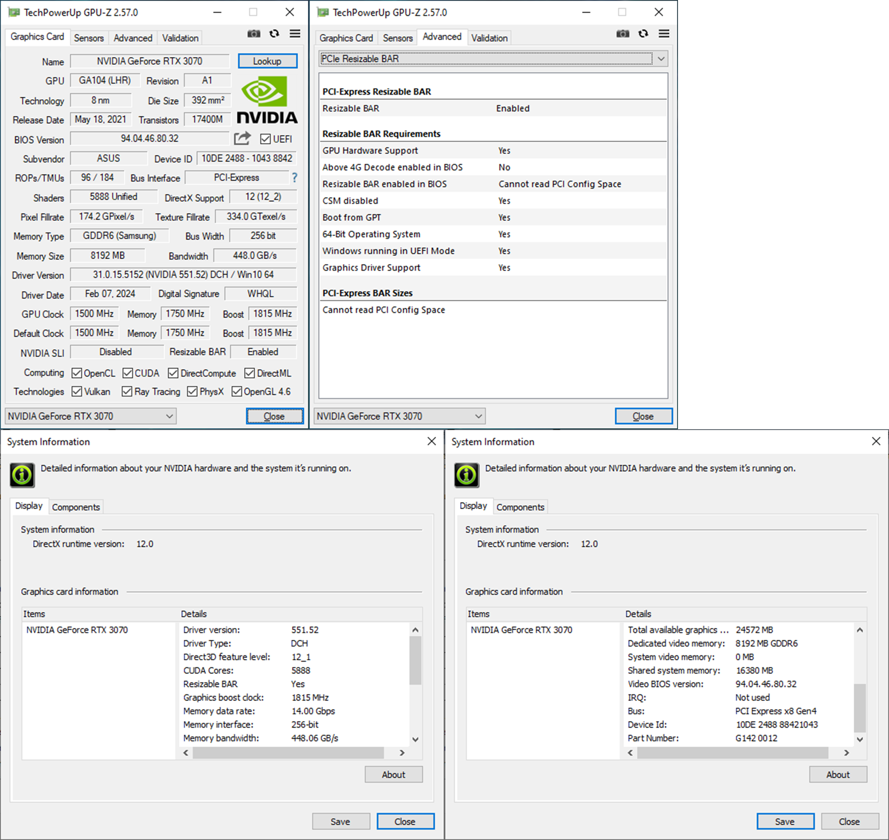

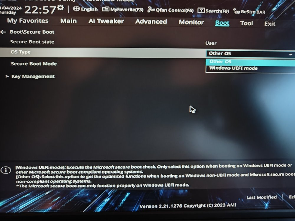

On 2/2/2023 at 11:52 AM, Trozmagon said:
Just a heads up, the custom kernel wasn't necessary for me with my RTX 3090, just adding the additional xml to my VM config was enough.

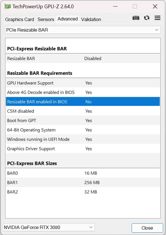

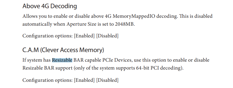

ok what did i do wrong? its enabled in bios. asrock calls it Clever access memory. it is on in the bios. the xml is edited. everything is on. i ran the user script.... and the vbios is up to date for the 3090..
Screenshot 2023-08-09 00.12.33.png@KptnKMan it works in bare metal..but i just can't get it to work in the VM.
Edited by letrain
update

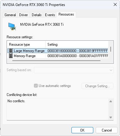

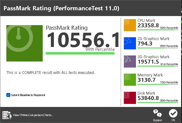

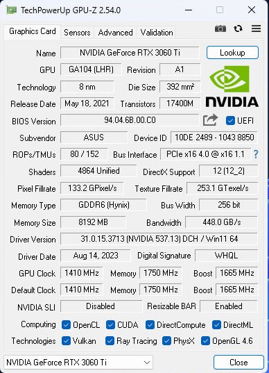

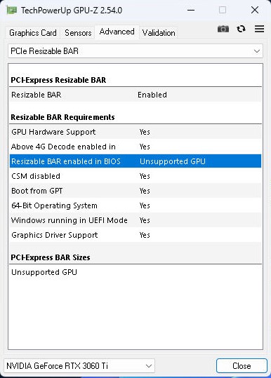

I have been tinkering with ReBAR and general performance in a W11 Gaming VM.
Hardware is i7-12700K, Asus PRIME Z690M-PLUS D4 and Asus RTX 3060 Ti Dual Mini v2. The GPU does support ReBAR.
The VM has 12 CPUs and 32 GB RAM allocated. Samsung 990 Pro is passed through as the only disk.
The VM is working fine. Not great, but fine. I say fine because it's a hugh step down from bare metal in regard of benchmarks. A little overhead is expected though.
I have followed this and other threads and I think I have done everything correctly.
974605851_GPU-ZGPU.jpg.49f68a8a14115dfc1d76d7f85be0f54b.jpg1298058633_GPU-ZAdvanced.jpg.fae572562e9c6a2346e0897a27707b14.jpg
GPU-Z shows that ReBAR is enabled... but that the GPU is unsupported. The VM in installed on a NVMe so when booting bare metal the all is good; the GPU is supported.
Looking in the Device Manager, Large Memory Range is there. I have to admit that I have not yet tried the user script...
This is my results from PerformanceTest.
Best regards
J

I updated from 6.12.3 to 6.12.4-rc19 today and now I have the resource1_resize folder. Ran the script, but I still have "Unsupported GPU" in GPU-Z.
A bonus is that I have seen a 13% increase for both 2D and 3D when running PassMark PerformanceTest after the update.

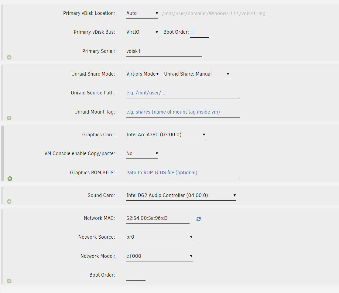

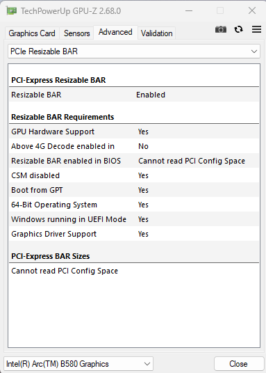

Hi !

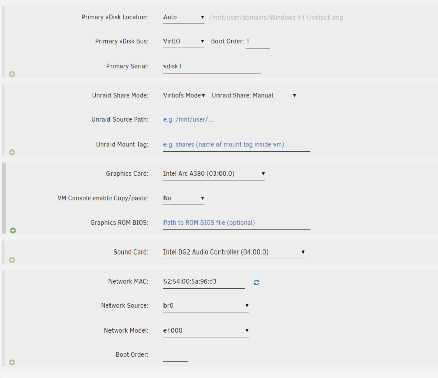

Stuck with this although I followed steps provided earlier :
Config :
Intel Arc 380
Unraid 6.12.3 here, with @thor2002ro's 6.2 kernel
Machine: Q35-7.1
BIOS : OVMF-TPM
Followed the following steps :
- Host BIOS Enable ReBAR support
- Host BIOS Enable 4G Decoding
- Enable & Boot Custom Kernel syslinux configuration (near beginning of this thread) apparently not needed anymore
- VM must have the top line of XML from <domain type='kvm'> to:
<domain type='kvm' xmlns:qemu='http://libvirt.org/schemas/domain/qemu/1.0'>
- VM must have added the following (after the </device> line, before the </domain> line):
  <qemu:commandline>
    <qemu:arg value='-fw_cfg'/>
    <qemu:arg value='opt/ovmf/X-PciMmio64Mb,string=65536'/>
  </qemu:commandline>
Only steps I'm unsure are the following :
- Boot Unraid in UEFI Mode
- VM must use UEFI BIOS
Pretty sure it's a yes, but how can I be sure of it ?
Attached some screenshots of config+ BIOS config + VM XML here : https://pastebin.com/6Re8fs6Z
Any clue ?
Thanks for your help!

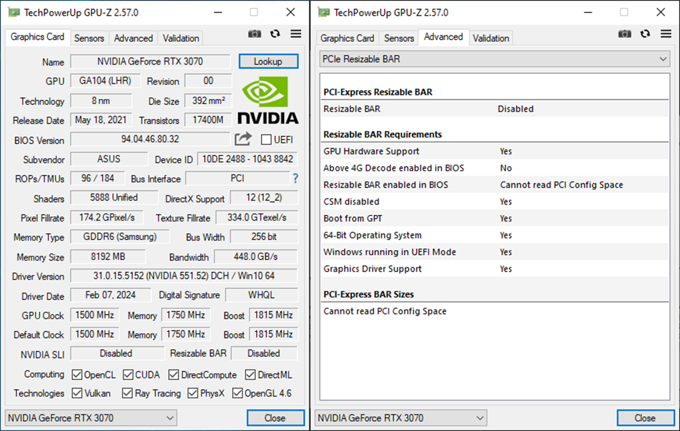

With the Unraid 6.12 series on Linux kernel 6.1 natively, I decided to finally revisit this topic with my update to 6.12.8.
After the OS update, I checked the lspci output to see if the OS was correctly assigning the correct memory size allocation for my ASUS KO GeForce RTX 3070 V2 OC Edition 8GB. I was pleasantly surprised that without doing anything, it was assigning the resource space to the maximum video memory allotment my card is able to provide (i.e. 8GB) (see full lspci output at bottom of this post).
# lspci -vvvs 0c:00.0
0c:00.0 VGA compatible controller: NVIDIA Corporation GA104 [GeForce RTX 3070 Lite Hash Rate] (rev a1) (prog-if 00 [VGA controller])
        Subsystem: ASUSTeK Computer Inc. GA104 [GeForce RTX 3070 Lite Hash Rate]
                BAR 1: current size: 8GB, supported: 64MB 128MB 256MB 512MB 1GB 2GB 4GB 8GB
Note the BAR 1 size is set to 8GB. Before the kernel update (and with the kernel patch referenced in the earlier pages of this thread), it was set to a default of 256MB. All is looking good so far!
I followed the these baseline steps
✅ Host BIOS UEFI w/o CSM
✅ Host BIOS Enable ReBAR support
✅ Host BIOS Enable 4G Decoding
⬛ Enable & Boot Custom Kernel syslinux configuration (near beginning of this thread) not needed anymore
Before modifying my Windows 10 Pro VM configuration, I booted up the VM to see if anything was needed for the Guest OS to recognize ReBAR. I did make sure my guest bios was set to OVMF TPM (regular OVMF provided the same result as shown below though). Windows booted without issue and I ran both GPU-Z 2.57.0 and the NVIDIA Control Panel to check ReBAR support:
This is what I saw:
GPU-Z reported ReBAR as Enabled, but when I went into the Advanced settings, 4G Decode was shown as Disabled in BIOS. NVIDIA Control Panel shows ReBAR an Enabled and shows it's correctly allocating 8GB of dedicated video memory with an additional 16GB of shared memory for 24GB total. If I close the apps and relaunch them, GPU-Z reports differently, showing ReBAR as Disabled with the same advanced details (NVIDIA Control Panel stays reporting ReBAR Enabled with the same details).
 I shut down the VM and tried the XML edits noted in this thread and other online spaces talking about VFIO ReBAR:
<domain type='kvm'> ➡️ <domain type='kvm' xmlns:qemu='http://libvirt.org/schemas/domain/qemu/1.0'>
  <qemu:commandline>
  </qemu:commandline>
After relaunching the VM, I found the results to be the same. So, this is interesting in that the XML may not be required for ReBAR anymore either. However, since I'm getting inconsistent reporting using GPU-Z and the NVIDIA Control Panel, I can't be sure.
I think I trust NVIDIA Control Panel more than GPU-Z on this one even though GPU-Z has never steered me wrong in the past. I figure the hardware vendors driver information software probably knows better and GPU-Z is looking at some inconsistent information and reporting incorrectly. But, I think putting a synthetic benchmark to test Host BIOS setting differences is probably called for in this scenario (ReBar and 4G Decoding On vs Off). I'll report some of that in a follow-up post.
Anyone else see something similar to what I'm seeing and have verified ReBAR functional in their VM?
-JesterEE

I have see the same thing.
GPU-Z shows that Resizable BAR is enabled, even though "Resizable BAR enabled in BIOS" shows Unsupported GPU.
Nvidia shows that Resizable BAR is enabled with 8192 MB GDDR6 dedicated video memory and 24572 MB total available graphics memory.
Does ReBAR work? Not sure, and I'm not sure how to confirm it in-game.

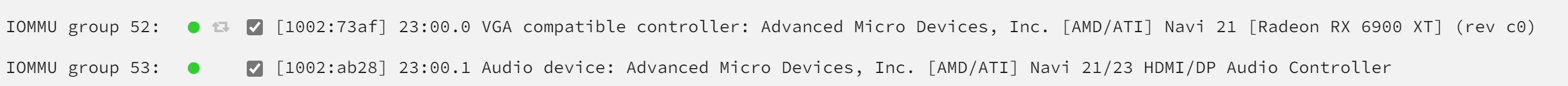

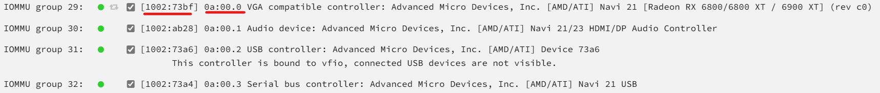

Hi Guys -  I have been trying to enable resizable bar in a windows vm with and AMD 6900XT GPU. Has anyone actually managed to get resizable bar working for AMD GPUs in Unraid, or is it a case of it only works with nVidia GPUs?
I have rebar enabled in bios as well as above 4g decoding. Have the array start script to set the resizable bar to 16GB which this card is capable of. Have also made the extra xml changes to the  vm definition.
I see no errors when the script runs, and the systems starts to boot but when it tries to load the video driver, the screen goes black and turns off.
I haven't seen any posts so far with AMD card working - so was wondering if I am wasting my time or if indeed its possible to get an AMD card to work with REBAR enabled in unraid?
if i turn rebar off in bios, vm boots normally and windows loads without issue.

User Script:
#!/bin/bash
#echo -n "0000:23:00.0" > /sys/bus/pci/drivers/vfio-pci/unbind
#echo 14 > /sys/bus/pci/devices/0000\:23\:00.0/resource0_resize
#echo -n "1002 73af" > /sys/bus/pci/drivers/vfio-pci/new_id || echo -n "0000:23:00.0" > /sys/bus/pci/drivers/vfio-pci/bind

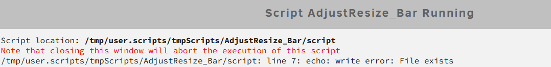

If I tried to use resource1_resize, i would get an error that file already exists.
VGA PCI
Any thoughts on what I might be doing wrong?
Cheers
Rod.
Hi Guys, quick update - Just for sh!ts and giggles, I turned off REBAR in BIOS, and I adjusted the REBAR size from 16GB to 8GB in the script and the VM now launches and shows the large memory addressing in the GPU. So even though the card is capable of 16GB REBAR size, the VM didn't like it. Moved it to the next one down, and it worked. Here is the updated user script.
#!/bin/bash
echo 13 > /sys/bus/pci/devices/0000\:23\:00.0/resource0_resize
Remember to adjust the id's and addresses based on your system configuration.
Hope this helps some others - it absolutely works with AMD cards and works very well. Buttery smooth with REBAR enabled. I did some testing with Tiny Tinas Wonderlands on the Video benchmarking and that no longer stutters, whereas before it would stutter quite a bit.
Cheers
Rod.
UPDATE - I just realised the script was commented out - updated accordingly, and gave myself an upper cut while at it.
UPDATE 2 - I was able to get the full 16GB REBAR enabled and the machine is working fine.
So using the script above, as well as in my case disabling REBAR In Bios solved the issue and the its working nicely. Your mileage may vary. :)
Edited by Noggers

  • For the user script that creates the resizebar resource (in this guide below) i get the following error
    Not sure why when rebinding the device its saying it exist despite it being unbound in the beginning. If anyone can shed some like on this will be appreciated and I will update this post

In the UNRAID WebUI you will need to ensure that you have bound the gfx card to vfio so that unraid doesnt reserve it preventing the card from being used. (I am using UNRAID 6.12.10) To do this:
  1. Goto Tools > System Devices
  2. Check all the PCI devices that are you graphics card. Not a Graphics card can be listed as multiple devices, In the example below the 6900XT has 4 devices
In the pic above I have highlighted two things that you will need to note for later
- GPU Address ( thats the 0a:00.0)
- GPU ID ( thats the 1002:73bf)
Yours will be different to the ones I have listed so make sure to note your down.
Additionally note i ticked serval devices that all share the same address space of 0a:00.x, x being .0 /1 /2/3. For your setup make sure you have ticked all other devices in the same address space. Youll notice the descriptions will also loosely correlate.
When done scroll to the bottom and click "BIND SELECTED DEVICES TO VFIO AT BOOT", you will then need to reboot the server before continuing.

  3. Open up user scripts
  4. Create a new User Script and schedule it to run on array start.
  5. Add the following script, take note that you will need to alter the GPU, GPU_ID and VRAM for the card your passing through. As the beginning of this post these were the values we noted down.

  7. To check if the script applied the setting you can lspci -vvvs  GPU (eg 0a:00.0) | grep "BAR"
    Importantly for AMD card BAR2 is 8MB, for me it was defaulting to 265MB and this stops windows from booting.

  9. switch to XML View. At the top, line 2 you will need to edit <domain type='kvm'> to be
  10. Scroll to the bottom of the XML code and above where it says </domain> insert:
      <qemu:commandline>
      </qemu:commandline>

  12. Boot the VM (make sure a Monitor is connected to the passthrough GPU), you should see Windows boot up to the desktop
  13. Download GPU-Z, run it and on the main screen ResizeBAR should say enabled. or check the GPU in device manager and you see large memory allocation
NOTES
For the AMD card I have both Device Manager and GPU-Z say resize bar is enabled. However in the AMD Driver under Smart Technology I am seeing Smart Access Memory as unsupported. Not sure if this a quirk or something else. but if anyone knows let me know.

I have Zotac RTX 4070 Super with 12 GB of VRAM.
UR sets BAR 1 to 16GB.
1298058633_GPU-ZAdvanced.jpg.fae572562e9c6a2346e0897a27707b14.jpg.dc5cb4f21717979e52aefa78091c37a8.jpg
And I think that is the reason ReBar fails.
Do you know if it is possible to set it to 12 GB of VRAM?
Best regards
With the new version, v7.0.0 Beta 1, GPU-Z shows that ReBar is enabled. :)
