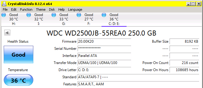

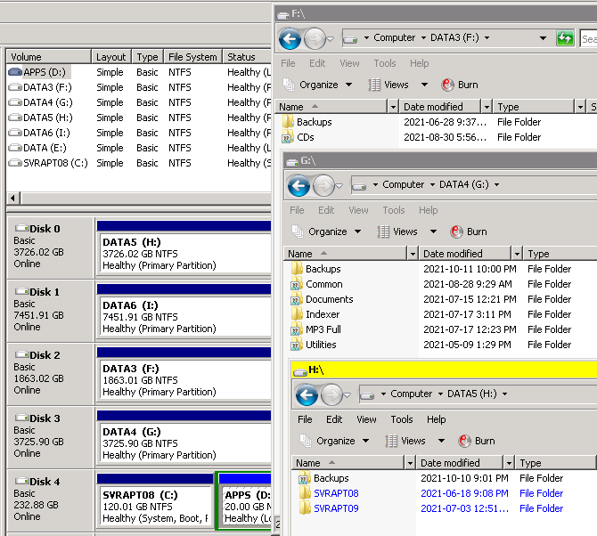

Back in the day I would have a Windows machine with a hard drive (C drive) and then when that got full I would buy another hard drive (D drive).  Eventually the machine would have three or four hard drives (or more) but each drive was independent and could fail.  The screenshot below is an example of this machine that I still have (it's an old machine as you can see from the number of hours that the C drive has been active).  You shouldn't do it this way anymore.  Now, with unRAID, all those hard drives are seen as one big drive (from a file system point of view).  If one drive fails then you can buy a new drive and replace it without losing the data on that drive.
