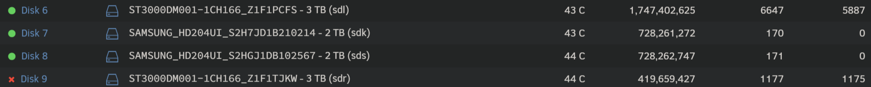

[6.11.5] Disk 9 disabled after 1175 errors
Need some assistance please.

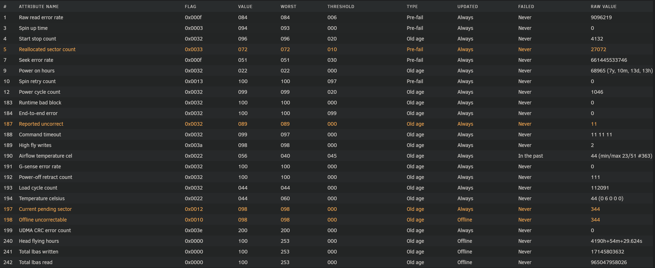

Disk 9 has been disabled after 1175 read and write errors.
SMART not looking good.

Disk appears to be failing, you can run an extended SMART test to confirm, if it fails replace it.

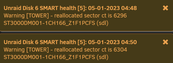

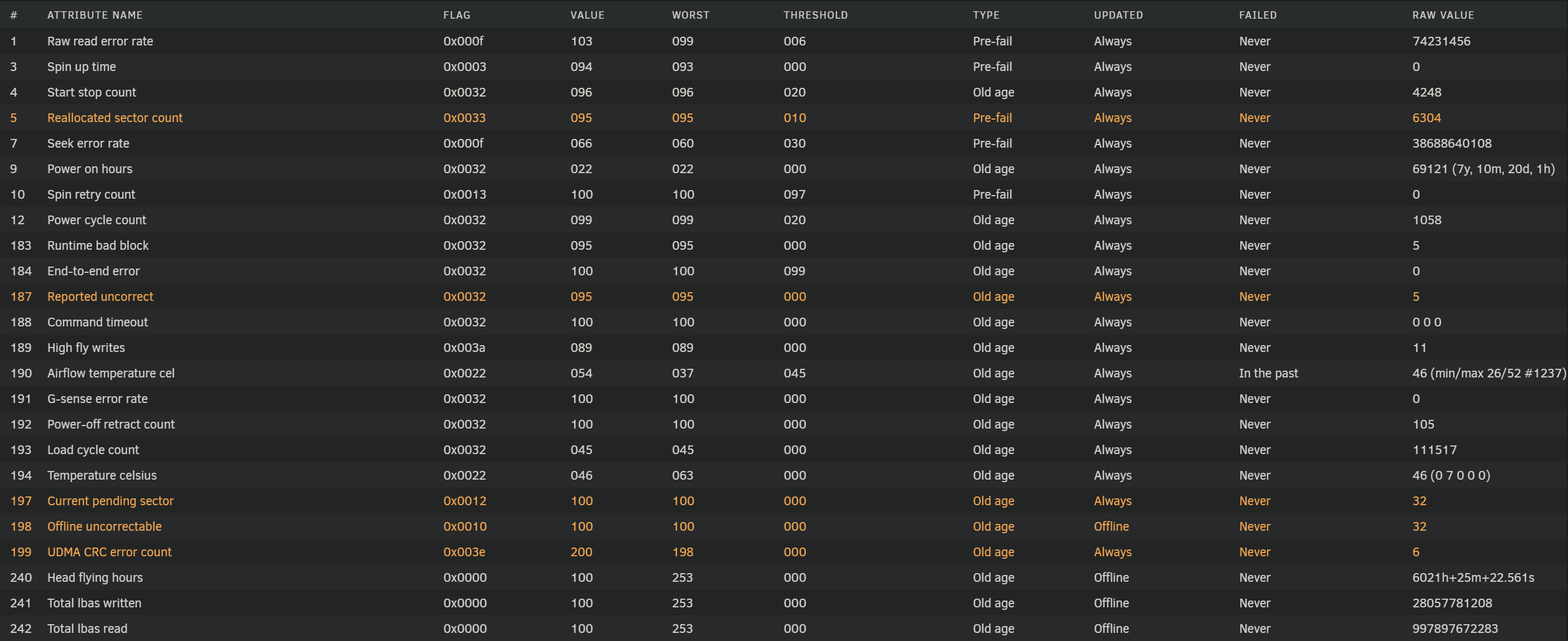

itimpi just realised I had notices and warnings disabled and just had notifications for OS updates and alerts. I've enabled them now and worryingly it looks like disk 6 is also having issues with reallocated sectors.
I'm currently running rsync -avPX /mnt/disk9/ /mnt/disk1/ to do New Config to remove disk 9 as I've got space on disk 1 for now, but worried about doing that in case disk 6 fails and would leave me without parity to rebuild it.

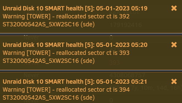

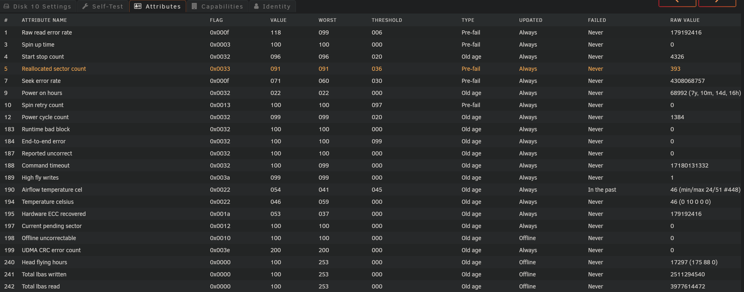

Disk 10 now too:
Currently up to 592 reallocated sectors 30 minutes later.

Disk 10 now on 760 reallocated sectors. Disk 6 hasn't increased from 6304.

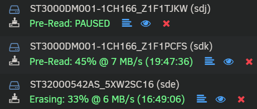

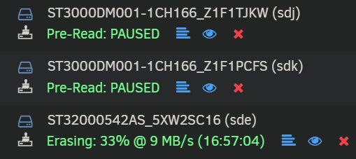

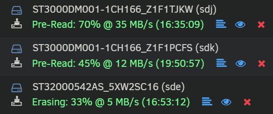

Currently trying to erase and clear them to dispose of, but 2 of them are taking a very long time due to the errors and keep pausing temporarily. Top one says 35MB/s but only does that for a few seconds before pausing for a while.
Is it worth skipping the pre and post read on them, or is it recommended to leave them all to finish normally?
The bottom disk is erasing at a really slow speed. Guess there's nothing I can do about that.
