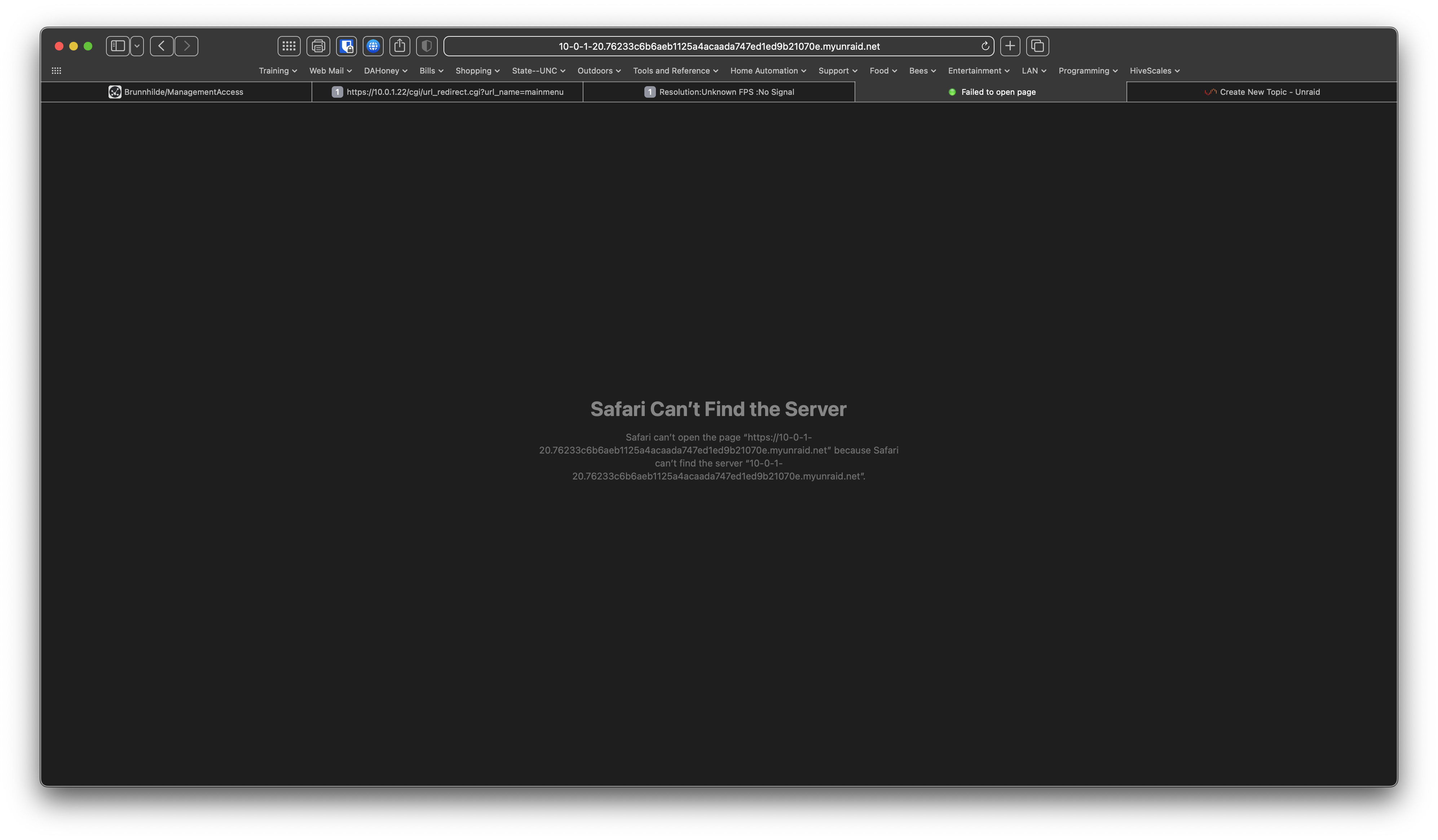

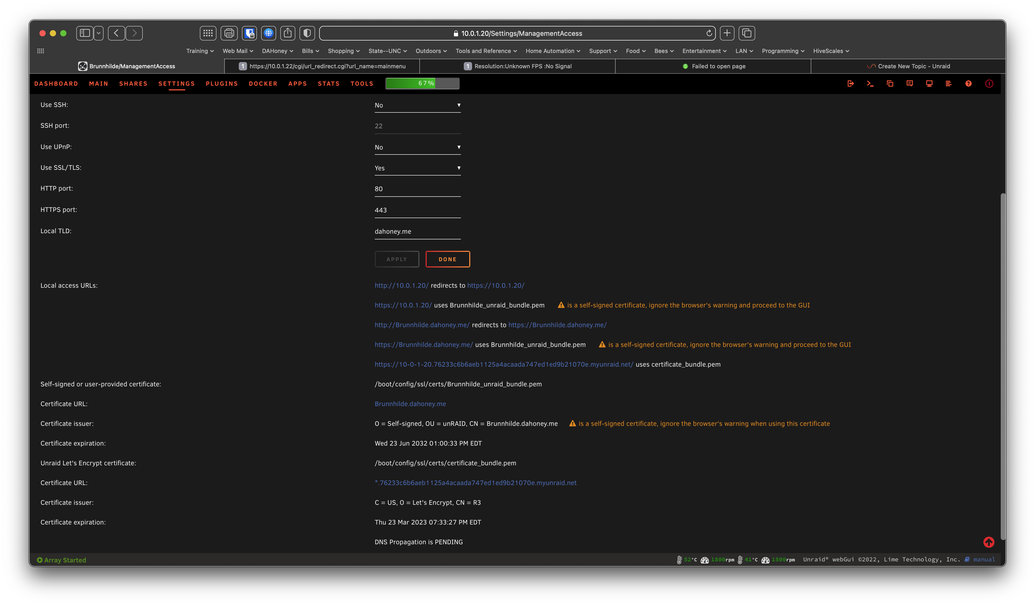

I can access my servers webui if i use just the IP (https://10.0.1.20) but if i use the unraid LE IP I just get “server can't be found”.

I was having an issue where all info was missing from the main tab so decided to reboot. Now there seems to be an issue with SSL. Diagnostics attached.

If I follow those steps it uses my self-signed ssl certificate rather than the LE certificate. Is that expected behavior?
Yes. The LE certificate is only valid for myunraid.net urls, if using a different url then it uses a self-signed cert.
