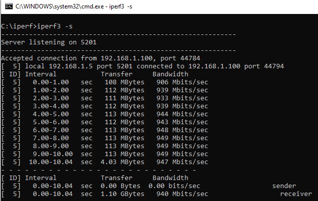

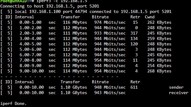

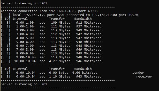

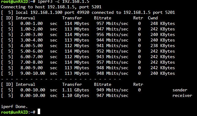

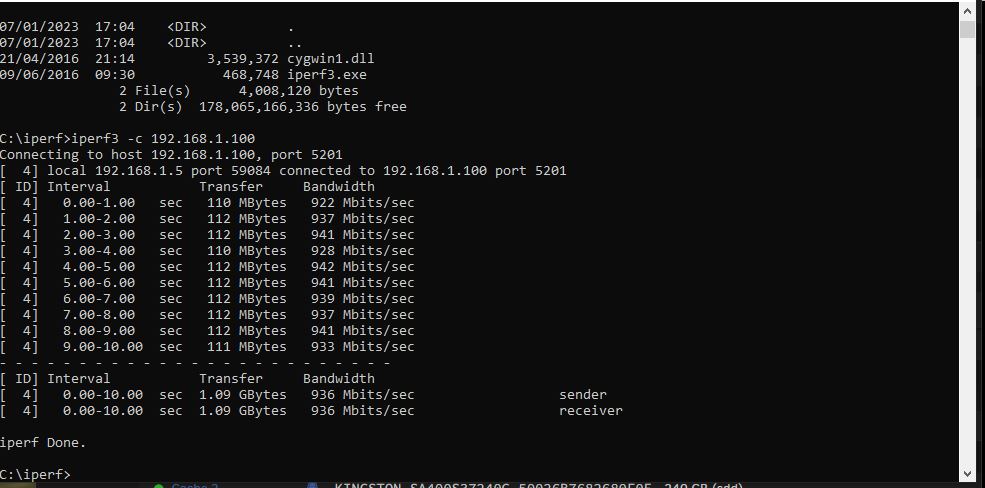

January 4, 20233 yr I know there are several posts on here about this, and a few appear to have solutions, but none of those apply to my situation. I used to be able to max my 1Gbps network connection when copying from my Windows 10 machine over SMB to unRAID. It would max out at ~ 110MB/s. Now it will max at a consistent half of that - about 52MB/s. I don't know when it first happened, but I'm guessing it's been slow for about 6 months or so. Don't want to spam this thread with screenshots (so I've added them as an archive). I've tested: Windows to unRAID using iPerf with both tested as client and server. Results are > 930Mb/s Benchmarks of the drives and controller (LSI 9211-8i). Spinners and SSDs. The slowest drive is around 100MB/s at its slowest point. Windows to Windows machine on the same network ~ 110MB/s. SSD on both ends. Tested with cache SSD and direct to array with no change. Tested in safe mode. Tested with all dockers stopped. Played with network settings, turbo write etc, but I can see that the disks and network don't appear to be the bottleneck. I've recently set up Lancache for gaming downloads. Those cache only on an SSD and may contain a lot of small files, but even installing to both machines I am seeing a consistent 75 - 80MB/s. Screens archive also shows that array parity check speed is consistently ~150MB/s average. Test file is 60GB ISO. Attached screens.zip shows the screenshots I took whilst running the tests. Thanks screens.zip unraid-diagnostics-20230104-1924.zip Edited January 4, 20233 yr by nomisco
January 5, 20233 yr Author As I understand, using the iPerf switch -P would have tested with parallel streams. As I didn't use this, I'm assuming that these tests are with a single stream.
January 5, 20233 yr Community Expert There are a lot of retries in one of the directions suggesting a network problem .
January 5, 20233 yr Author 6 hours ago, JorgeB said: There are a lot of retries in one of the directions suggesting a network problem . I don't believe that the number of retries is of concern when the network is being saturated. 1Gb/s can max out at about 80,00+ packets per second and the network was minimally in use elsewhere; skpe, online gaming etc (which would have prioritised packets). I'll subsitiute a segment of the network with a long cable which will byass a couple of switches, but because there's a 50% drop in throughput I don't have much hope for that. Just to add, iPerf shows that the network performance is largely as expected, and I see better when using a different protocol through lancache, so it points to an SMB problem to me. Edited January 5, 20233 yr by nomisco Added additional thought
January 5, 20233 yr Community Expert 19 minutes ago, nomisco said: I don't believe that the number of retries is of concern when the network is being saturated. Might not be, but it's still not normal, usually iperf tests are clean, same as your test in the other direction.

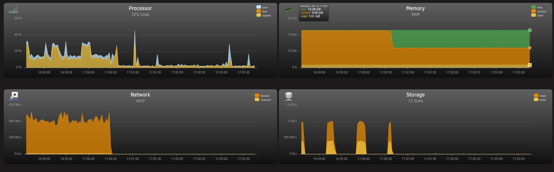

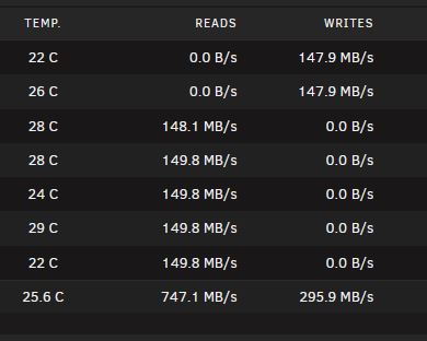

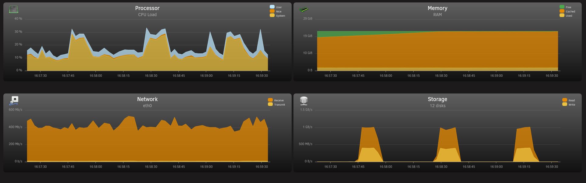

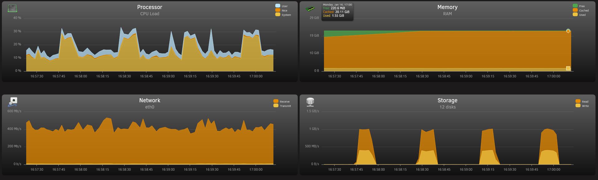

January 16, 20233 yr Author The disk settings are set to reconstruct write. It is writing to the largest available space, which is about 2TB of space on a 4TB disk. The write speed is still ~50MB/s from the client to unraid, but it appears to buffer in the unraid memory, then dump large chunks to disk before waiting for some buffer to fill on unraid, they repeating. Hopefully the below images give you some idea of the behaviour. The disk writes in the top image are to the parity and array disk. Cache disk (SDD) is not used during test. Edited January 16, 20233 yr by nomisco Add information
January 16, 20233 yr Community Expert Could be SMB, but I can write to Unraid at 1GB/s, normally no one has problems getting line speed with SMB over gigabit, could still be network related despite the clean iperf results, I would try two things, using a different NIC if available and/or creating a new Unraid flash drive and restore only the key and disk assignments, in case it's something to to with your Unraid install.

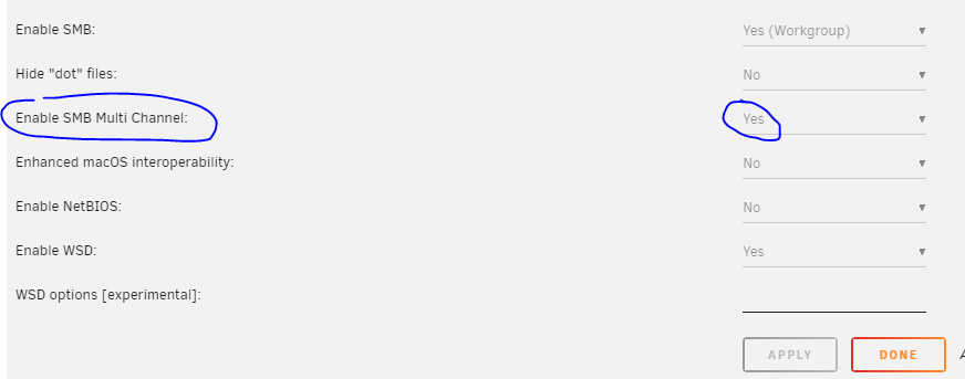

September 18, 20232 yr On 9/5/2023 at 11:53 AM, denishay said: OK. Just to be clearer, it is due to the way SMB is configured/implemented/whatever on Unraid by default. Most of us have not played with those settings. Using anything else than SMB for transfers or any other system than Unraid with SMB all pretty much max out the Gigabit network. That was the whole point of my post above. I guess I didn't make it clearer: if there are better settings to be made, why are they not set by default on new setups? In my specific case, I tried modifying the SMB settings, but only got worse results (15Mb/s or less with Multichannel for ex.). As I said earlier, I have made my peace with that. I don't care and don't really need more. But claims that there are "no problems" with the way Unraid configures SMB by default and trying to have *users*/ go through a complex game of trials and errors is just not right. If "optimal" settings exist, why are they not set by default and/or some warnings issued? You didn't read the comment correctly. @itimpi explained that it's not an issue with SMB itself, but rather how your Unraid system is configured (settings unrelated to SMB): mainly if Turbo Write is enabled or not. In addition to that it's due to how the main array and parity works in Unraid (compared to e.g. RAID) which doesn't really allow for super high write speeds (especially with Turbo Write disabled).
